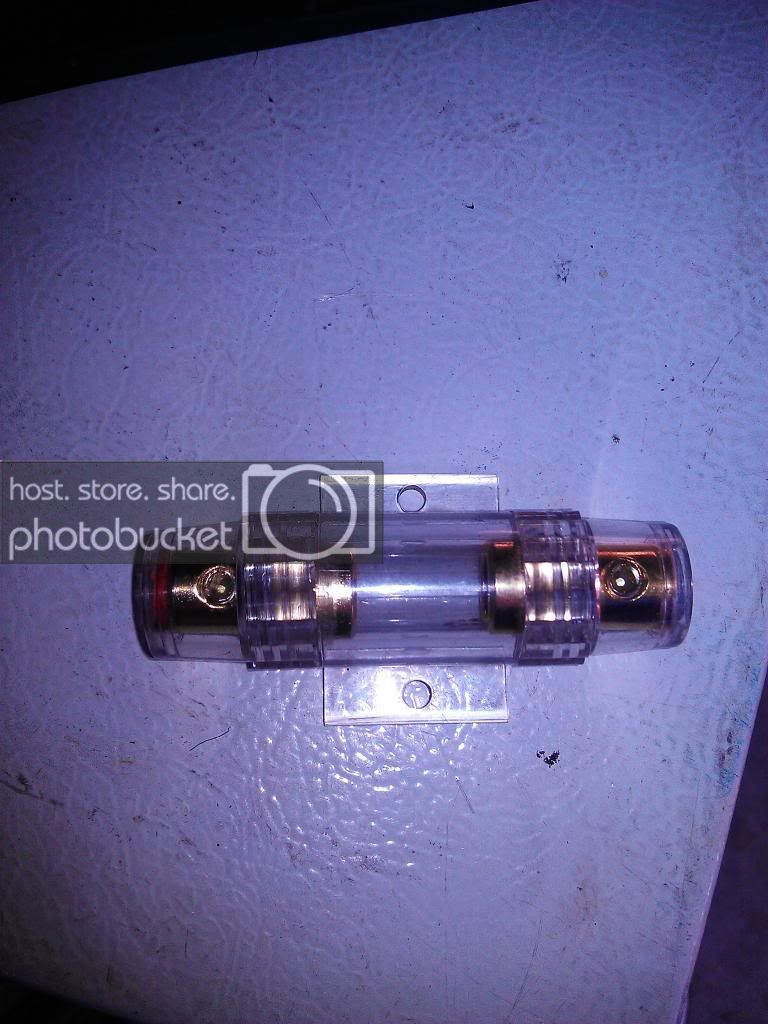

Fuse holder assembled

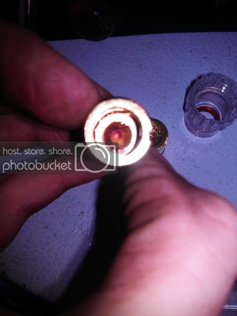

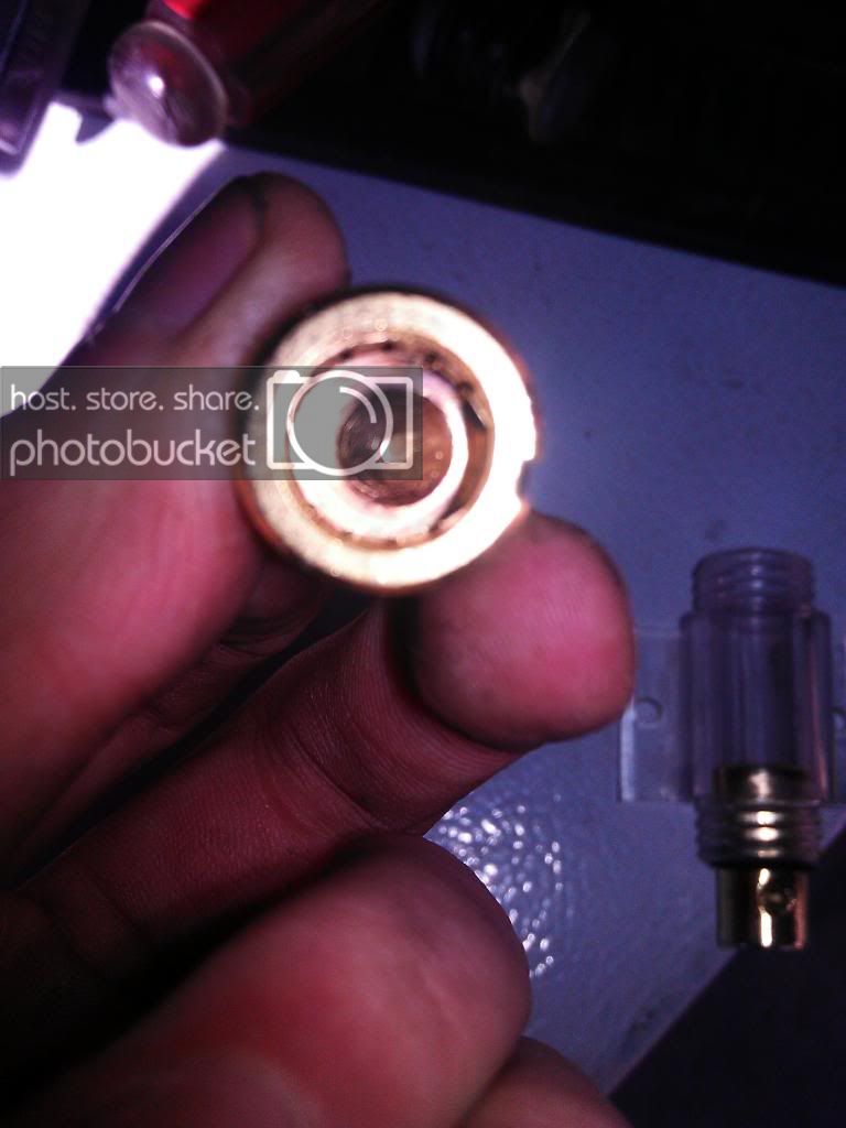

Fuse connector #1 (Coming from power connection)
Appears to have discoloration inside of it (that maroon-ish/purple stuff inside.)

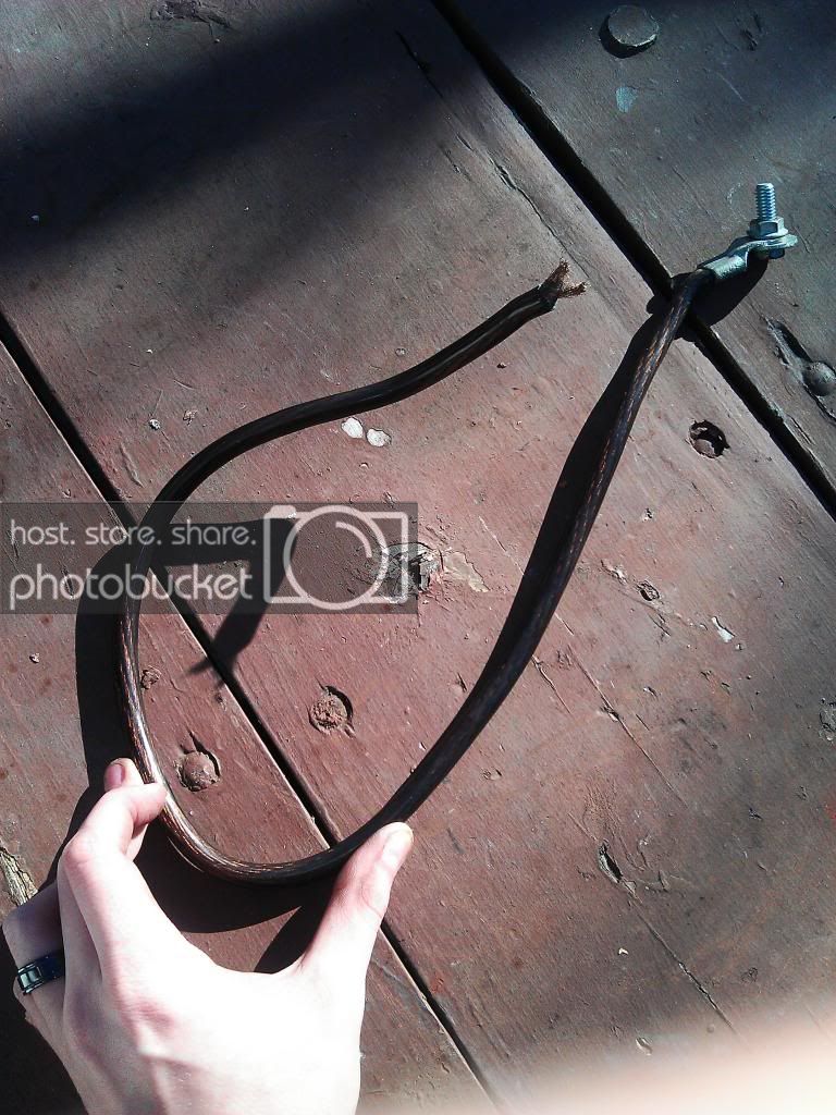

Ground cable! (No discoloration, no cracks/splits/nicks in the shielding.)

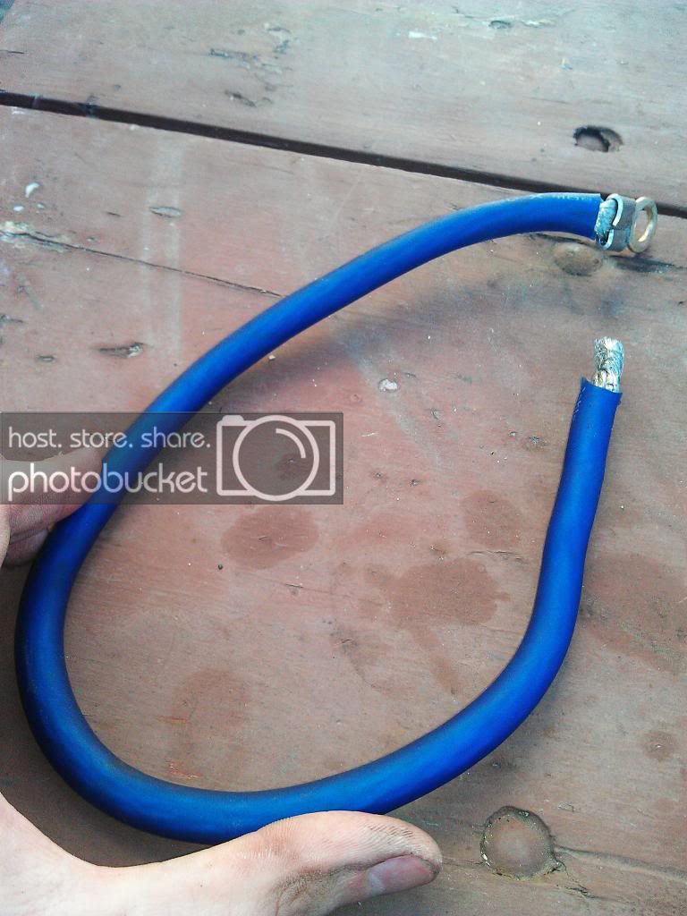

Power connection wire! This wire is "Brand X Soft Rubber 4 GA Primary Wire"
(Where Fuse connector #1 was attached.)

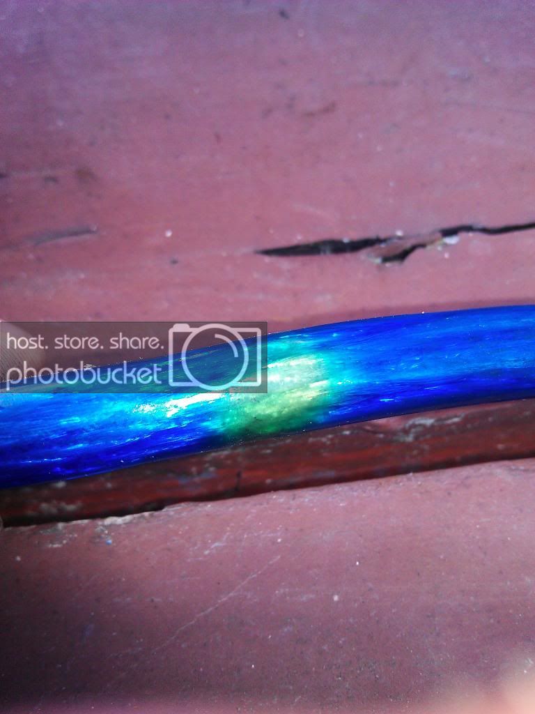

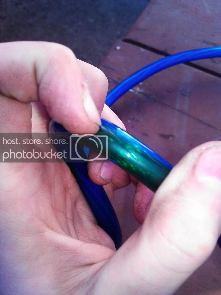

Shows discoloration(My guess is from the tape) and my finger nail is at the beginning of a slit.
Said slit doesn't go deep enough to touch wire from what I can see/feel.

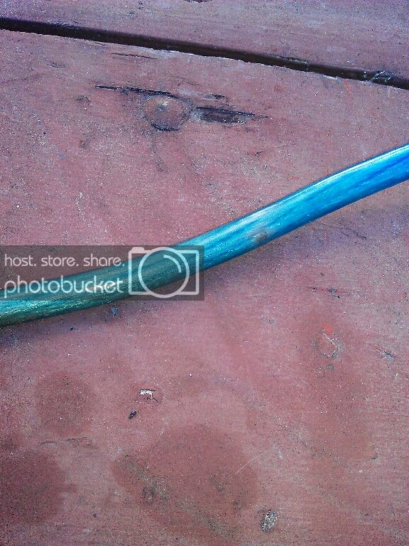

Main power wire

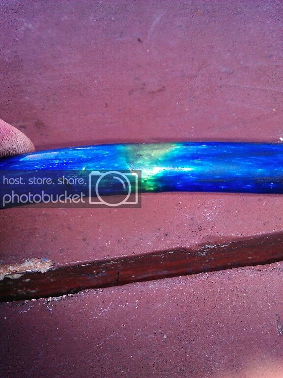

Shown is a slightly discolored area that is hard to see.
(No tape residue to cause the discoloration, seemingly this is discoloration inside the wire.)
Focus on the right end of the wire, then look towards the left.
The right is obviously blue, The middle and left parts appear blue-green-ish to my eye.

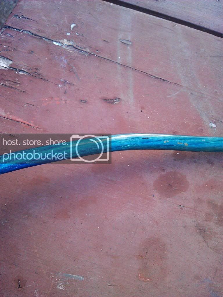

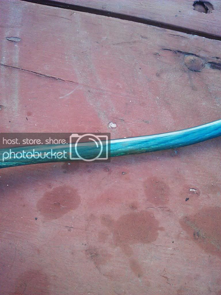

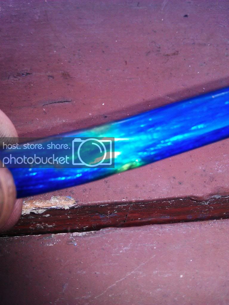

Main power wire
Same spot, moved slightly left.
Showing slight discoloration.

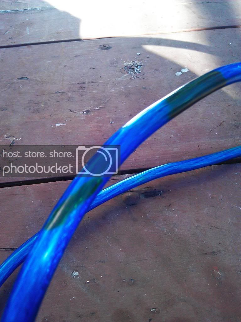

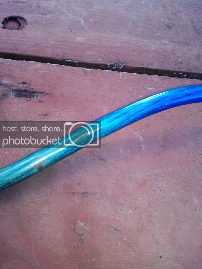

Main power wire
Same spot as above, further left on wire
Captured is a fully discolored section.

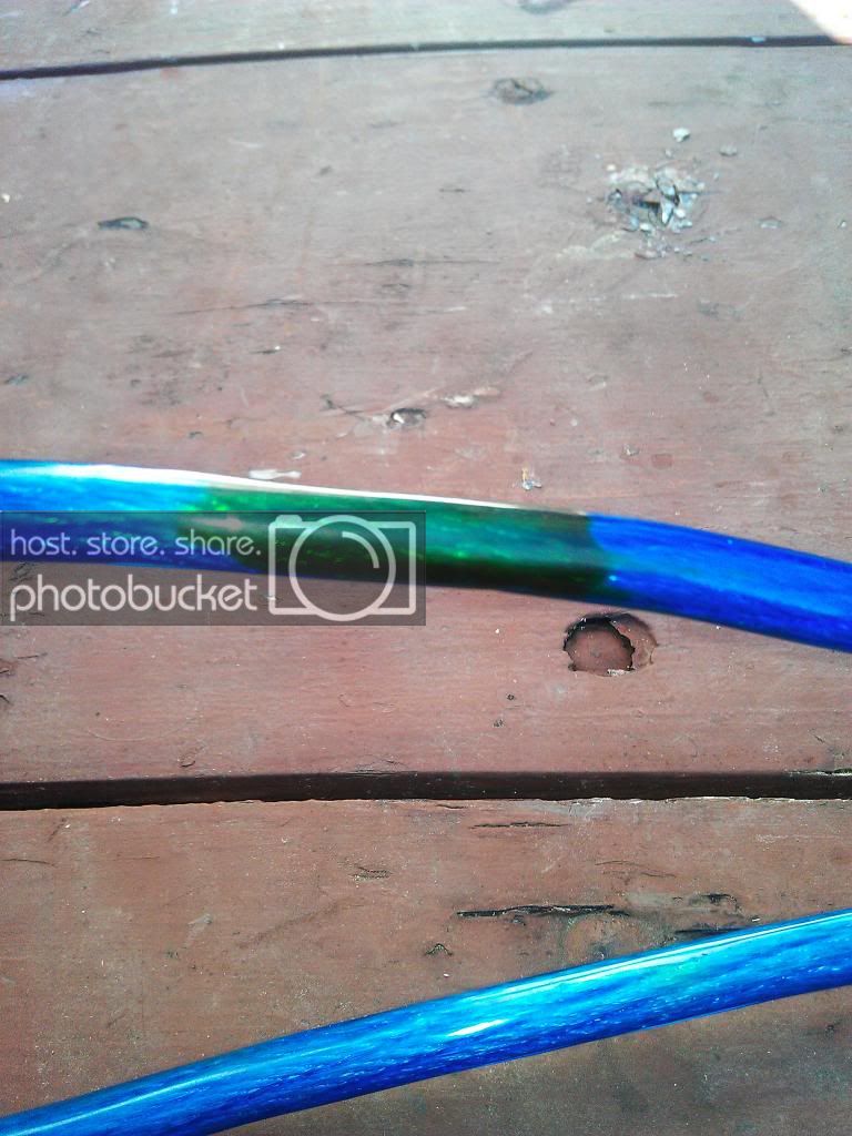

Main power wire
Same spot as above two, again slightly to the left, discoloration fades.
Fully normal wire color on left end of wire in this picture.

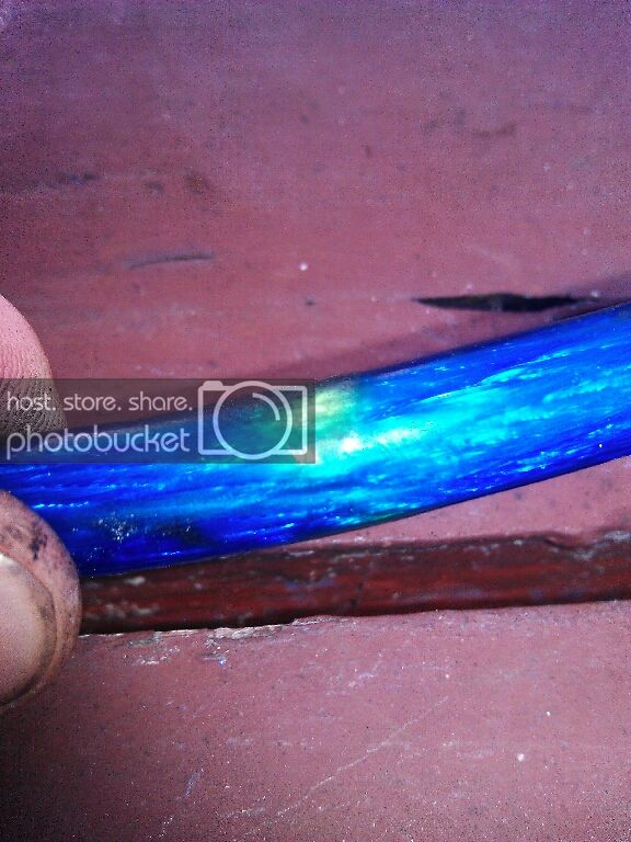

Main power wire
Different spot.
Showing a gap in discoloration (Middle of wire, top and bottom edges are discolored.)

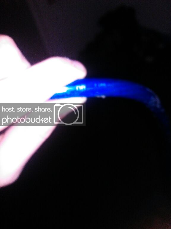

Main power wire
Different, yet similar spot. Very distinct discoloration.

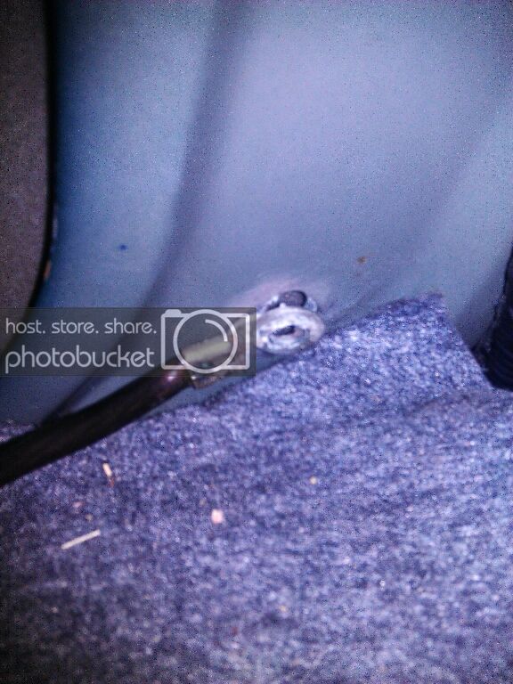

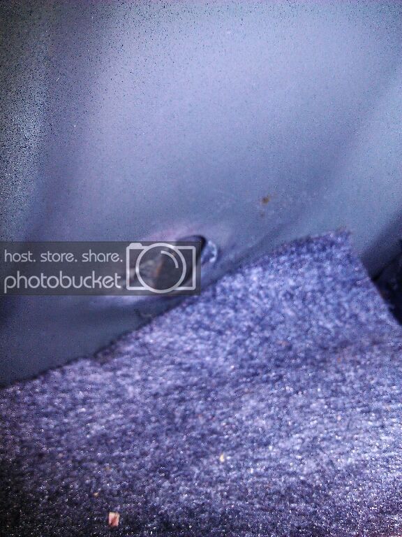

Ground spot (Seat Support, Unused bolt/nut, put it to use.)
Ground spot (Shown is how the ground would be bolted in.)

In conclusion, I found no spots where my power could have been grounding. (The slit does not penetrate deep enough to tough the wire.)
Your blue wire looks like some cheap audiopipe cca, but I still suspect you are setting the gain too high with cheap amps.

Do you have a fuse in your fuse holder? I don't see it...
The Audio shop said they tested it, it was bad, so they threw it away...
Come to think of it, I'm not sure I have another laying around..
Derp dala derpderp. They must'ta wanted me to buy their stuff.. sales sharks. Screw it, Gonna get a different Fuse holder. AGU's aren't stocked in my area 60 is the highest they're available at the stores I remember going to, even recently thinking about upgrading since the audiobahn had 30A x 3 fuses.. maybe it was being under powered.. I only had a 60A fuse.
I remember seeing MAX/MAXI? of like 80A-100A (The large blade fuses. Fuse holder kits were seperate, and only included a 30A.) Wonder if ANL fuse holders are cheaper and/or more oriented towards car audio. Seems questing is needed. Price check on prune juice bob.. price check on prune juice. (Ferngully reference. OT, sry.)

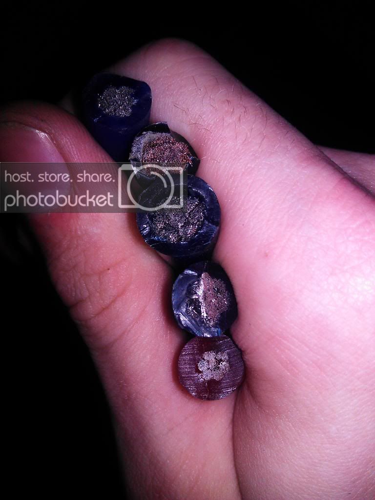

Wire comparison.. Seems my Power Connection Wire # 2 is the closest to true 4GA that I have.
L to R: Navy blue-ish Brand X wire (Power connection # 1) is 1'4"(before Fuse holder,) Dark Brown/Light Blackish ground wire and is 2'1", Power connection wire # 2 (Pictured with the discoloration) is 9'4", Dark Blue 4GA Wire (DB Link wire pictured below) (Used for Amp - to - VC2 is 12'6", and Finally the first 4GA Wire I ever bought. This last wire was used for Amp + to + VC1 ( 10'9" run), jumpers for VC1 + to + VC2, as well as VC2 - to - VC1 (2x Short 2' long ea. runs.)
^ Could any of the wire differences cause an amps audio outputs to cook/blow?
Thanks in advance for input.
