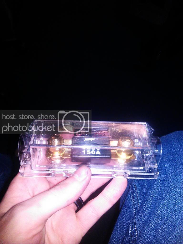

New (Says it accepts 4GA/8GA, but looks like it could take 1/0) DB Link Gold Edition ANL fuse holder w/ 150A Stinger fuse.
Packages
Nice Fuse, and Holder..I would say as others havent mentioned to look closely at,as the wire/original 4ga, looks to be burnt inside the Jacket/strands burnt.I know it blows, but it looks to me that the 4ga wire is not any good,and needs to be replaced for sure.Also, the 150 amp anl fuse should be the largest to be used on 4ga wiring safely,no bigger
