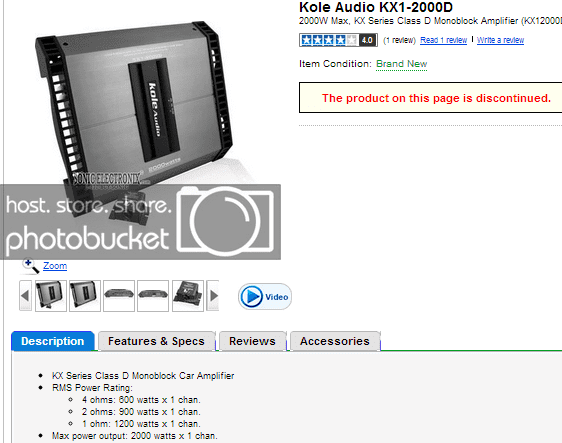

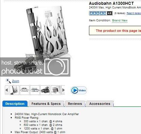

So far my T1 ate through an Audiobahn A1300-HCT(Which lasted 6-9months with my T1 until Sunday evening,) and a Kole Audio KX1-2000D (Which only lasted two days.)

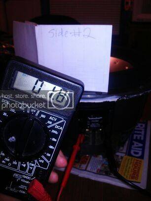

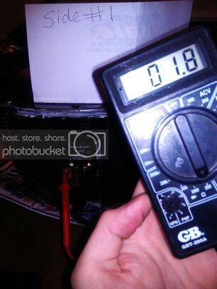

Arriving home I break out my handy-dandy Multi-Meter to read the coils for myself.

According to specs from SonicElectronix, the voice coils should read 2.0Ω each.

I posted links to the specs/ratings for both amps in my original post.. but here's a screenshot from those links:
*Screenshots from SonicElectronix.com^&v
Both state they're 1-Ohm stable, and list RMS ratings.

As both voicecoils are reading spot on for that sub it wasnt the sub that blew your amps. Reading anywhere from a 1.5 to a 2.4 on a 2 ohm sub is perfectly normal. Its when you dont get a reading or a very high reading that something is wrong.
