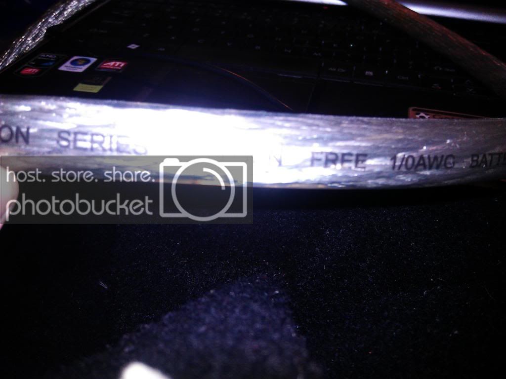

Deff get that big three done for the power you are running/amps..it will help tremendously.Have a good one..I run ofc, and its fine as well..any wire ran at the moment is better than the burnt wiring you have in there at the moment for sure.I think you will see/hear a big difference once you get it replaced

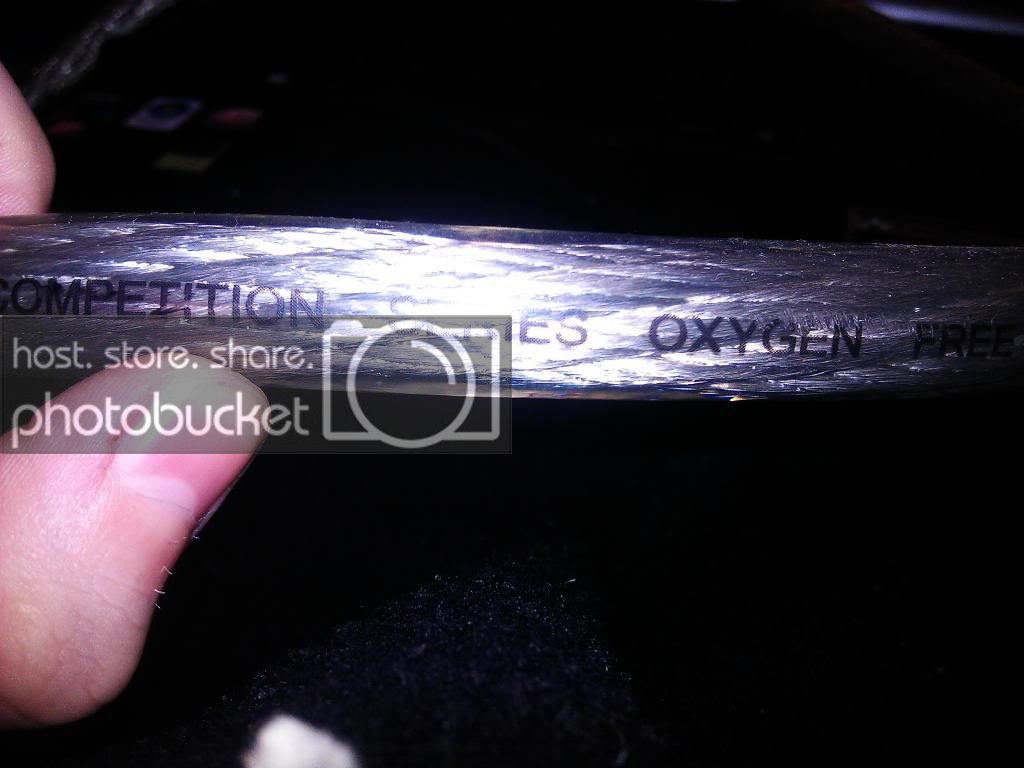

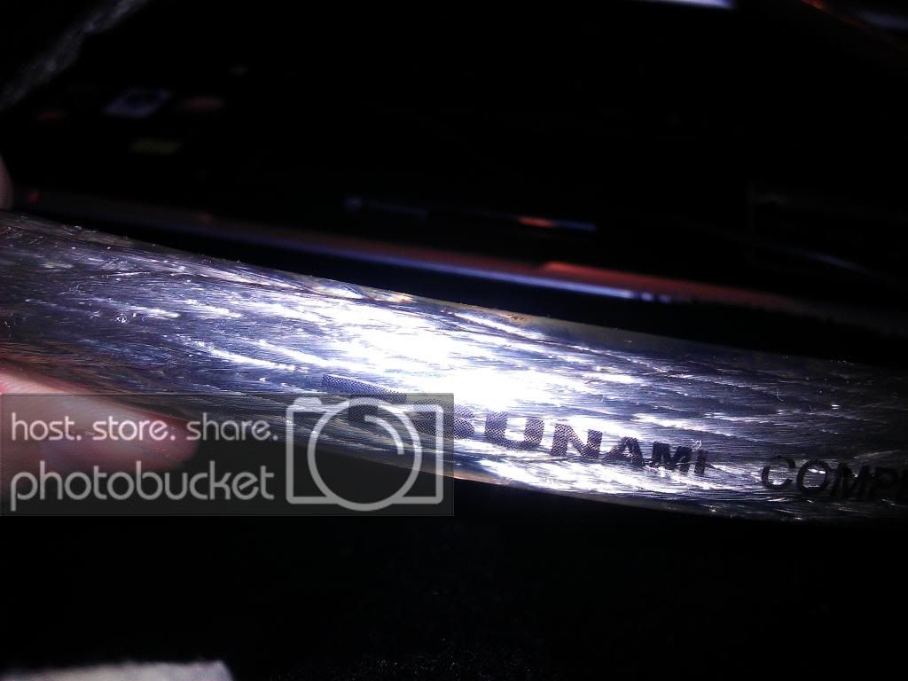

Pics of my 1/0
Logo:
Competition Series Oxygen
Free 1/0AWG Battery Cable

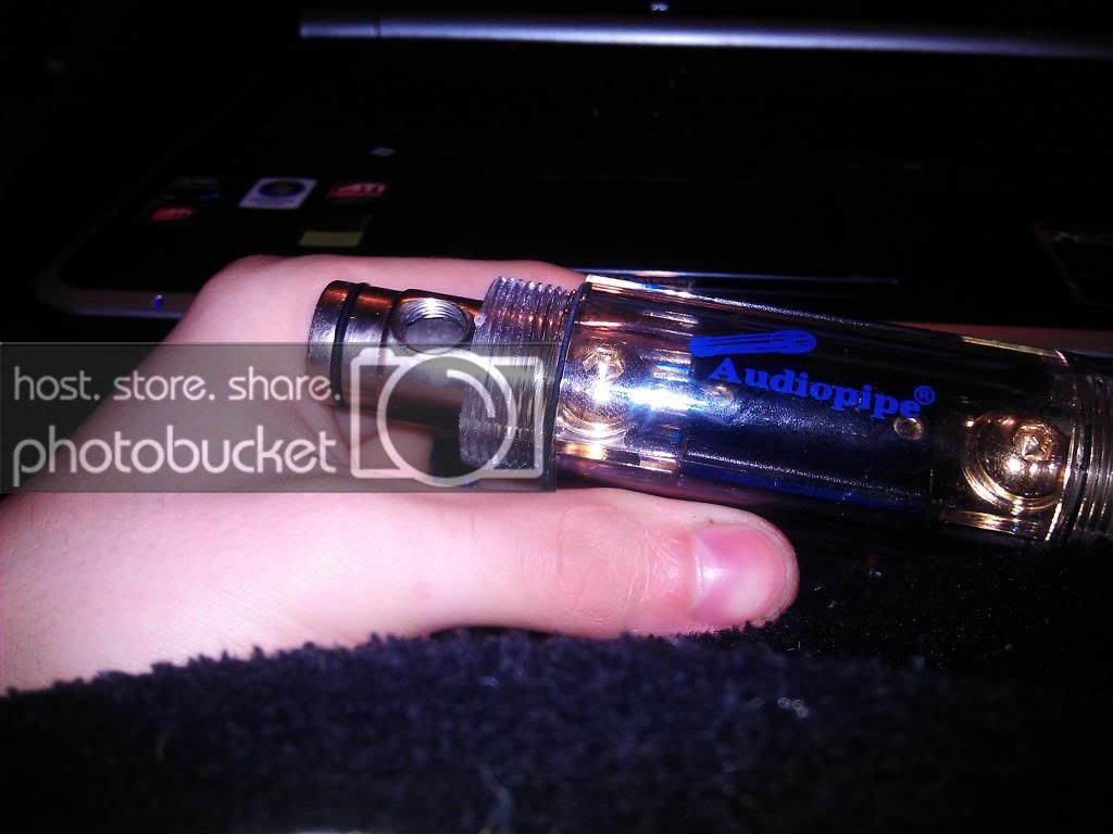

I had an ANL Fuse holder this whole time, reason for not using it is, its missing a terminal screw. Left end is missing screw, Right end isn't pictured:

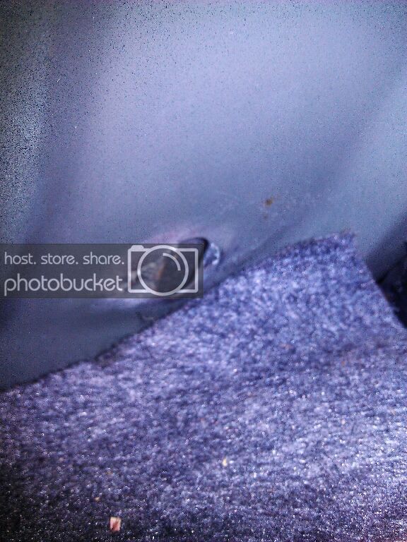

This here in this picture is what is referred to as "shorting".
It happens when the bolt holding the ground tightly becomes loose and allows the wire to bounce around and "short" out. It is charaterized by the melting and discoloration around the bolt hole. The body of a a vehicle is definitely not the best grounding spot for higher power amps.
I try to create a "circuit" between all the grounds in my vehicle. This circuit will guarantee the best and least likely to short. I try to ground all my equipment to the frame, and also make sure I ground my batteries to the frame. A small hole and a grommet is all it takes!! And don't worry about the hole, they make plugs to seal it so your resale value won't go down!!
I shaved the paint off of the ground with a wire brush and a drill.. the discolored part of my ground, in my opinion, is a protective coating I used to prevent corrosion. I can take a closer picture to explain further.
Yeah man, extra pics would be awesome! The more information we have, the better the chance of helping you. Plus we all love pics here!

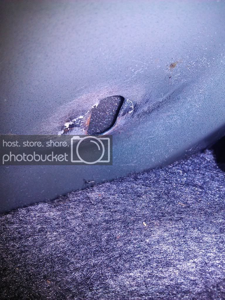

BEST Resolution I can get out of my phone:
This picture shows more clearly that spray corrosion protection (More over a spray adhesive) residue, as well as a small spot of rust (Sun roof leaks, allows moisture to build up in the cabin, this spot is close enough that it's likely to have been exposed to the moisture.)
I'm thinking what you're referring to as a spot that looks like it's "shorting" is just a shadow cast by the build up of the residue. Unless you know for sure that the rust is caused by "shorting."
I will be sure to hit this spot with a wire brush again, unless I find a way to get to my frame without drilling through the bottom of my trunk.
Thanks for your concern and advice! I'll definitely take it into consideration!!

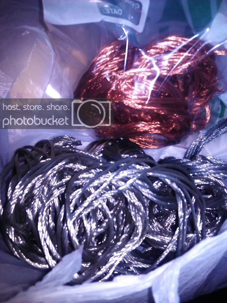

stripped my wires, this stuffs headed for scrap yard tomorrow provided the world doesn't end.

I just realized you posted again, and that ground is definitely the problem. The 4 or 5 layers of protectant the auto manufacturer puts on the body is really hard to take off. a wire brush just won't cut it. You will need a grinder to get down to the bare metal. But my first suggestion will always be to ground to the frame, lol. It's the safest and best ground and if you can get all grounds to attach to the frame, it will help things run better, give you less noise introduced onto the system and facilitate higher output voltages from your amp and allow the whole system to run more efficiently.
