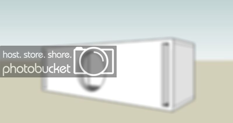

Here is my idea for the box I would like to have the sub in the middle with two slot ports like so || O ||
Thanks guys
Cannot make ports on both ends due to the port would be to small and cause air turbulance so you have to have (1) 2" port on on end of the box || O like that
this box is 1.5cubes after all displacment @ 34hz
internal dimmentions are 33.5 X 10.5 x 10.5
external dimmentions are 35 x 12 x 12
overall port length is 28.75"--- the .75 is front face of box
here is your cut sheet
front - 32.25" x 12"
back - 35" x 12"
top - 10.5" x 35"
bottom - 10.5 x 35"
side (non-port) 10.5" x 10.5"
side (port) 10.5" x 11.25"
port board (1) 10.5" x 8.25"
port board (2) 10.5" x 16.25"
I would like to put a beauty panel on the front and double baffle to have a flush woofer would that cause any problems with the tuning. And shouldn't both sides be the same size since the port is in the front. A picture would really help if possible

it can be done...Squeezed it close,
1:8.8 ratio.
I would have liked a little more area, but 27 squares is nice for a 10
