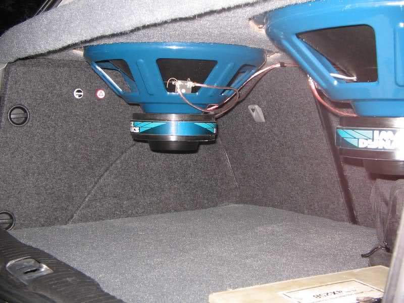

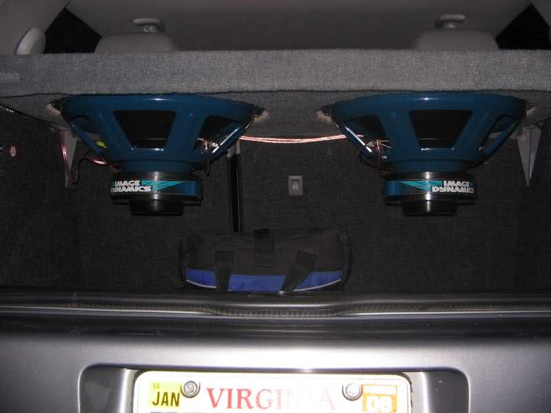

req makes his VW GTi infinite baffle with IDQ15's PICS :D
Thats not IB, but rather a mid sized sealed enclosure.
True IB requires 10x the Vas (IDQ15 D4 Vas=9.09 feet), 9.09 x 2 (2 drivers) x 10 (10 x vas) = 181.8 cubic feet!
The minimum requirement for IB is 4x the Vas, it wont give you true IB performance but its better than a sealed enclosure. 9.09(2)(4)=72.72 cubic feet
The amount of space you have available doesnt come close to that requirement:(
i know its not a true ib setup, but i may cut a hole in the bed somewhere and cover it with goretex to make it vent outside like a hybrid AP\IB setup.
but it gets the woofers lots of efficency. that being said, there arent many cars out there that have 'true ib' setups then huh? //content.invisioncic.com/y282845/emoticons/suave.gif.858fc102f7646e678ee8af7e1fbc41d1.gif

im gonna build a cover for the subs that is made of grille cloth and is about 1\2 above the subs. i got a cool idea.

how much power to each sub?
bout 300w or so. A5 sub channel at 2 ohms.
