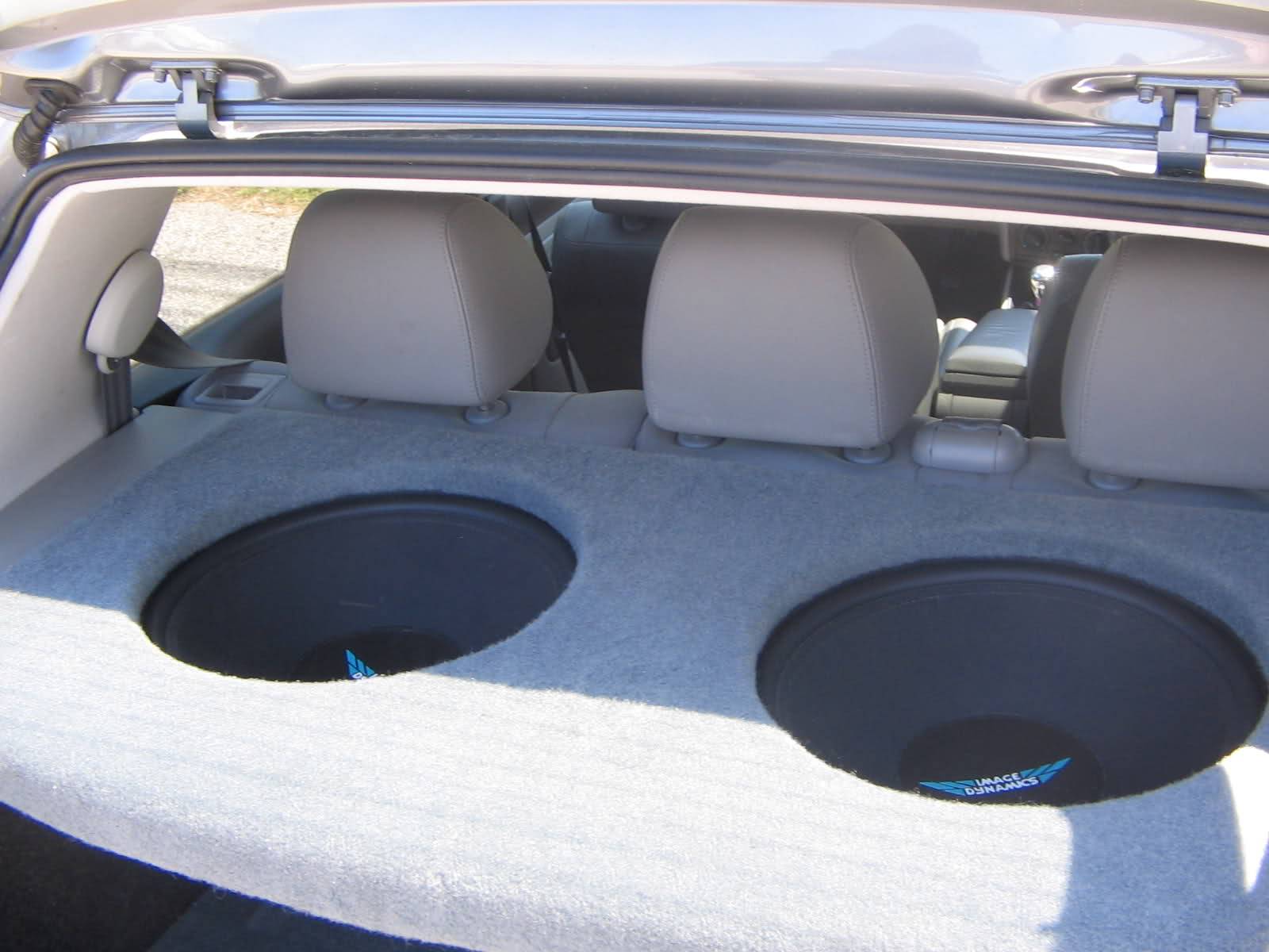

done.
pics.
its sealed up like a bitch. its a nice tight squeez. the only place that air comes out is a tiny gap at the top where the seats come together, i can only fit my pinky finger down in there. very small gap. and then in the back where the tailgate meets the box is nice and tight, but there are vents in the plastic of the tailgate that i need to fill with some sort of foam. ill take it off in the next few days and plug that up.
otherwise its nice. not as loud as my sealed box, but i knew that would be the case. but they are real smooth, and play down real low. now i just need to get CD2MH lenses so i can have a finished system... sigh. next 2 weeks i guess.
comments?
i would cut down that white wire so it doesn't hang. put it in front of the magnets (towards the front of the car). can't see it and you can put stuff in your trunk up to the magnets.

Thats not IB, but rather a mid sized sealed enclosure.
True IB requires 10x the Vas (IDQ15 D4 Vas=9.09 feet), 9.09 x 2 (2 drivers) x 10 (10 x vas) = 181.8 cubic feet!
The minimum requirement for IB is 4x the Vas, it wont give you true IB performance but its better than a sealed enclosure. 9.09(2)(4)=72.72 cubic feet
The amount of space you have available doesnt come close to that requirement:(
