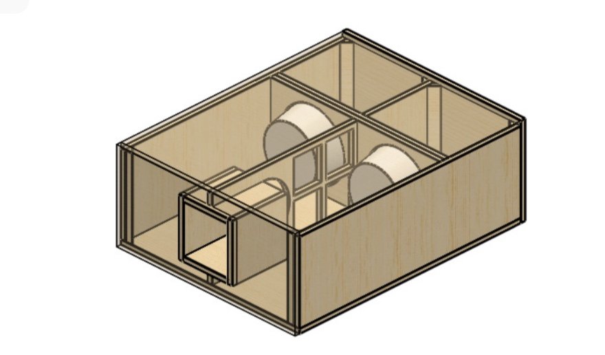

I have a 4th order band pass enclosure for 2-12” kicker comp c subs. 2.5 cu ft sealed to 5 cu ft to the ported side with a 7.75x7.75x9.5 port. I would like to upgrade my subs but would like to keep the same box if possible ( can change port size of needed. Any subs that will give me more power and cleaner bass than these kickers?

Is that 2.5 sealed for both or is that a each chamber? Can't tell if that is a window brace or a solid brace in your sealed section.
