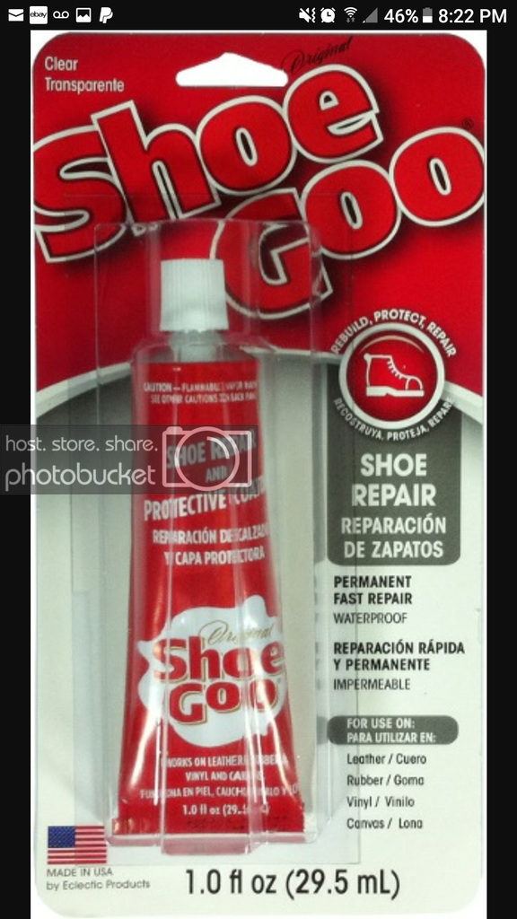

So one of these preferably shoe goo
http://i1244.photobucket.com/albums/gg580/jjzickowski1/Screenshot_20170622-202201_zpszwb8qfro.png' alt='Screenshot_20170622-202201_zpszwb8qfro.png'>
}[/img]
Think there will be a noticeable difference between the black glue on the build house dustcap sub ans the clear on the recone zub?
the color is for aesthetics.
For recones I use thick CA glue for spiders and dustcap. amazing goop for the surround.
You can use CA glue for everything if you want. Amazing goop just has a bit more give, rubber like finish.
The shoe goop is black. If you wait about 5-10 minutes after setting the cap with the clear stuff it's really easy to gently peel out excess glue from around the seem. Wait until it's not wet and sticky but still soft enough to pick off like a booger.
Like I said, either hold up great for dustcaps and I know a couple mid 160 builds that use only shoe goop to build their subs.
