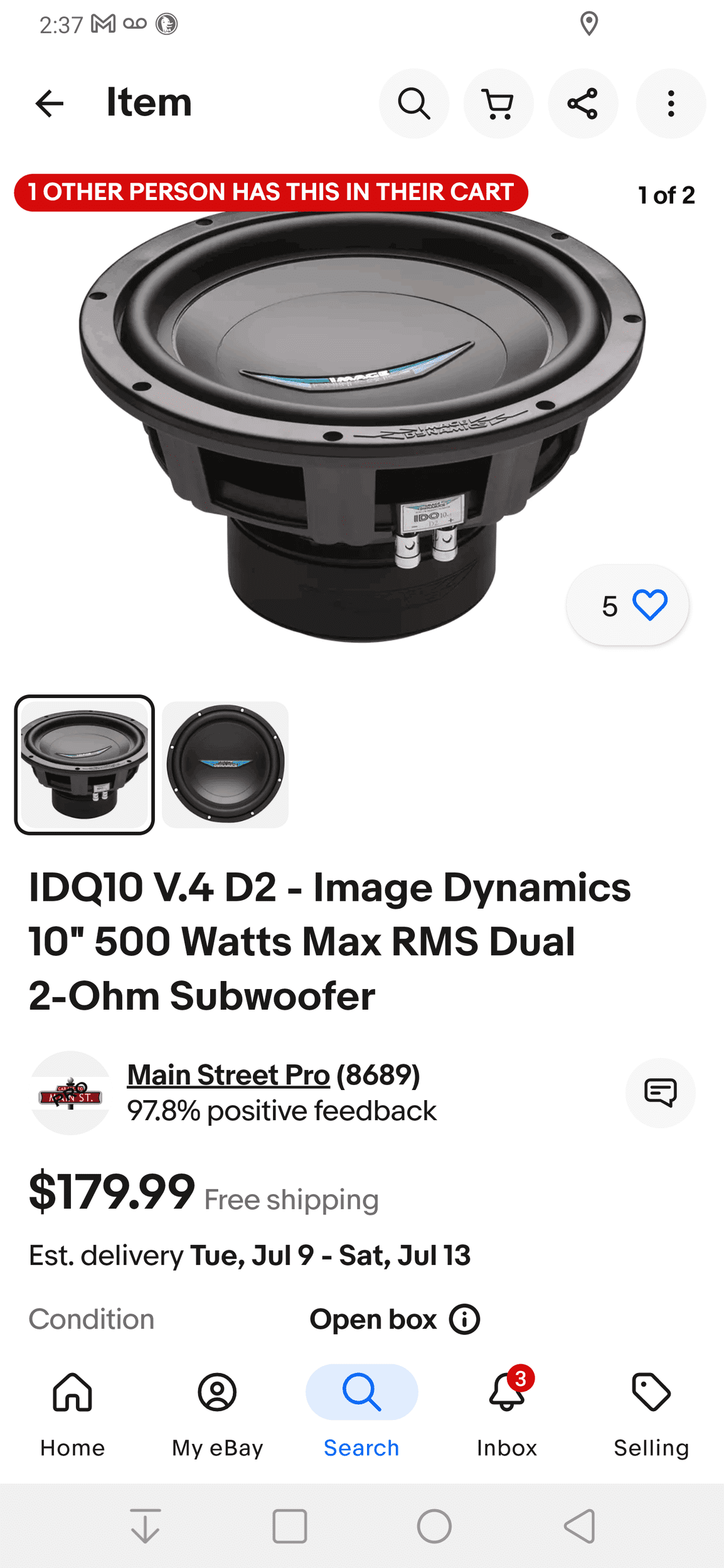

My question is is it worth reconning? MSRP IS $270 and a Recone it's $179. I bought it for $150 with the box. I love this subwoofer cause it blends so nicely with my speakers with little EQ and I'm really upset that I did this. I figured when I finally blew a sub it'd be from intentionally giving it the beans to blow it up
Is that b stock or new? I was also able to find a Recone for $109. Would either of these be worth it or is there a subwoofer that is better for the price that's of similar quality?
For the price as opposed to others, I assume B stock. Thing is you can get it warrantied through eBay/Allstate. I have never used or heard those subs, so I have no basis for comparison. If you go with a different sub, you will need to modify or purchase the sub box, and reset your amp settings. So quickest option is get the same.
I though you stated the recone was $179?? Id grab a different sub that will handle a bit more power and built a little better myself. if the amp has an issue also. be best to find another amp that both can be found on sale today and this weekend. Id pull that amp and bench test it to see if its working properly or not. What type of enclosure do you have and dimensions?
Yea I didn't a little more deep of a dive and found one but I'm not so sure that that I want to use this sub anymore. I found a Recone video on the companies YouTube channel and although it only takes about 15 minutes to do without even using glue, I don't want to use it because apparently the recones are of low quality and often come with details and the company is liable to block you if you complain. I have not dealt with ID at all so I cannot attest to this, but there have been many people on different sites saying the same thing so I'd rather not take the chance.

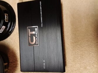

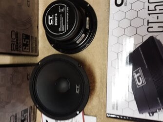

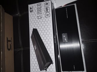

Everything ive gotten and use myself over 2 years now and have recommended to friends and family has been dammned good from CT Sounds thus far. i still have an older sub from the Co. they used to be, and it still work very nicely. Sold the amps and other subs since, but still have one older 12 left. My amps and mids from CT have worked flawlessly. I can be rough on my gear majority of the time
