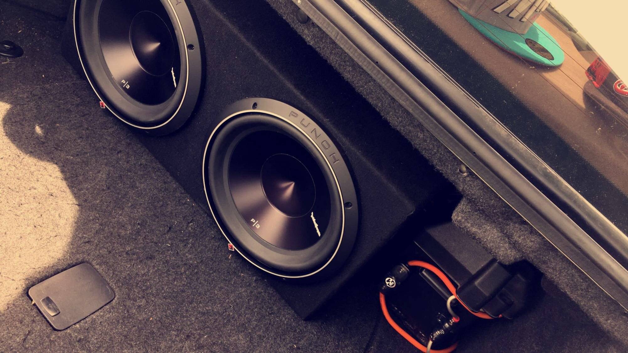

Now for my BASS I have 2 ROCKFORD FOSGATE P3D4 12" Subs in a ported enclosure in my trunk
Whats powering those subs is a Pioneer Gm8601 1,600 watt amp power (I know they are only getting maybe half as much power as they can handle, but trust me my car still shakes like crazy with this amp)

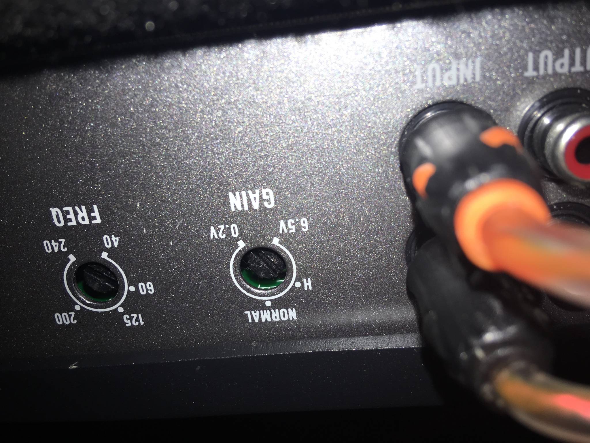

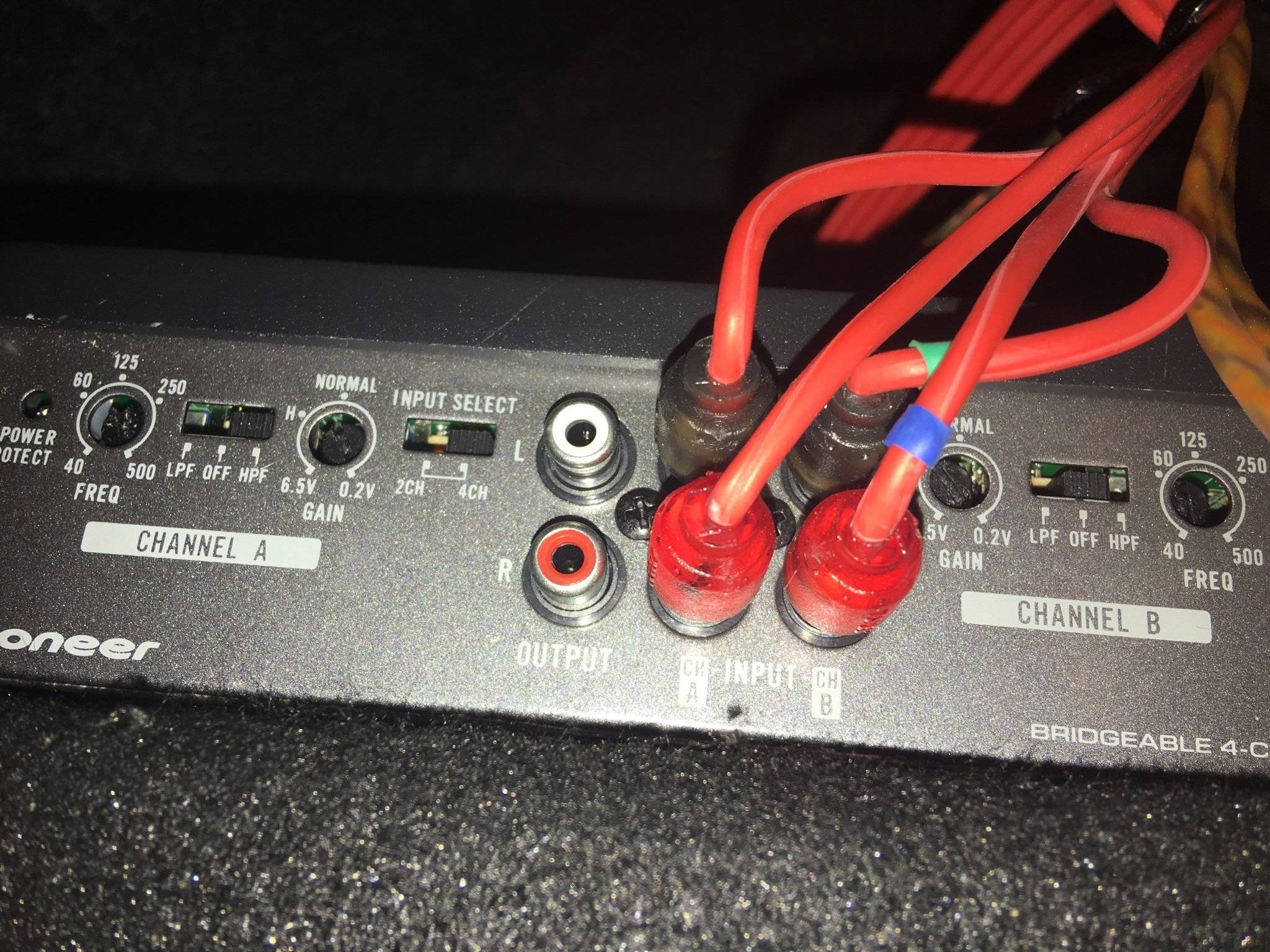

I mainly listen to a lot of rap with lots of "heavy" bass. Heres a picture of how my amps are currently setup, my friend set them up for me
. While the HPF and LPF on my head unit are both set at 80. The slopes are both "1" you can only set it 1-3 so I just left it at 1..
So I should just set the settings on my 4channel amp to off? Sorry I'm clueless about this stuff haha
(not sure what u mean by both lp on hu, it has 2) the slopes are probably 12 18 24db if it sounds good it's fine on either one.. if u have hp xover on hu turn hp over off on amp, set it to 100-150hz on hu listen to speakers with sub off to adjust to lowest u can go without distortion, if u set hp at say 120hz then u can set lp on subs to 120 to still get those freqs up to 120 from subs
