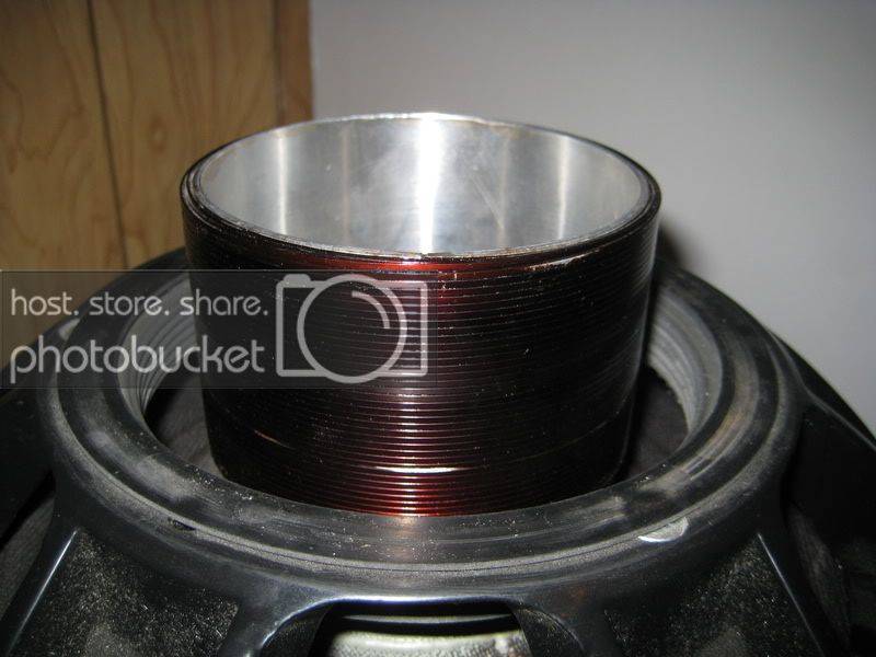

I've heard a bit about Tim Roy, and yes I meant the tinsel leads...still trying to wake up. I have to pull out the driver to take a picture of what the coil looks like, unless its in my photobucket...i'm just hoping it's not an issue.
Found the picture...Here is one side of the coil (you can see some slight marks that are the same as the other side of the coil)

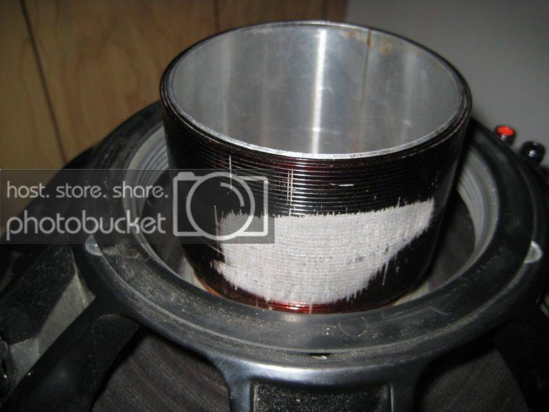

And the other.
I hear no coil rub and the sub seems to move fine. Is it something that I should be worried about?
thats definately an issue

I'd order a recone couse i doubt that will last to much longer.
have not put a DMM on it yet, but i plan to do so. I thought I did before and all coils matched, but I'll be doing it again to verify. Before I bring this driver to its death, I want to make sure I find someone who can recone it first. I really want to use TC parts so that it remains a 5200. I don't want to sacrifice the SQ I currently have.
