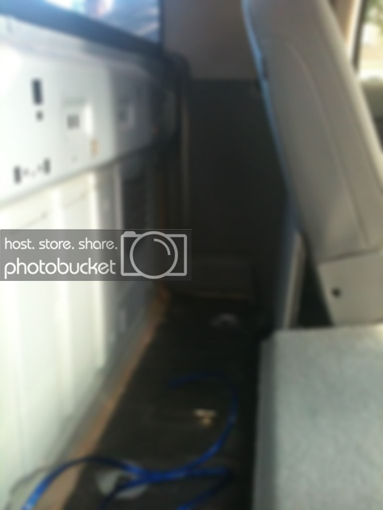

Here is a pic of the room I had to work with. This is looking at the back of the rear seat on the driver side of the truck.

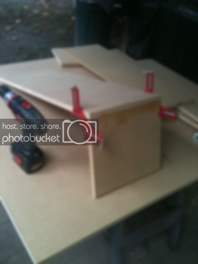

Getting started on the box //content.invisioncic.com/y282845/emoticons/biggrin.gif.d71a5d36fcbab170f2364c9f2e3946cb.gif

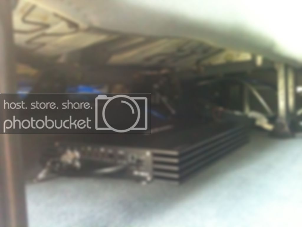

Decided to mount my amp under the passanger side of the truck since it was wider than the driver side. 70/30 split rear seats.

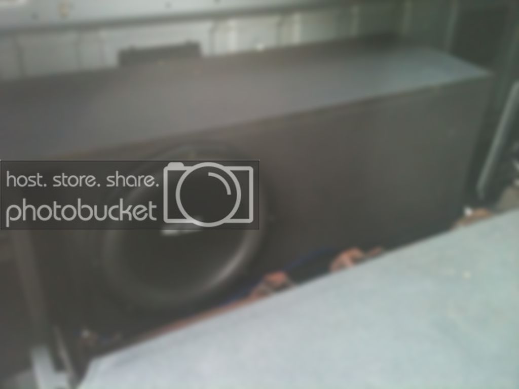

And since the box was 35" wide it fit perfectly behing the passanger side rear seat //content.invisioncic.com/y282845/emoticons/smile.gif.1ebc41e1811405b213edfc4622c41e27.gif
I like the way this box turned out. This was just supposed to be a temporary box so I could see if I liked the sound or if it needed to go in a different box. That being said, I love it. Sounded better than I had hoped for //content.invisioncic.com/y282845/emoticons/biggrin.gif.d71a5d36fcbab170f2364c9f2e3946cb.gif
Once fishing season is over, I think I may rebuild the same box and then carpet and put the rear panel back in. With that rear panel in I dont have enough room because it is padded and filled with foam so my plan is to get another rear and trim it around the box.
