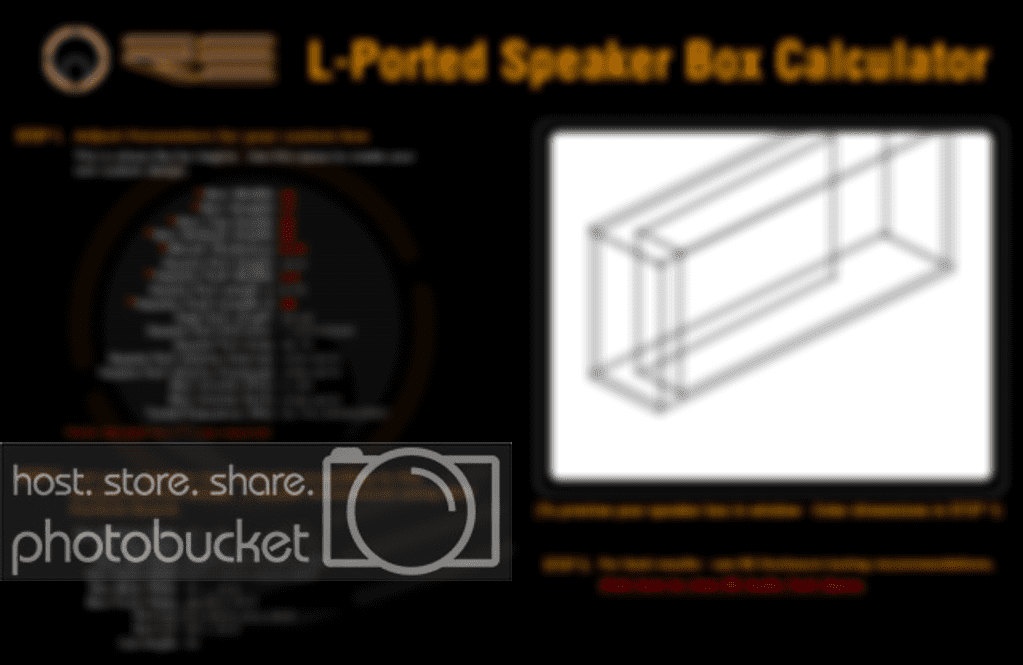

Im still trying to figure out if this sub will work in my truck and I believe I have found a way.
I removed the cargo storage area behind the seat and pulled the plastic/carpet/foam crap off the back under the window and opened up some more room to work with.
AROUND a 2' cubic foot box tuned to 33hz.
I used the RE box calc. and came up with this. Can some one please double check this and tell me if Im on the right track?

now subtract .16 cu ft for the displacement of your sub on the figure above on the reboxcalculator.
You have plenty of room man.
Yea see thats what Im wondering. When I first bought this sub I had it in a 2.5cf box ported to 35hz and it got plenty loud. Even with only 600w to it off my old amp. Now Im going to be using a PB ASA 1500.1D so it should see all 1500w. Just trying to get a good box in the space I have to work with. I just dont have much experience with this sub and also want to make sure that the RE box Calc. is accurate //content.invisioncic.com/y282845/emoticons/smile.gif.1ebc41e1811405b213edfc4622c41e27.gif
Recommended Enclosures :ported Compact: 1.5cf tuned @ 35HzPorted Optimal: 2.0cf tuned @ 33Hz
Not sure I would give the re sx any more than 1300rms but if you make the box a little smaller like 2cu ft it will be just fine. Not sure what you will have in the real world with impedance rise though but you get the picture. You have a solid 2 cuft it should be just fine.

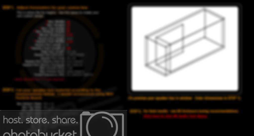

hey man ur only gonnna have 6.5" of mounting depth with that setup. just check that
I noticed that also so I will be mounting it all the way to the right of the box past the rear port wall.
yeah good eye, that is why I recommended aero ports lol.
Im not opposed to using areo ports but I never have before and since Im already having doubts about designing this box I dont know what the hell would happen trying to design a box with aero ports haha.
I dont know why I am busting my brain this bad this time. Im guessing because this is the first time Ive been constricted to a certain space. I had a station wagon before this and a Rodeo before that.
I may have to play with this more haha //content.invisioncic.com/y282845/emoticons/frown.gif.a3531fa0534503350665a1e957861287.gif
use 2 aero ports, or is it possible or do you have room to make just the sub area a external baffle of mdf 3/4" wood? If you make a sub external baffle with 3/4" mdf wood you could barely squeeze the sub in it..

As for round ports, on the12volt round port calc. I put in a 2cf box tuned to 33hz using a 4" port and its telling me to use a port 12.6" long. Sound about right?
Im sitting here thinking too. If I make to box shorter down to say 14" instead of 17" I could make it deeper due to the way the seat leans back.
