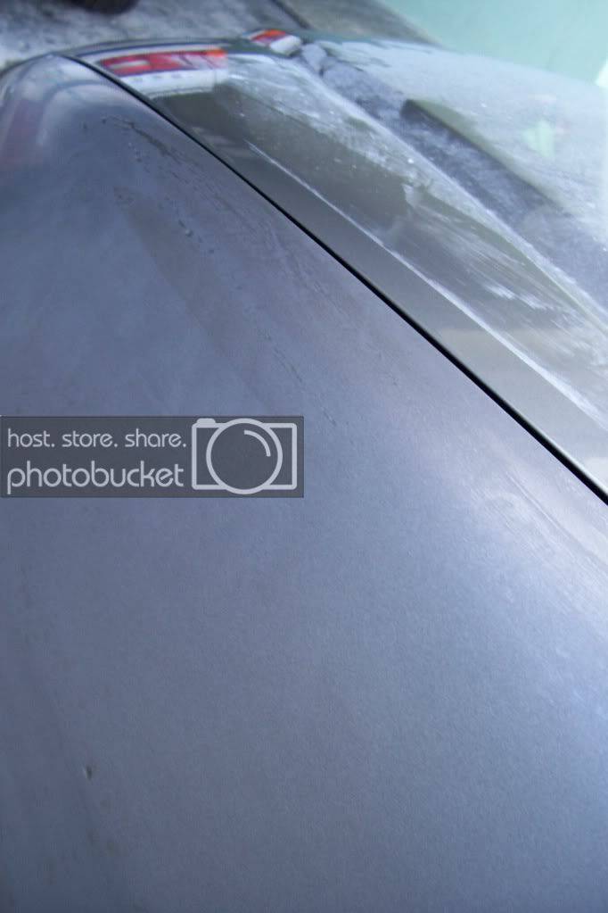

well, late 2007 i was involved in a fender bender and had panels replaced on my car along with my headlights. well, i never had the panels painted until about a month ago. initially the first paint job which was to just be painting a brand new never been mounted bumper and drivers side fender.

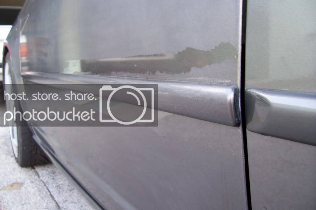

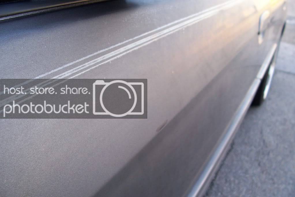

well, when i took the car to the shop they repainted it with a paint found using the color code of my car. the paint turned out to have too much red pigment so the car had to be repainted. i was not happy for numerous things. the color of the paint, the fact they painted my drivers side door in an attempt to "blend/fade" the paint, painting over the sticker pinstripe, poor surface prep on the door, over spray over the entire car.

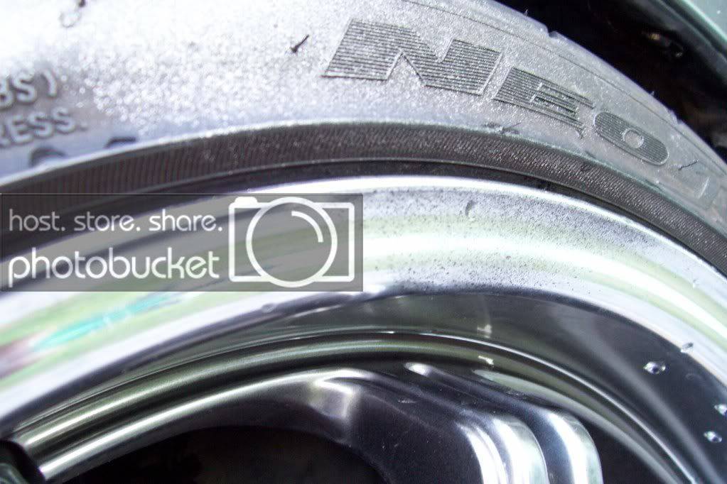

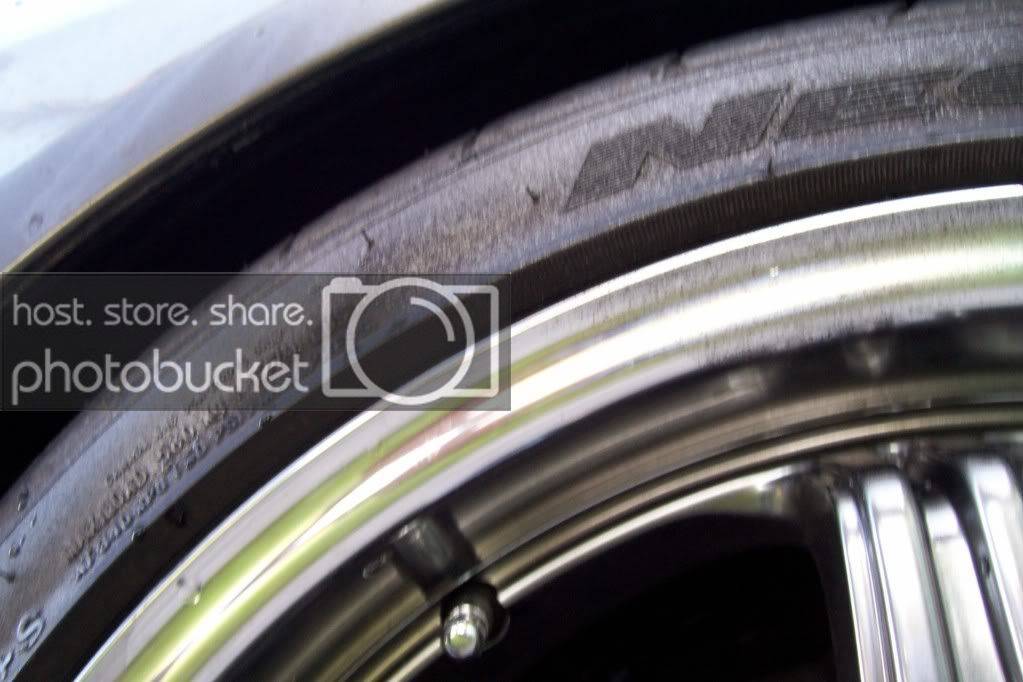

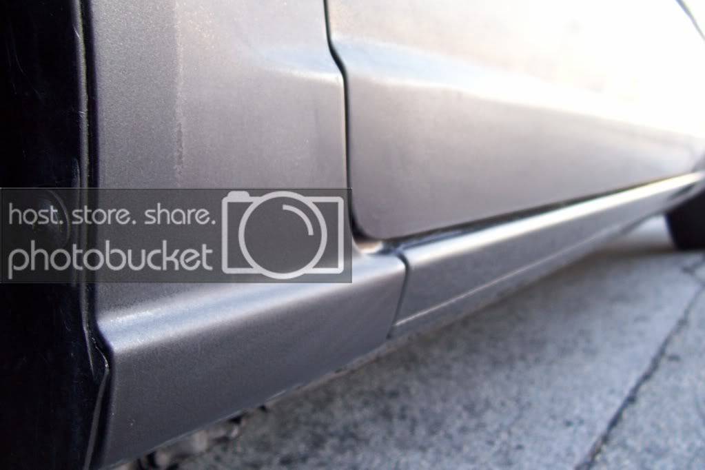

when i took the car back they had repainted it again with a color match from taking my gas tank door to a 3M place. they repainted the car again with poor surface prep, lacked clear in areas, drops of clear in some areas, orange peel up the ***, painted over the pinstripe again, a spray of paint on my windshield, over spray on my passenger side rim/tire, overs pray on rest of the car. not happy with the second result and the color STILL being off i'm forced to say **** them and sick of dealing with them.
today, i spent 7 hours wet sanding the orange peel off so i can buff it with my DA buffer. i would say i took care of 90% of the orange peel but found some areas where the clear was so thin i got into the paint. thus also where i found over spray on my tire/rim. also i had taped off 2 areas on my door so i could wet sand the side trim, when i removed the tape, along came the paint. the paint has been on the car for over a week now too. great!
here's some pics for you guys.
