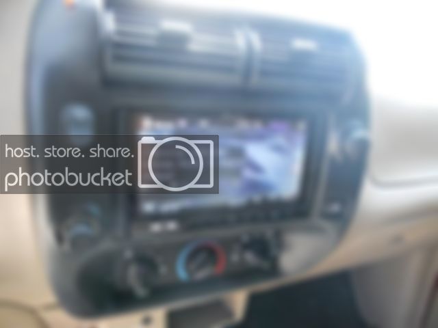

get a trim ring around that bad boy man. im assuming you got the metra install kit? if so the trim rings dont work. you have to take the one with the two din openings and cut the middle piece out. then cut the bottom off and just place the trim ring around it. it should seat up in there really nice. also almost forgot, in the corners you have to sand or cut them into a nice 90 degree corner instead of the rounded portion. chk mine out below:
