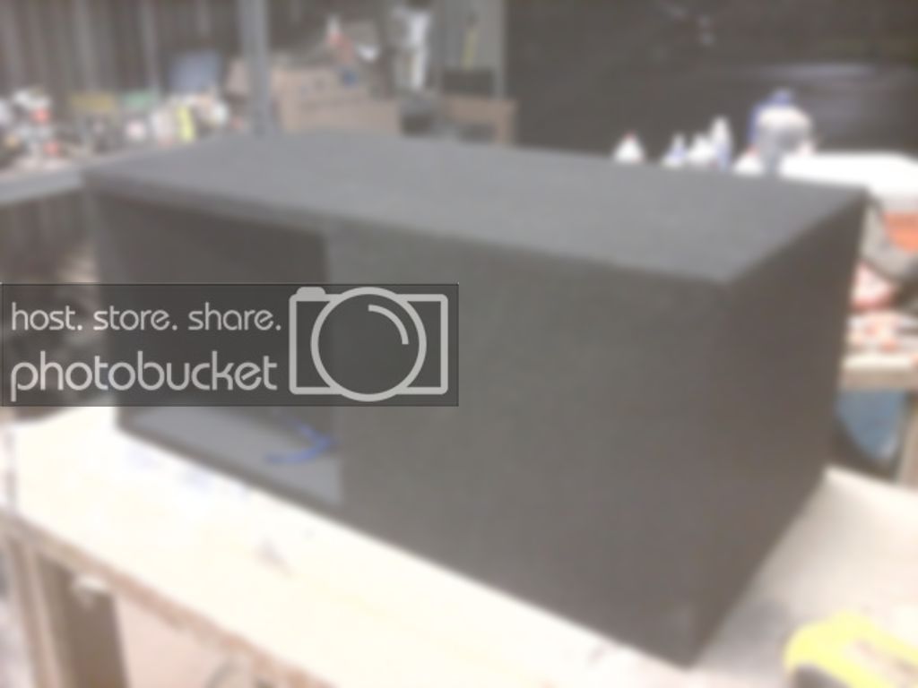

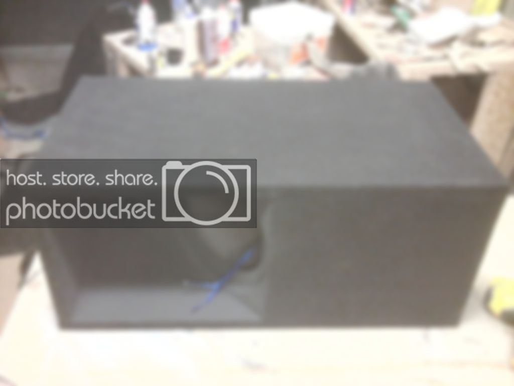

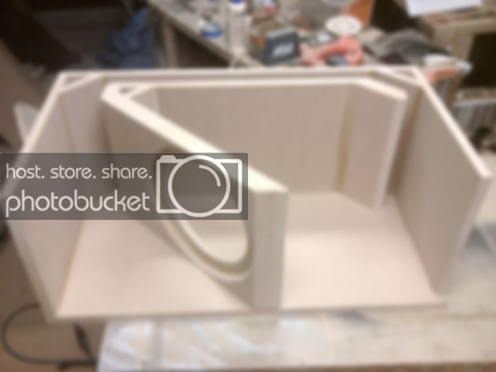

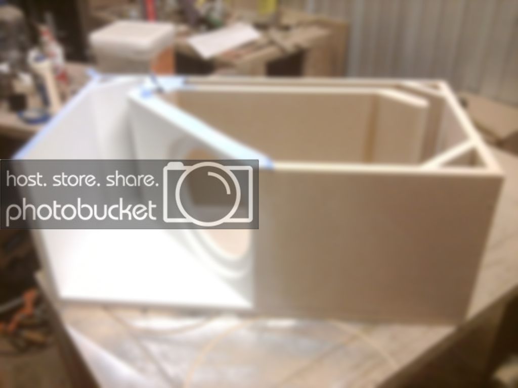

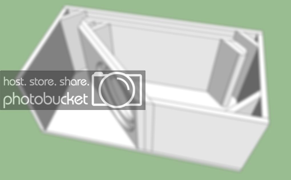

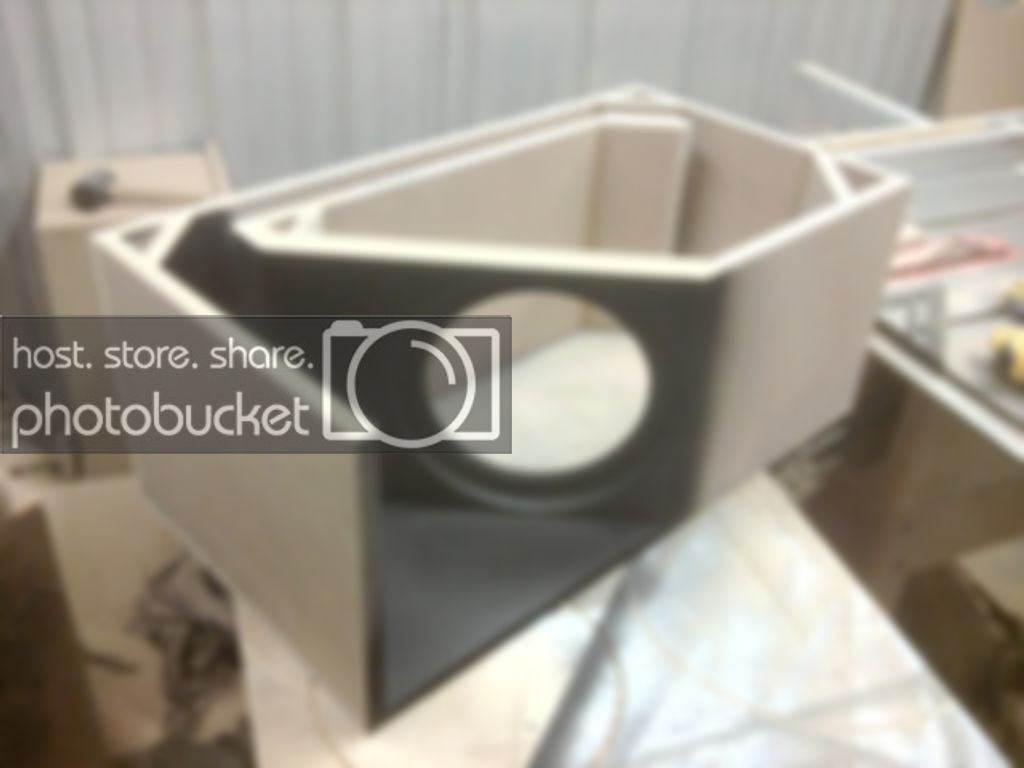

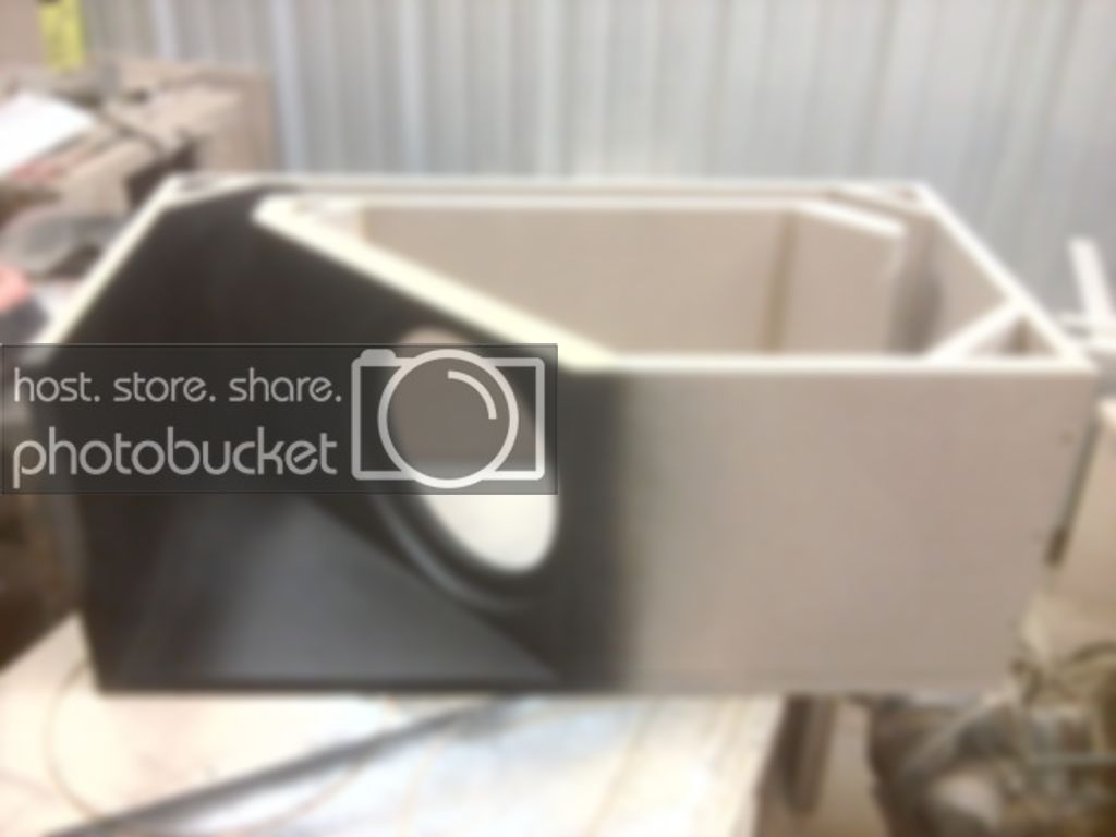

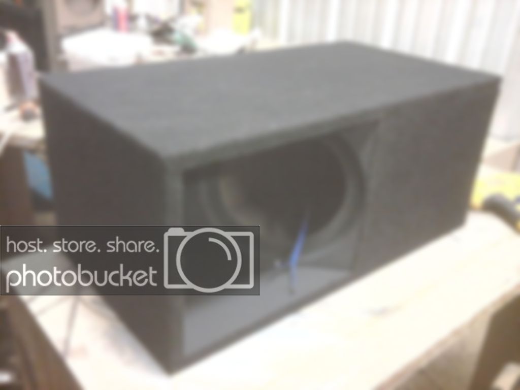

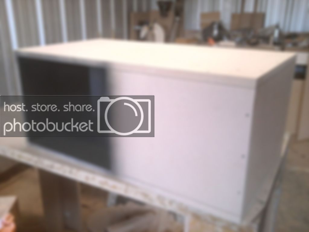

Alright, this will be for Limegreengsr (car forum local) and his 10w7.
Specs come to:
-1.25 cubes net
-32hz tuning
-17.25 sq inches of port area

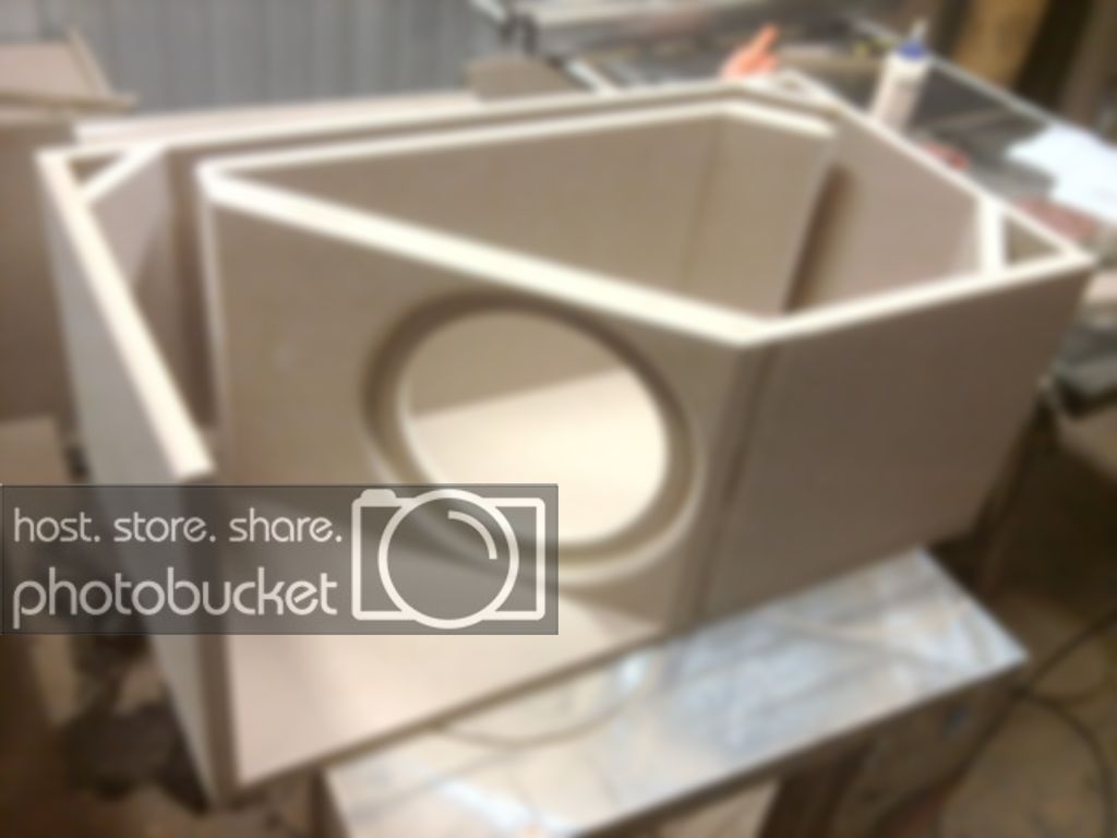

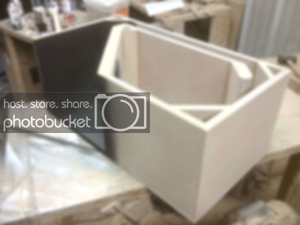

A look at the design:

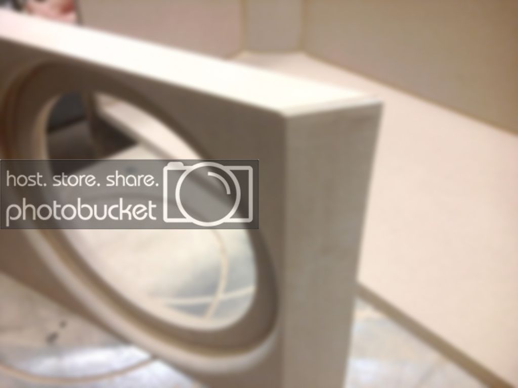

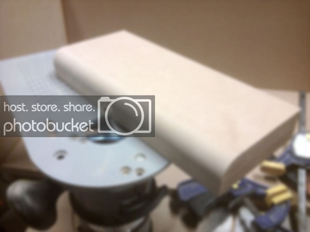

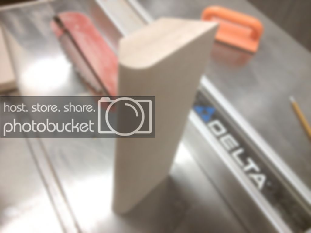

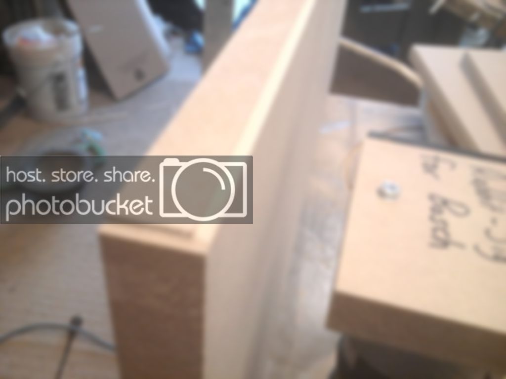

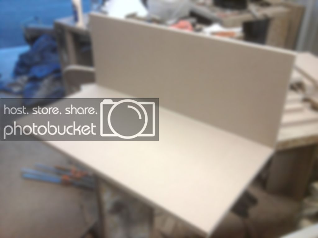

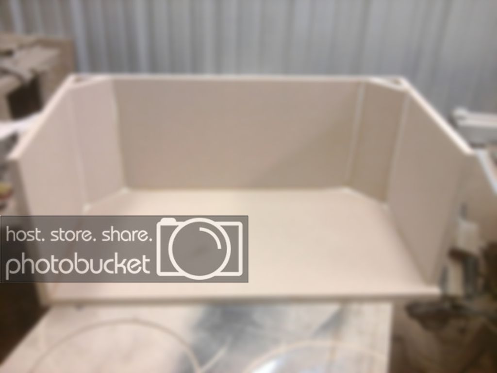

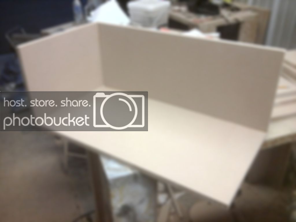

And I got a good pinch done tonight...but I ran out of battery in my cell phone and couldn't take pics of the baffle cutouts, them getting rounded over, and all of the 45's cut //content.invisioncic.com/y282845/emoticons/frown.gif.a3531fa0534503350665a1e957861287.gif

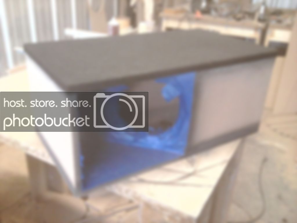

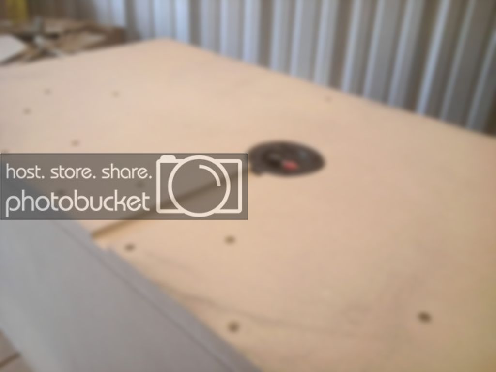

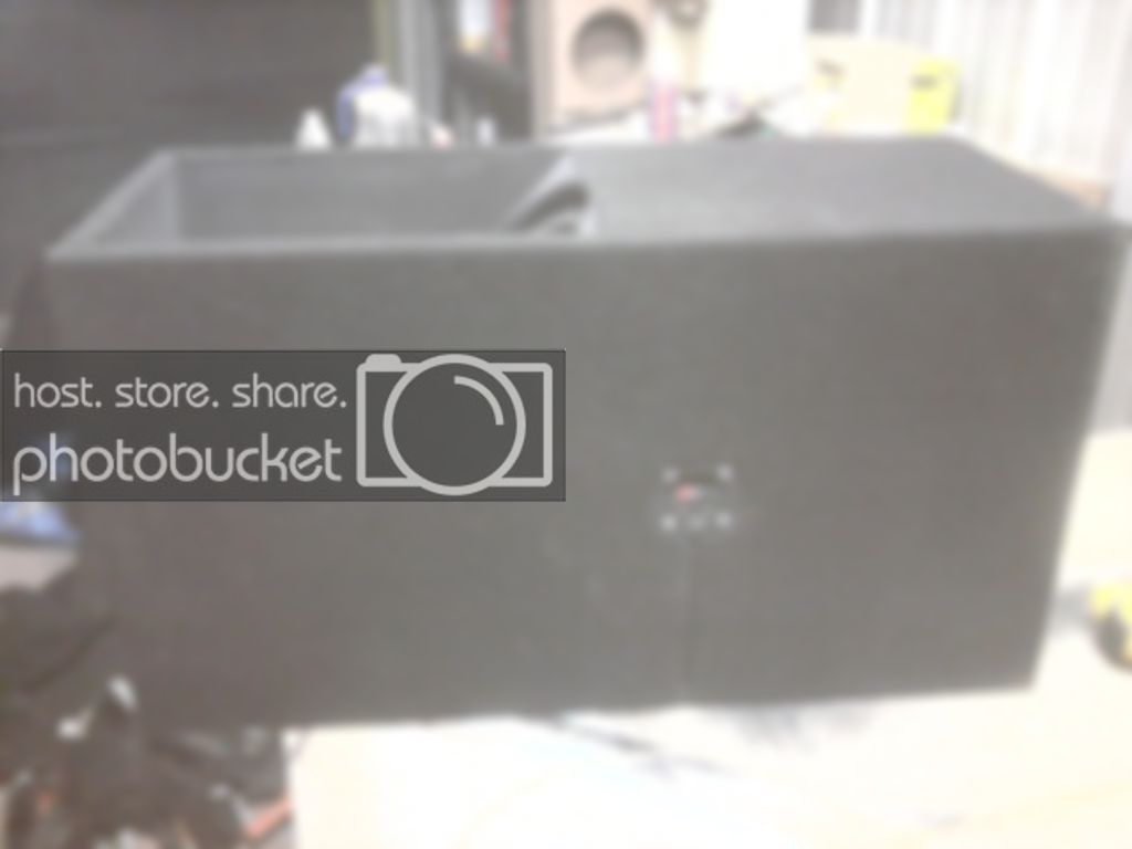

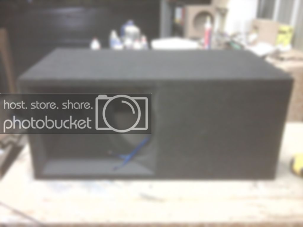

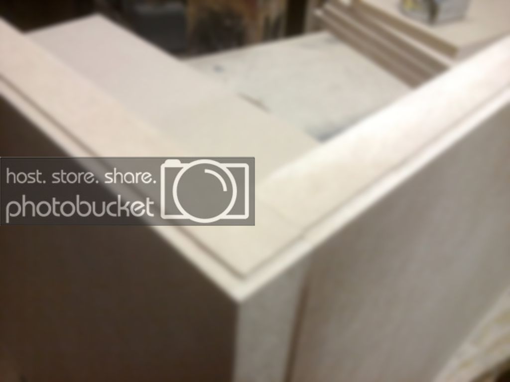

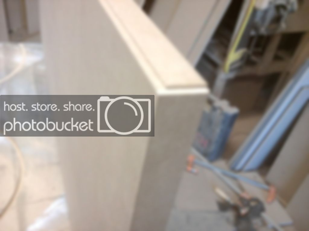

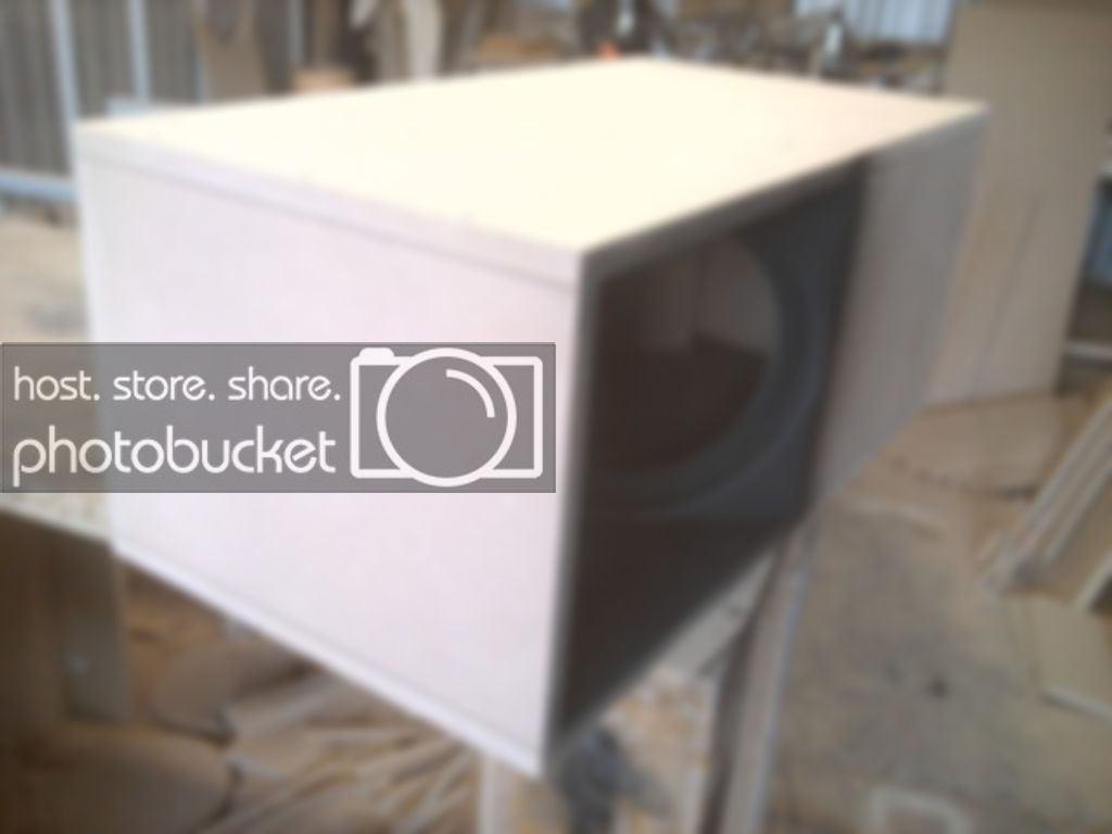

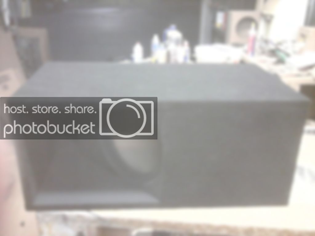

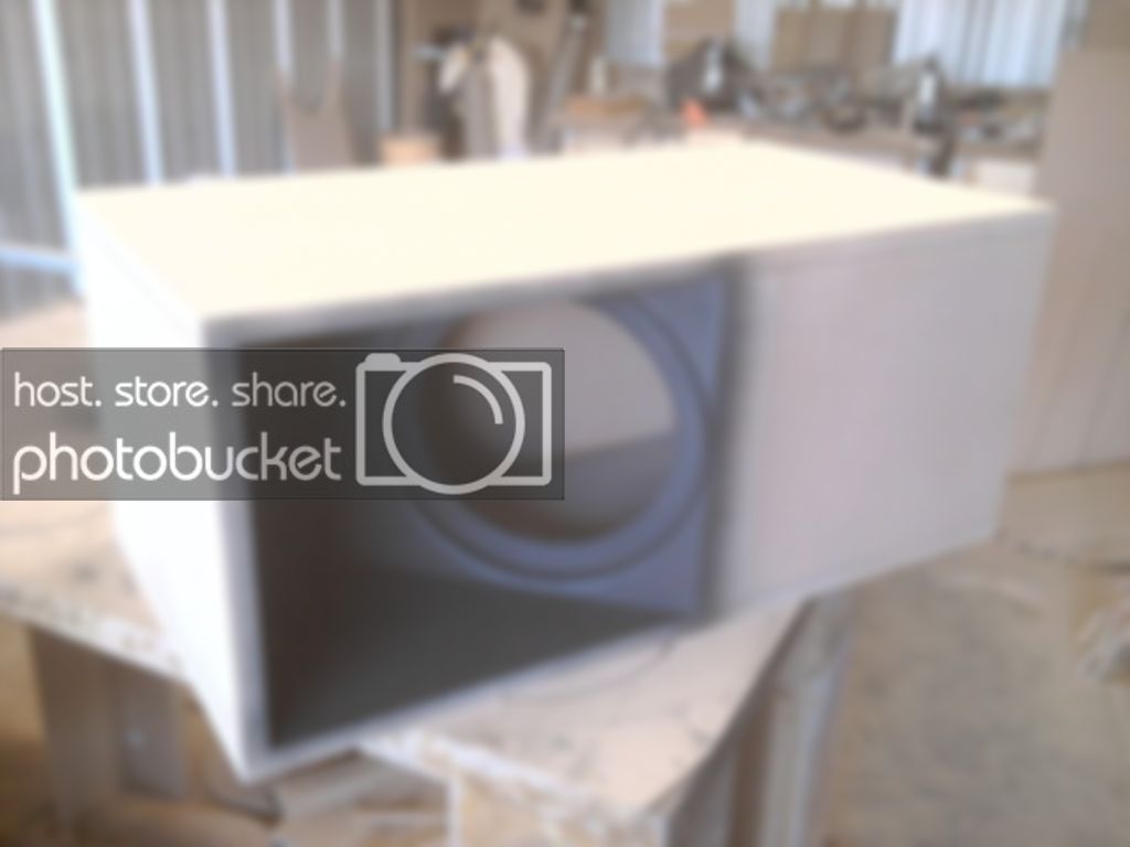

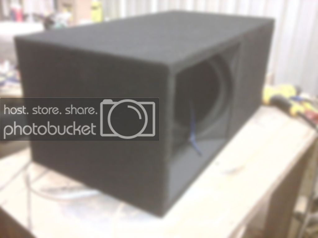

A new technique I thought of today for carpeting (a different take on rabbiting)...should work out nicely...

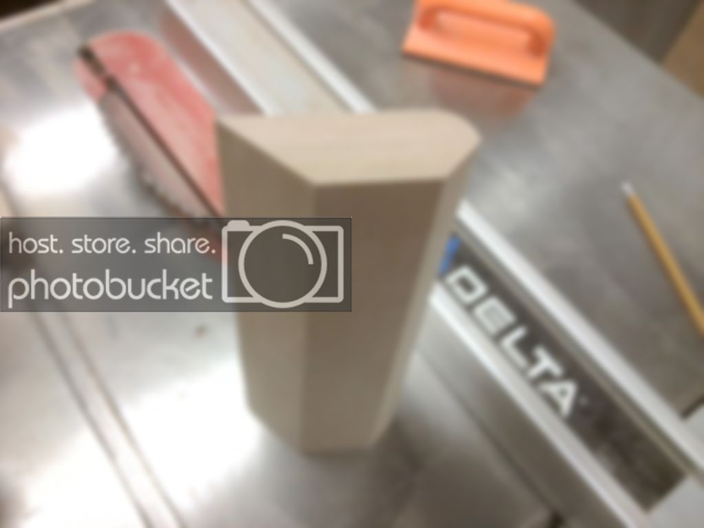

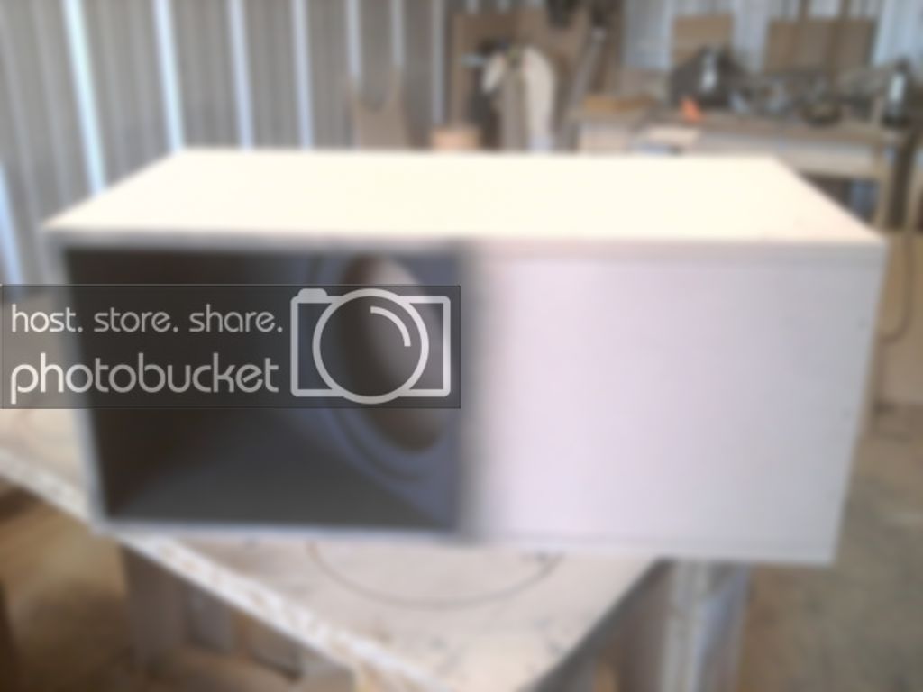

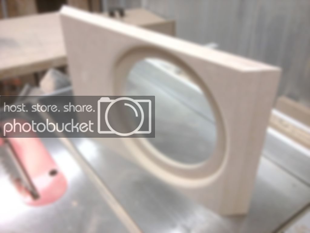

Making the piece for the end of the port...
I got more done but no pics due to battery
More when it happens...

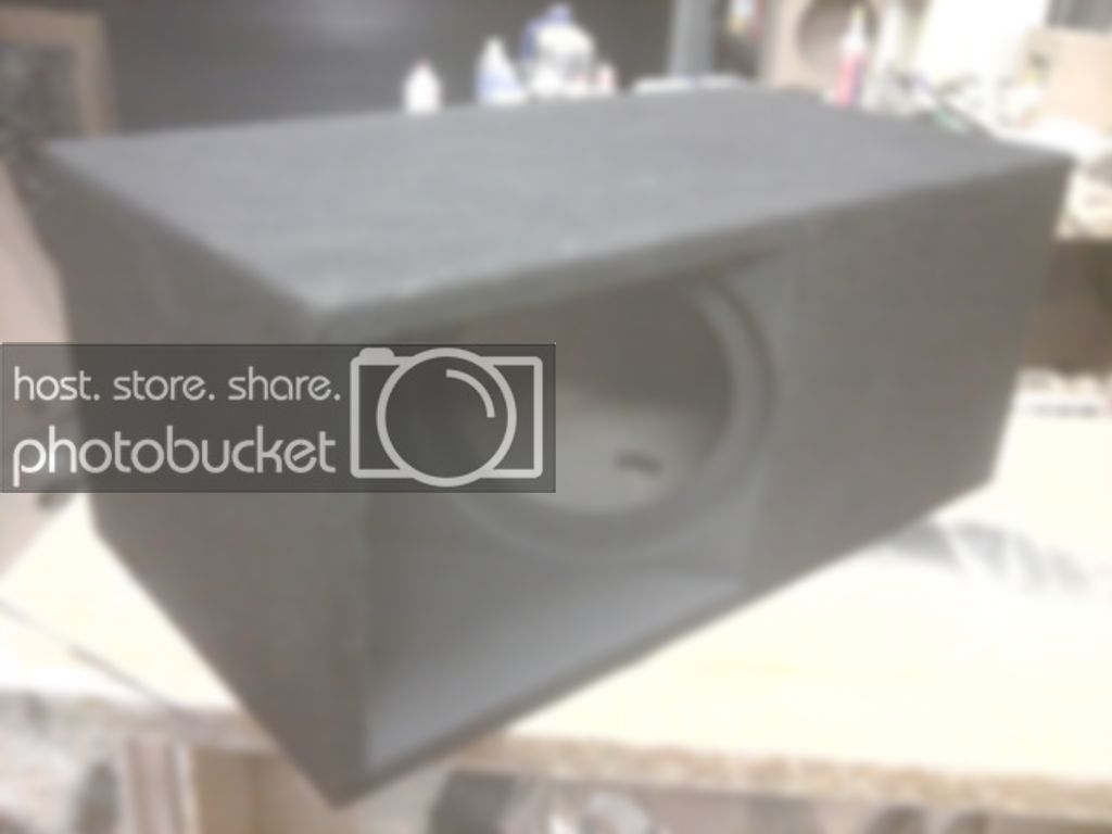

When tuning the box and finding the length of the port, where do you stop measuring? At the end of the baffle (toward the inside of the box), or at the mouth of that big opening?
Thanks, 30
And you would have your theoretical port length come out from the where the port begins getting larger, not all the way out but not all the way to the back either.
It's mainly a different look, keeps it more out of the way, and the layout seems more 'directional/flowing' in my mind...placed in the rear-driver's side of a trunk it should load nicely and play well.
