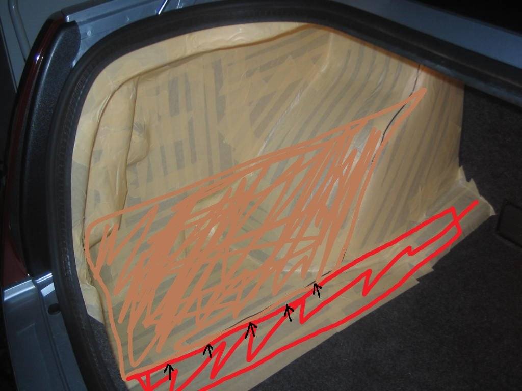

I plan on building a hybrid fiberglass rear and bottom, mdf/birch front/top enclosure for my 2012 wrx. The main reason for this post is because I've found very little info on fiberglass ported enclosures online. I'm pretty confident in my abilities to make one of these enclosures even though it may be a little difficult (from what I've read).
I'm going to be installing a 10" RF Punch P3. I'm currently mocking up a design with cardboard.
The most feasible option in my mind is a 3" round PVC port that has to be just under 9" according to a couple online calcs. The final box volume I'm aiming for is going to be around 1.6 to 1.3 cubic feet, and I am aiming to tuning it to 35 Hz.
A couple port exit ideas.
OR
I've read that having that 90 degree bend is going to hurt airflow. I'd like this exit because in the second design, the airflow from the port would most likely cause unwanted noise/vibrations from my privacy cover that would partially cover the port. I like the second design because it would be an easier install and I could just buy an aeroport and not have to flare the ends of the pvc after the 90 and making it flush and all that...
I haven't been to the store to see if a 3" 90 bend would actually fit in this space yet.
I guess the main purpose of this thread is to bounce some ideas around and see what's feasible.

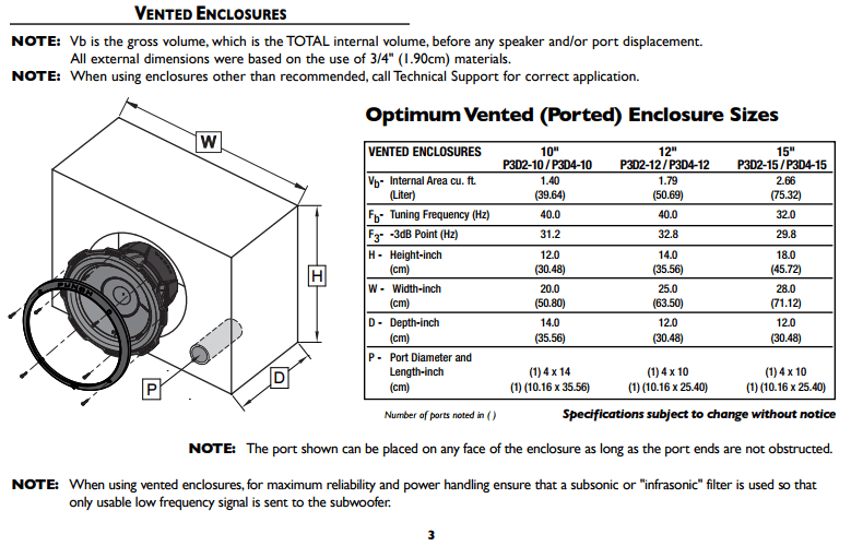

3. Per RF specs a 1.4 cubic foot ported box tuned to 40 Hz is recommend. I plan on staying in that cubic foot range but I would like to try to get more output on the low end hence me aiming for 35 Hz. Any input on this? From what I've read most people usually tune lower than the manufacturers specs but usually don't tune lower than 30 Hz. I figured my lil 10 should be fine around 35 Hz //content.invisioncic.com/y282845/emoticons/laugh.gif.48439b2acf2cfca21620f01e7f77d1e4.gif

I still haven't really found a clear answer on how to bond fiberglass to MDF/Birch. Most say the resin bonds well to MDF (not sure about birch). But when I place the MDF on top of the glass base, should I screw the fiberglass to the MDF from the bottom? Predrilling of course as to not crack the glass. I'll use some liquid nails or construction epoxy as well just cause I'm paranoid. And of course going to lay more glass on the joint inside the box. I can see myself throwing everything in the trash if I get everything together and the MDF ends up separating from the fiberglass. //content.invisioncic.com/y282845/emoticons/*******.gif.a649d21efc0d1fd4890a6428166586c1.gif
