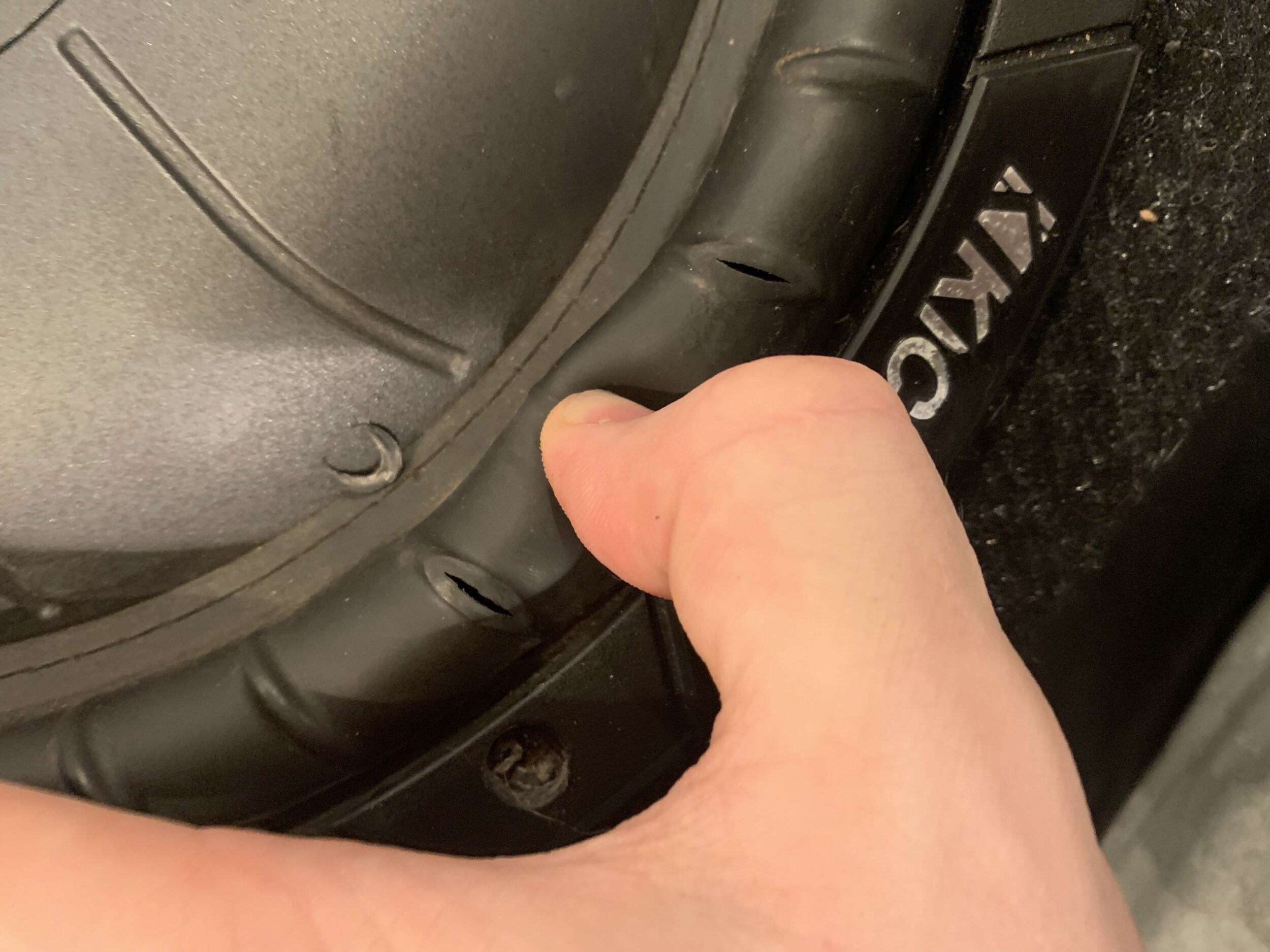

Found why it is making that weird ass noise. After I found this I punctured a hole on the other side of the woofer trying to get it out lol
Now I know this definitely means I need to get rid of these. All of those little ridges look similar, very worn out and ready to rip. So I will sell the sub and this one too I don't know what a ripped sub is worth though.

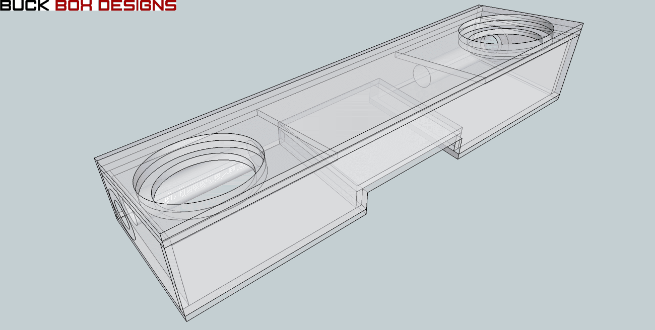

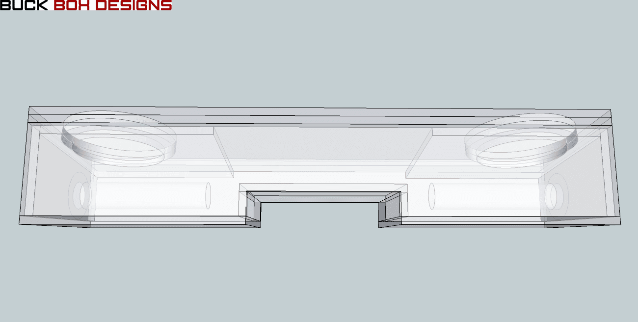

Yes, I have. I've done some insane underseat boxes lol. @LsGuy knows.
The problem is fitting larger woofers in that space, at any angle. So, check this one out, I did this one in 2013. It's two Alpine Type S 10's:
31795
31796
If you can find a non-shallow woofer that's a 10, and has a lower mounting depth, and maybe wants a smaller box, that would be my recommendation for the best sound.
I can design whatever shapes you want. I'm not a magician, though. I can absolutely help you figure out what I think will maximize your output with your situation, you can email me at: buck.box.designs@gmail.com
We can get your space figured out first, which is always #1, before you buy any further equipment. I can tell you exactly what you can and cannot do, IMO. So, just let me know. I have fun doing this :)
