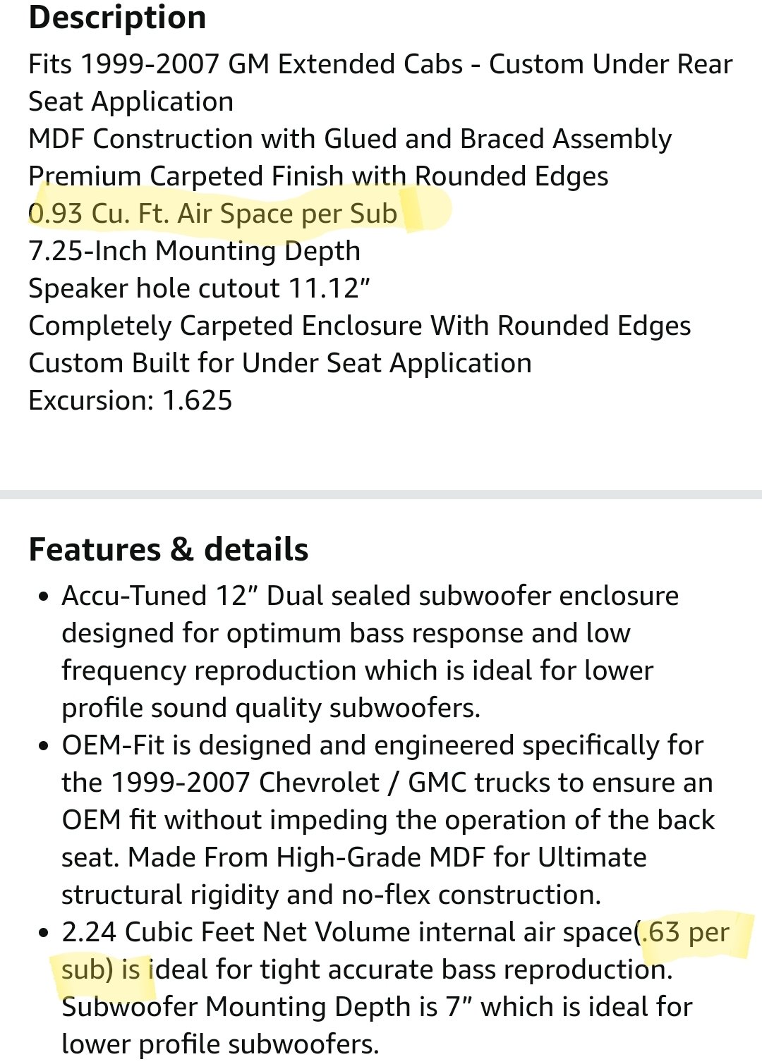

I bought this box https://www.amazon.com/gp/product/B0052QDQP8/?tag=caraudiocom-20 it says that it has a net volume of 2.24 but then it goes on to say .63 for each sub. How is that possible? I must be missing something here because I don't get how you go from 2.24 to .63?
Next question, did I screw myself buying this box? Because if it really is .63" for each sub then how the hell do you fit two 12s in there and actually have them sound nice? After blowing one sub I'd like to change my whole set up and make sure I do it right this time.
Their is a typo on Amazon. If you look at the manufactures website they list the airspace at .93 cubic feet. Which is still not enough for most 12’s. You would be better off looking at 8’s or 10’s for that kind of space.

It has both numbers! Typo is the correct answer.

Actually you know what. Bobby you are way more intelligent than I. A single 12" covering the other hole gives me 2.24 cubes I guess according to the website. Is that reasonable considering the shape of the box? Would the shape of the box cause the sub to be restricted in anyway? Now on the opposite end of the spectrum would a sub that is said to fit in like a 1.5 cubic inch space still sound okay in the larger space or would it **** ***?
