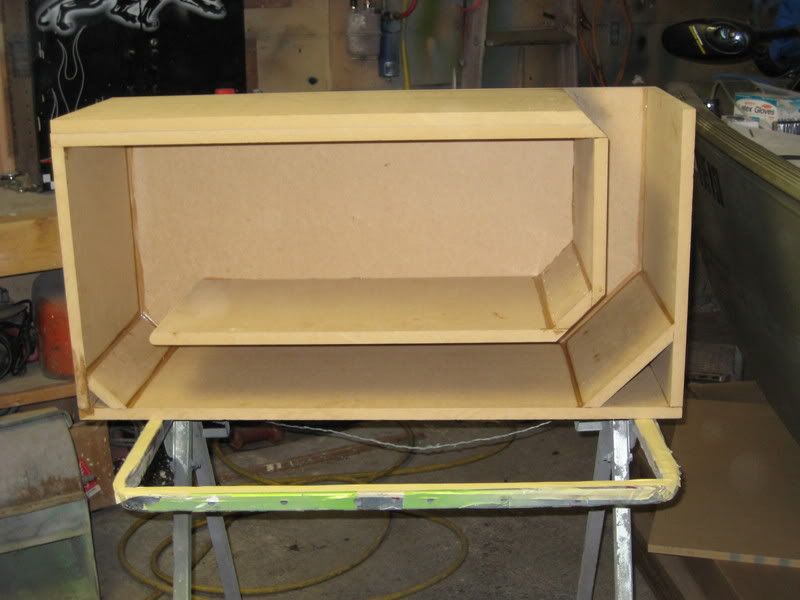

well take a look for yourself... i dont do shitty work..

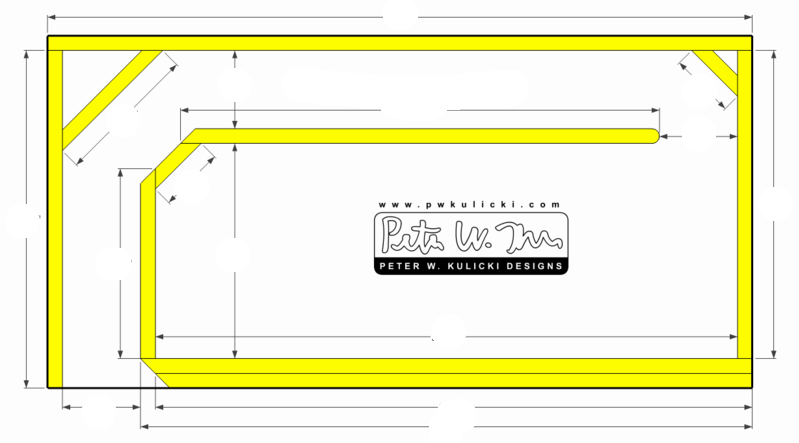

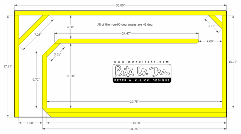

thats why i posted this box before it gets built. does it look to big?? tuned to low?? amp will be a audioque 2200d... anybody //content.invisioncic.com/y282845/emoticons/confused.gif.e820e0216602db4765798ac39d28caa9.gif
The design doesnt look like anything to complicated. So I dont see why it wouldnt work
well the above box is the second pwk i built it, it was a pain in the *** tore out the spiders overexcursion like a *****. it either was weak or overexcursion, i set the subsonic where pete had told me too we went over everything the design was ....FAIL. it was ran off a kicker 1500.1 now off an aq2200 in 2.5 cubes 35 hz it does just as well , doesnt get down like the pwk but the woofer also is still working !

when you get off petes ****.. read the mother f@#$ing thread!!! many others had the same problem, and theres pics above of the box . i checked that box many times its exactly what was on the blueprints.
Dude, the problem is that you built it upside-down!
I bet if you had built it right-side up it would have worked perfectly!
//content.invisioncic.com/y282845/emoticons/crap.gif.7f4dd41e3e9b23fbd170a1ee6f65cecc.gif//content.invisioncic.com/y282845/emoticons/confused.gif.e820e0216602db4765798ac39d28caa9.gif//content.invisioncic.com/y282845/emoticons/veryhappy.gif.fec4fed33b4a1279cf10bdd45a039dae.gif//content.invisioncic.com/y282845/emoticons/wink.gif.608e3ea05f1a9f98611af0861652f8fb.gif//content.invisioncic.com/y282845/emoticons/greedy.gif.5a53e6246569d7ab79867170f3b06629.gif//content.invisioncic.com/y282845/emoticons/crazy.gif.c13912c32de98515d3142759a824dae7.gif
**** it!! how the hell did that happen? i better rebuild it right side up!! **** ima fool thanks:laugh://content.invisioncic.com/y282845/emoticons/laugh.gif.48439b2acf2cfca21620f01e7f77d1e4.gif
