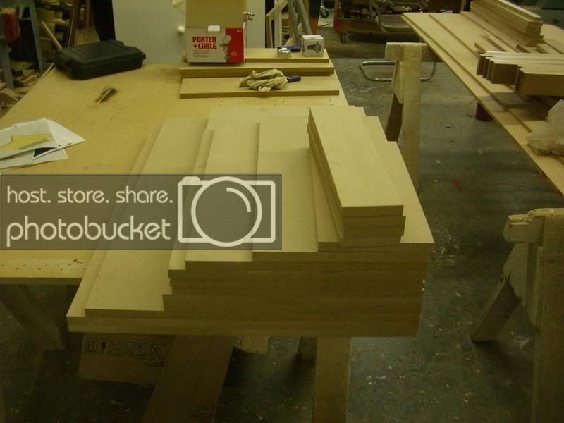

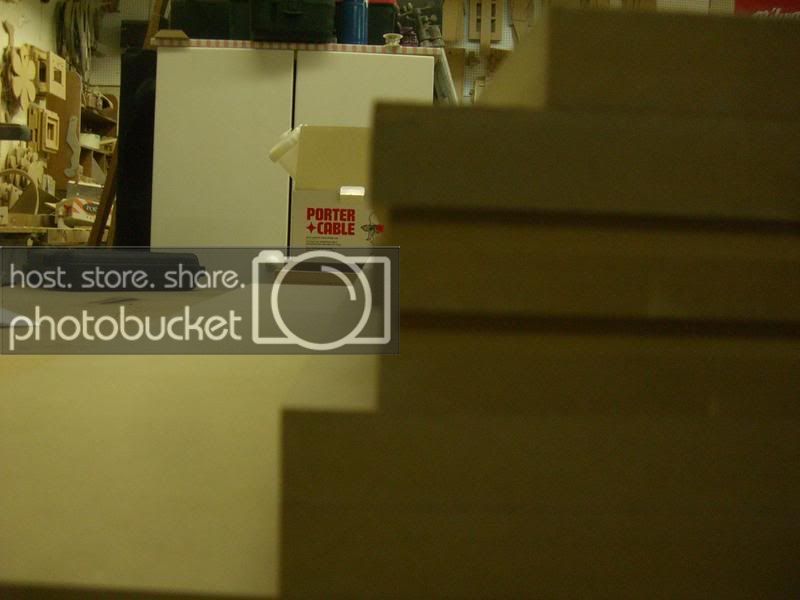

I just made some cuts. But in regards to the blade. It really doesnt matter because as soon as you cut mdf. The blade dulls. same with router bits. Ive used the same router bits on every box and so far havent had a problem same with the blade. That blade has been to hell and back we have put that thing through some hell. well here are the cuts.
I can't tell for sure, but just by looking at what you posted, it seems as though your groove will be a little too narrow. I don't know for sure though. I always aim for 3/16 to 5/32 or so. Below 1/4", but a little wider than 1/8".
