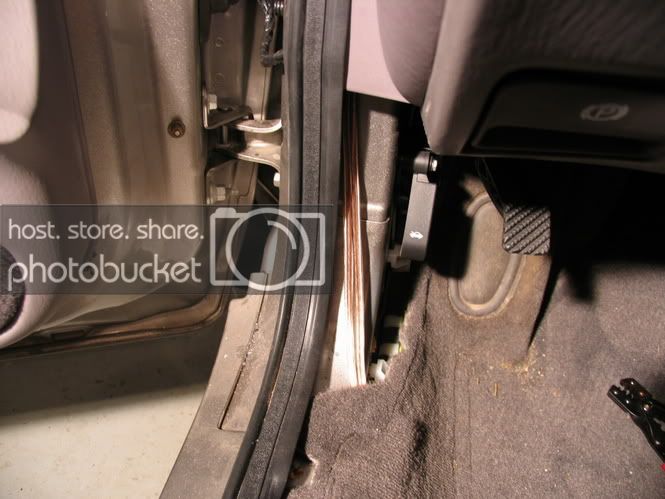

Does anybody know how to put speaker wire through the door of a Neon? Cause I tried putting to through the rubber piece in the door but theres a connecting piece for my power windows and that. I was about to rip the door off cause i'm getting pissed right off.

you are going to hate me for this, but that plug tha you speak of, has some empty plastic "plug holes" in it. and all you gotta do is use a drillbit and drill a hole thru the empty spot (of course you take the boot off the other side to make sure you arent drilling into some wires or anything at all sides that plastic for that matter.
usually thats all there is to it.
