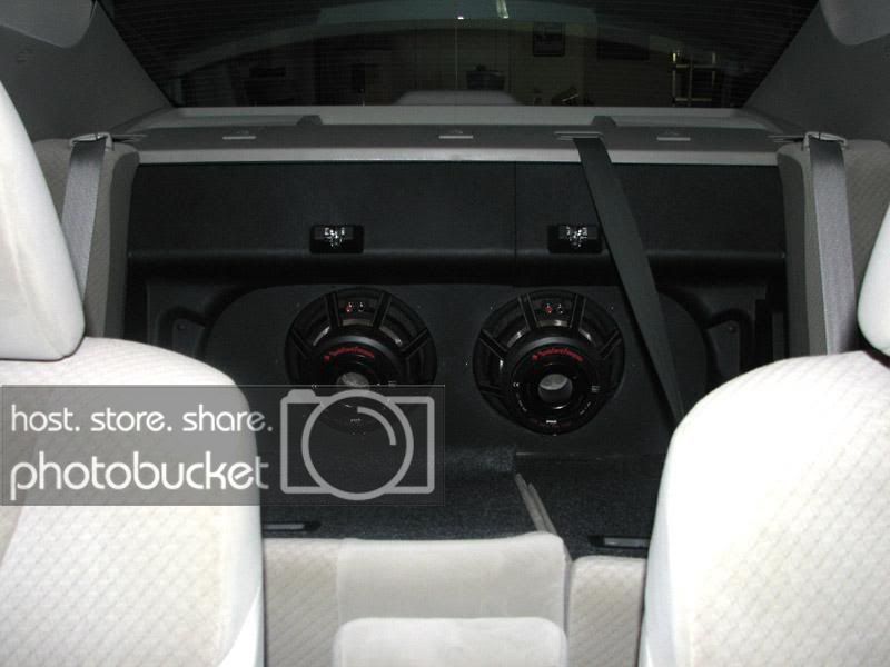

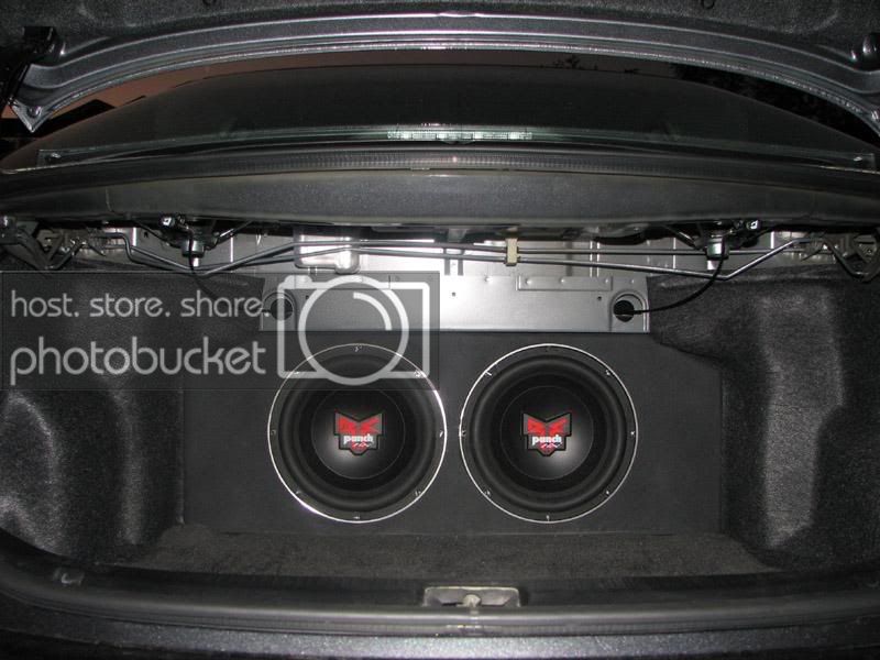

Didn't get too much done this weekend. Just got the baffle board built and test fitted it. 1.5" thick, flush mount. I am really going to like the look of the inverted IB in here.

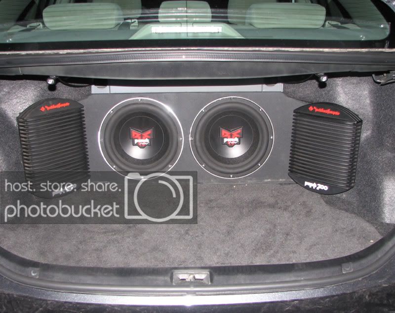

Not a big update. I just made some simple MDF mounts for the amps and installed them to check fit. Nice and simple.
This weekend I will remove the amps and baffle and rid the trunk of carpet and plastic, so I can start covering holes.

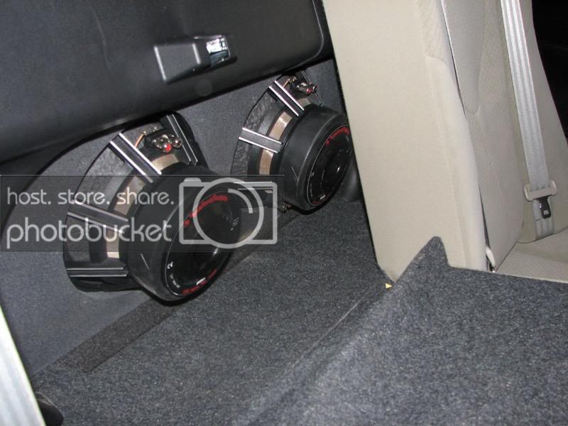

i know absolutely nothing about IB installs, but wouldnt keeping the rear seats up create almost a leaky sealed box in this install? or will the rear seats always be down...or am i just wrong about all of it?

When I am driving the seats will be down. The seats won't seal up that much where it will affect too much. Plus the backs of those seats are riddled with holes for the pressure to go through the fabrics. It would act more like an Aperiodic Membrane if anything. It is hard to get true IB in a car to begin with. It is just called that for lack of better terms. Most trunks generally don't supply enough volume to be considered true IB. Close enough for me though.
