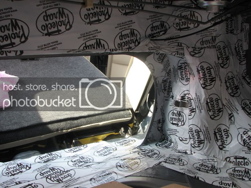

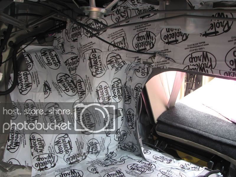

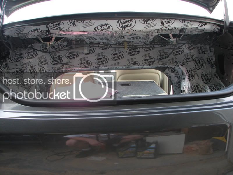

The car is pretty quiet already and it is a lease, so no to all the deadening of the cabin. In the trunk I will seal all holes leading to cabin with some cheap butyl based roofing sealer and apply it over the sheet metal the baffle is attached to. Other than that, f it.

Flame if you all want. This wasn't meant for deadening. I wasn't spending good money on deadening for a lease in the attorneys name my wife works for. This was only done to seal as much of the trunk as possible from the cabin. This stuff is butyl and may have some deadening characteristics but it is so thin that it will be minimal. It sticks great and is easy to form. It is also cheap. It did what I wanted it to.

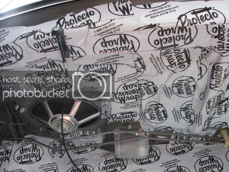

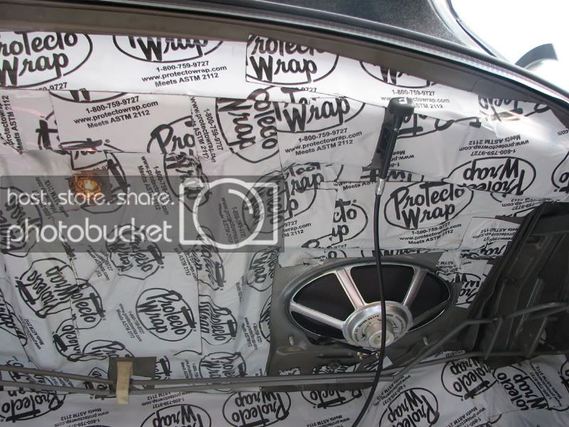

IB and you still have speakers in the rear parcel shelf? Bad idea.

Speakers in deck: This install has just gotten started and I haven't made a decision on that yet. They won't be powered thats for sure. I thought of leaving them there to keep a seal, but understand they may act like a PR if there is enough pressure in the trunk. If it causes a huge issue, then it is an easy fix.

Use Protecto wrap under any circumstance. It is an apparent waste of money. While the initial stick is great, it quickly wears off and I have pieces peeling and coming off on their own. They use this on our homes? This shit is proving to be worthless.
