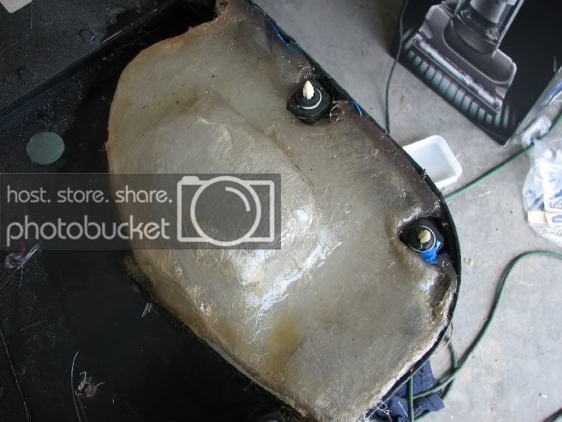

So I started by cutting up the door panel where I plan on having my speakers mounted. Then put down some tape on the door behind the panel and put down 2 layers to start the mold. Here is where I am at. Waiting for this to fully cure so I can remove the door panels and finsih building them up.

Anywho I put another layer down on the back cavity.

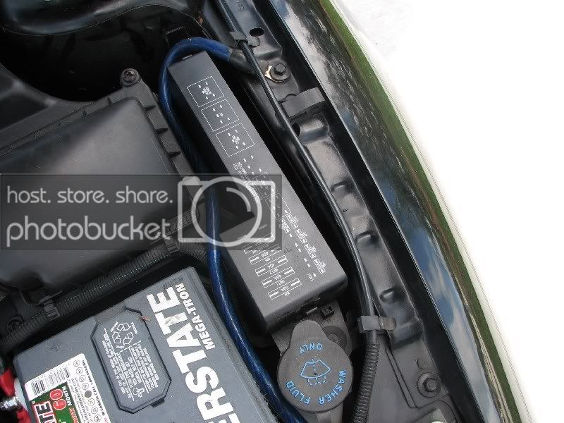

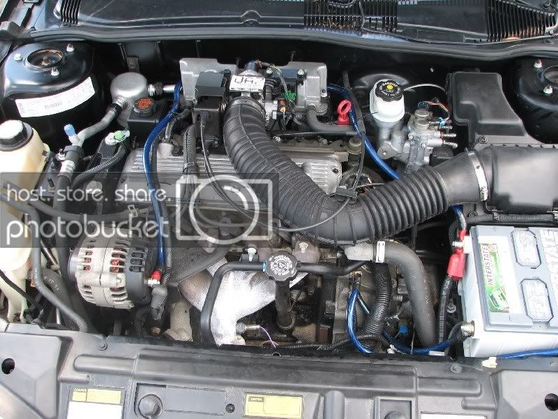

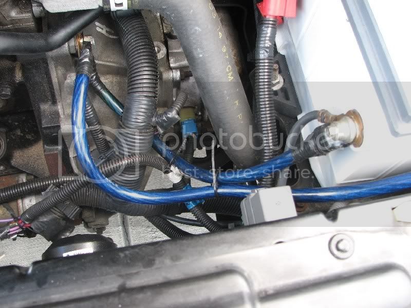

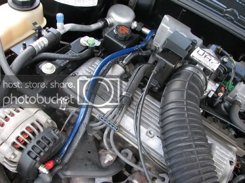

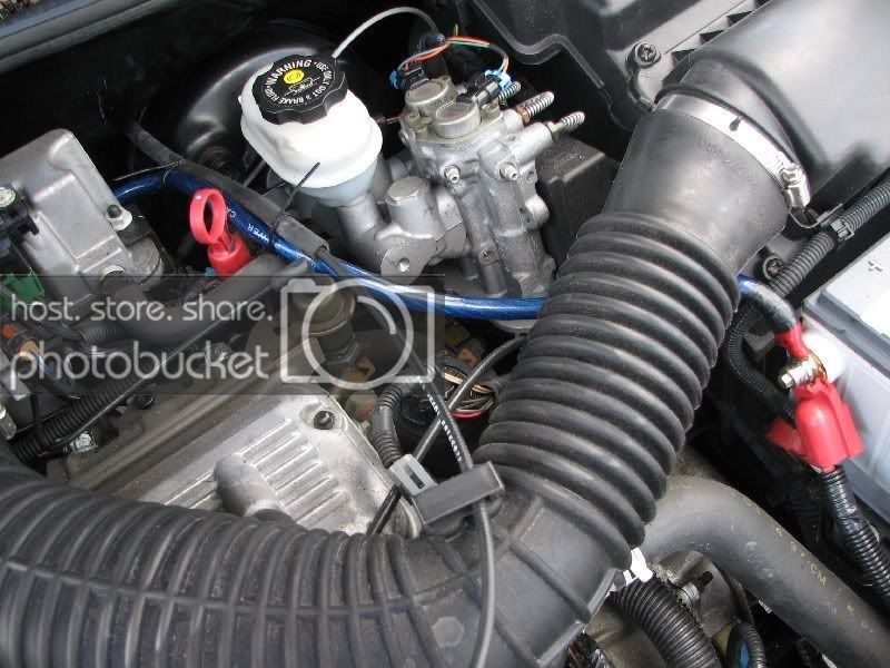

Then while it dried I went ahead and did the big 3 for this car. I believe I will need an alt down the road and I know I will be getting a yellow top. The alt is only an 80amp.
