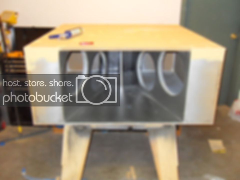

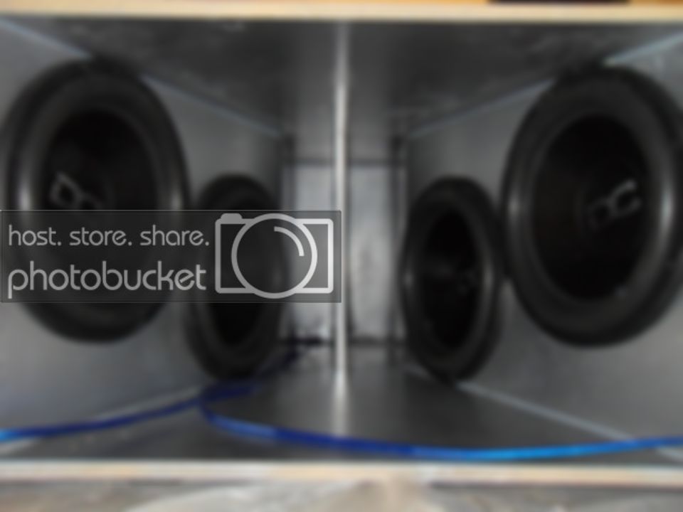

its a bit of a hybrid style box. Essentially you can model a box like this as a ported box, but in the case of my vehicle, modeling the box as a series 6th order with the clamshell being a chamber is much more accurate in terms of computer modeling.
With my last box, which was a "ported" box tuned to 33hz, i peaked at 29hz. When that box was modeled as a 6th order, the math showed it would peak at 29hz, just as it did.
So, we took an approach as modeling this as a 6th order box just for vehicle response reasons. I wouldnt call this a standard ported box, nor a full blown 6th order due to the fact that the front "chamber" doesnt really have anything for port other than a beauty panel.

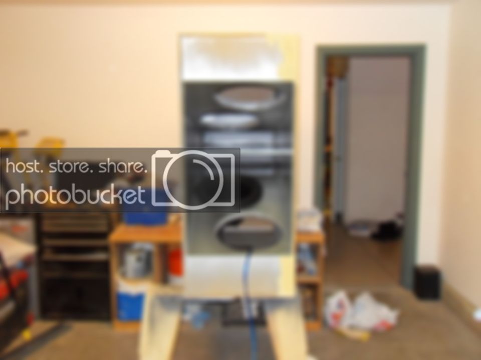

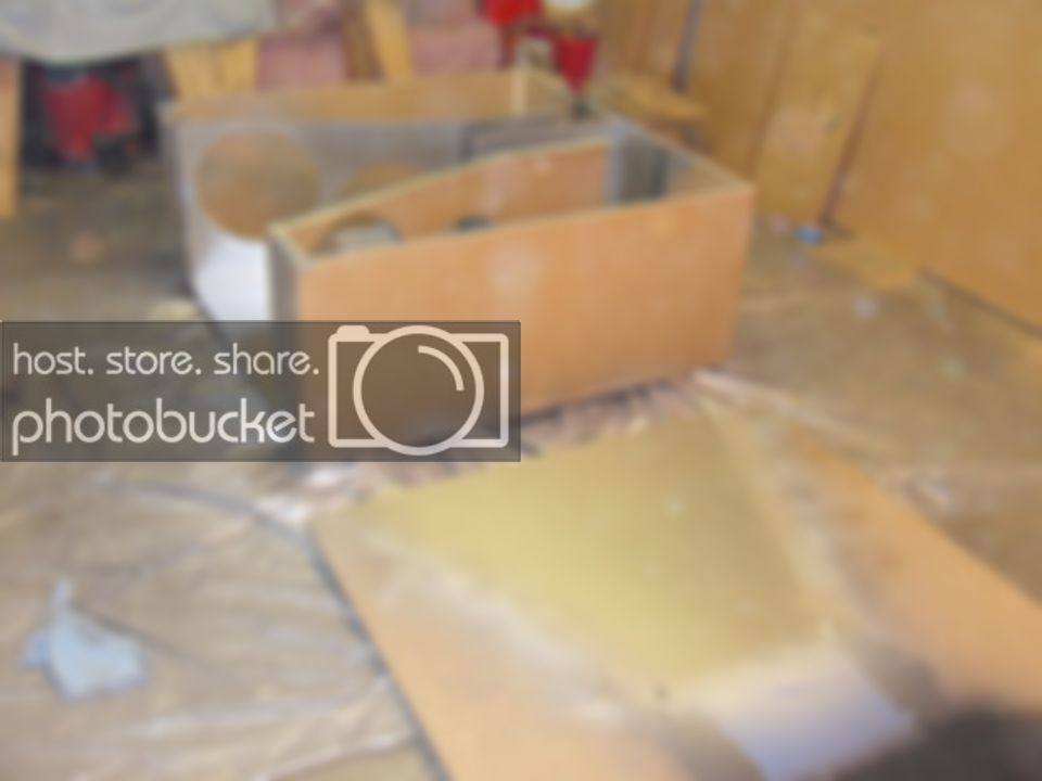

Starting to prime and paint the box now, pics up later.

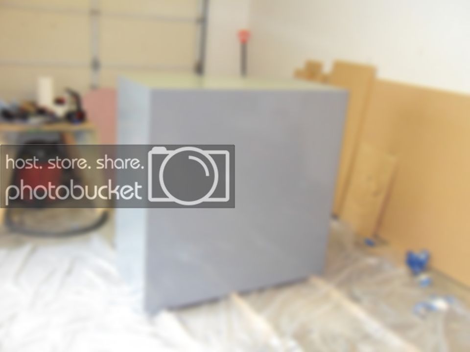

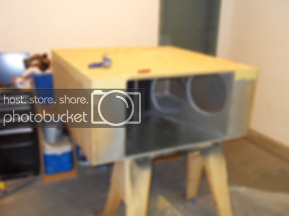

I just threw on the last of the silver, clear coat will go on when i am back from the gym. Pics up later tonight.

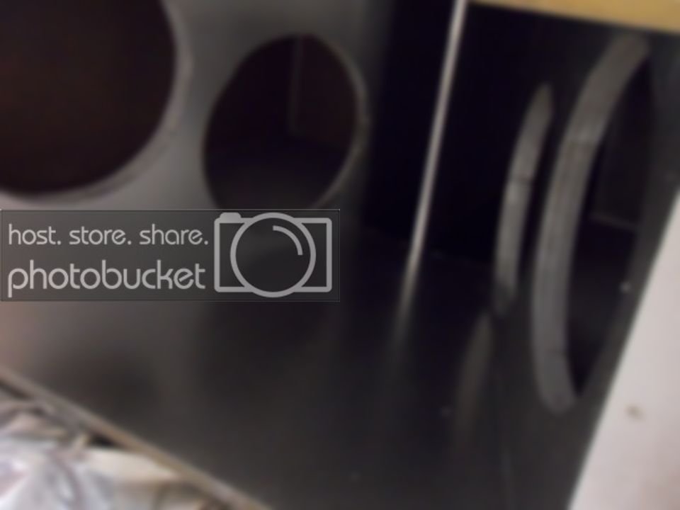

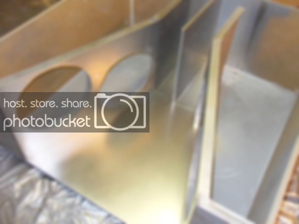

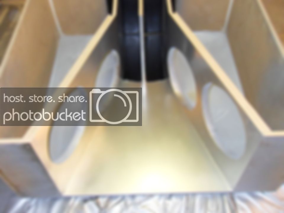

Lesson learned. Metallic paint doesnt like clear coat //content.invisioncic.com/y282845/emoticons/laugh.gif.48439b2acf2cfca21620f01e7f77d1e4.gif Even the lightest covering of clear would run on the metallic stuff, so i went back and touched up as best as i could. You can see in one of the pics how the clear coat would run. I went back over it with what i had left of the remaining metallic paint, and it came out alright. There is one spot right at the mouth of the box thats bugging me, but it wont really be visible when all said and done.
Other then that, it came out great! Some of the metallic paint seeped under the tape onto the black port, so i still need to go back and touch that up. Now i just gotta mount the top of the box on, put the subs in, and start playing in the truck rather than in the garage.
Almost looks like its not painted due to reflection

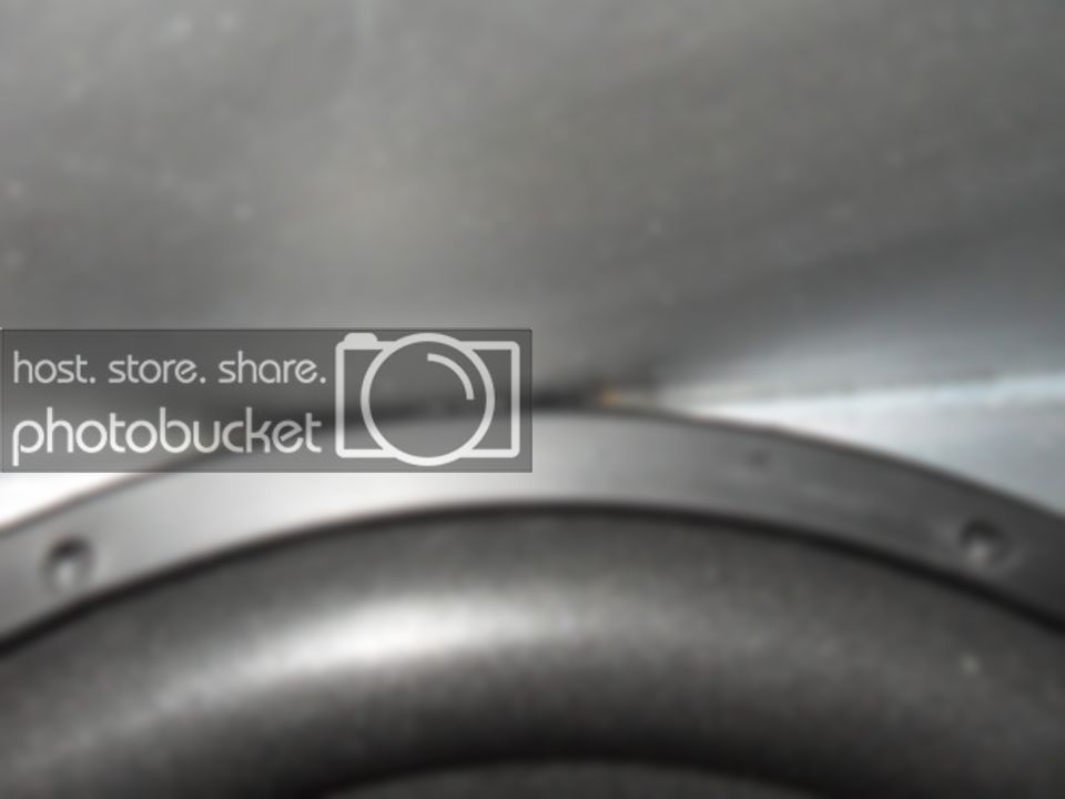

And here is an example of the running clear coat i was talking about, right in the bottom left corner of the pic. Luckily the beauty panel will hide this.

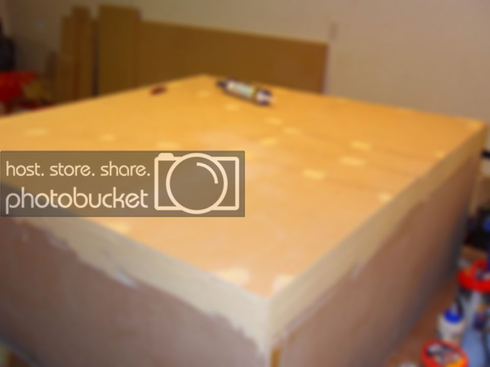

just put the top of the box on, waiting for the glue to cure, then i'll be siliconing the interior edges and painting the outside to seal it up from weather.

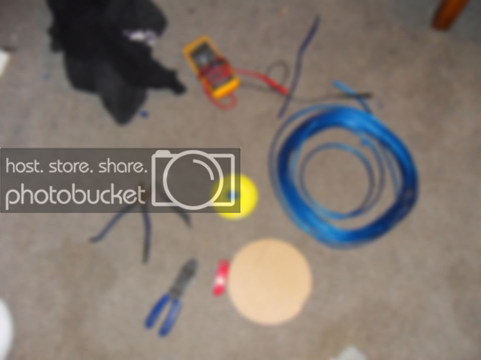

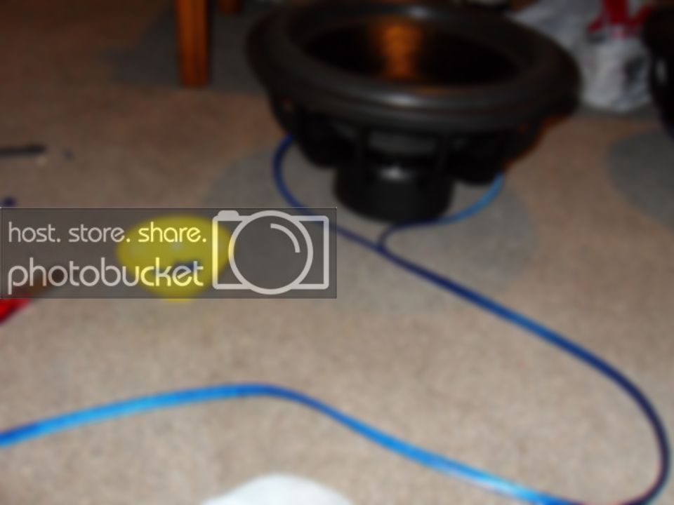

Also finished running most of the wire, still need to do the 1/0 runs for the batteries and amp underneath the truck, but as for interior wiring, its pretty much done. I only had to add a wire for the bass control knob and LED toggle switches.
