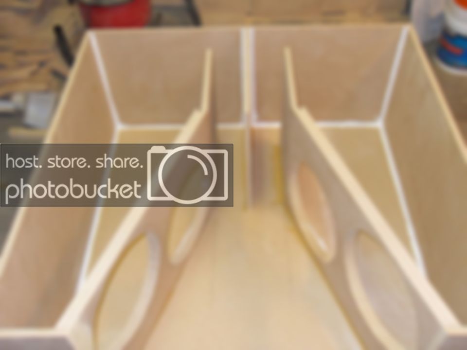

FINALLY a little bit of progress today.
I got a bunch of other crap done and out of the way today, including another truck i had to build a box/do an install for. Ssoo, other than a couple of homework assignments this week, i should be able to do a bit of work over the next couple days.

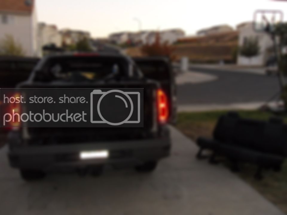

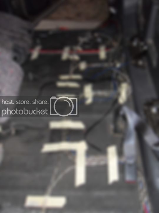

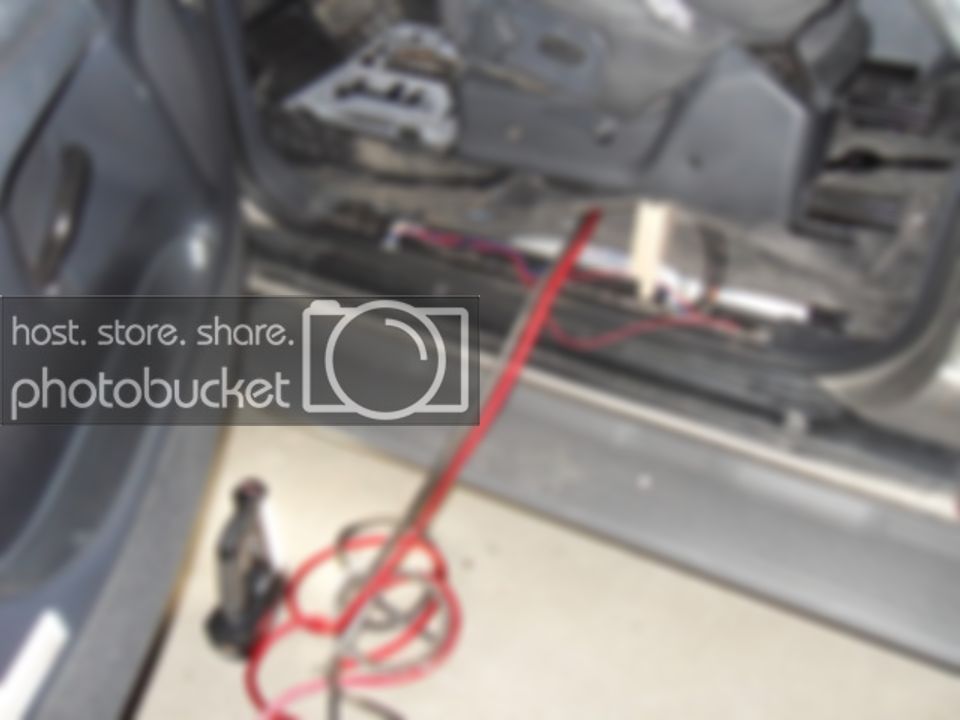

I pulled out the 1/0 that was still in my truck, as well as some other random wires that i didnt need anymore, and ripped out the back seat to get ready for amp rack/sub box stuff.
Heres a couple pics i snagged in the process.
The wiring still intact perfectly from when i put it in a year ago
Pulling the last remaining 1/0 fleks out
Cleaned up the garage a little bit

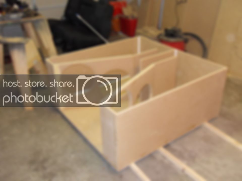

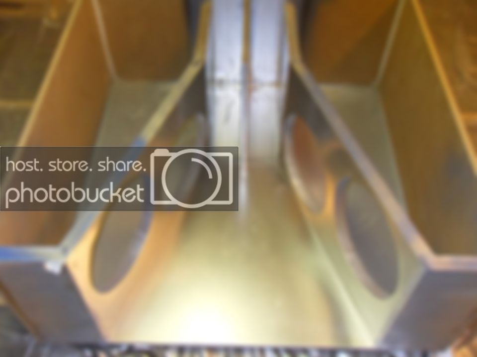

Caulking the sides before i put the top on and begin priming/painting.

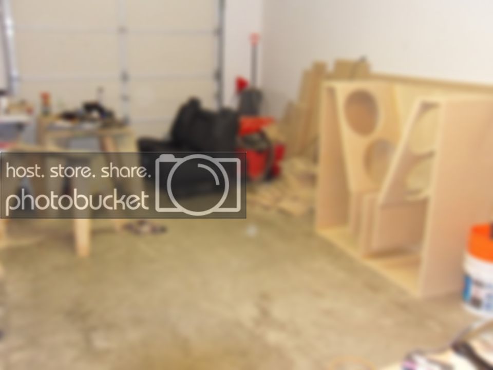

call me silly, but that doesnt look like a sixth order bandpass, but rather a ported box.
its a bit of a hybrid style box. Essentially you can model a box like this as a ported box, but in the case of my vehicle, modeling the box as a series 6th order with the clamshell being a chamber is much more accurate in terms of computer modeling.
With my last box, which was a "ported" box tuned to 33hz, i peaked at 29hz. When that box was modeled as a 6th order, the math showed it would peak at 29hz, just as it did.
So, we took an approach as modeling this as a 6th order box just for vehicle response reasons. I wouldnt call this a standard ported box, nor a full blown 6th order due to the fact that the front "chamber" doesnt really have anything for port other than a beauty panel.

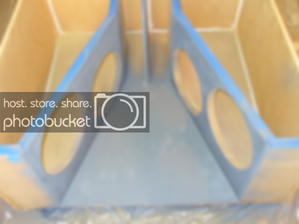

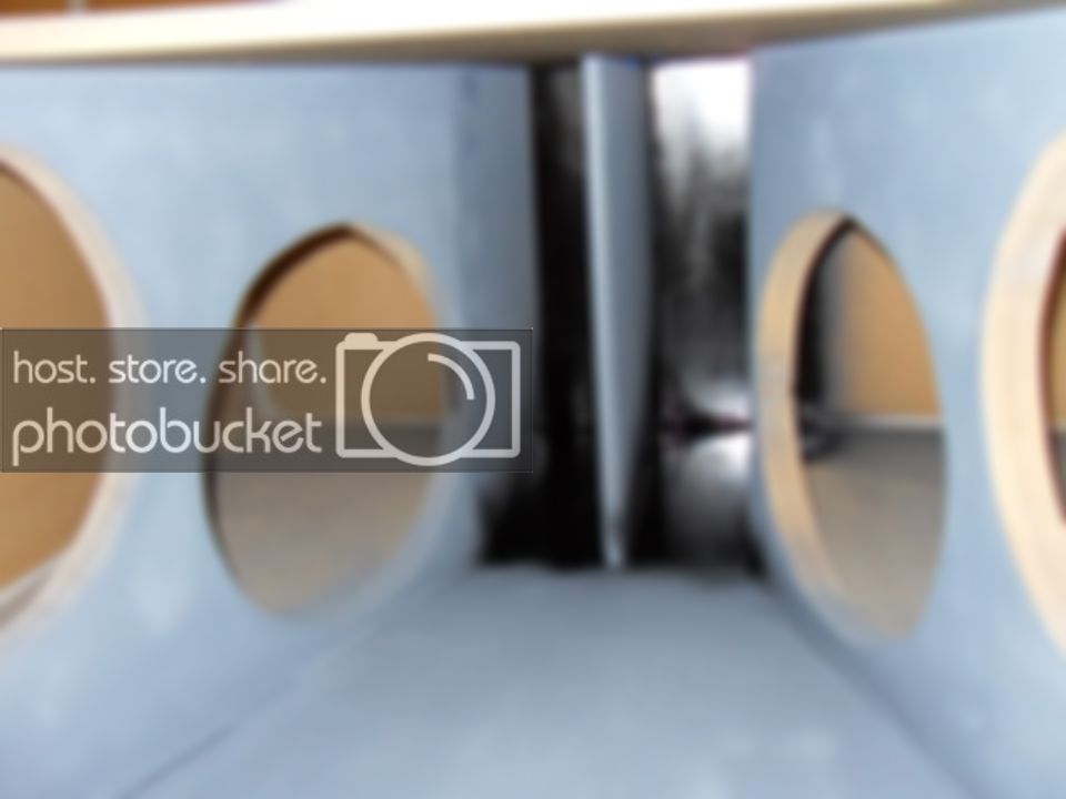

Starting to prime and paint the box now, pics up later.
well, i was just about to post up some pics...... but photobucket is down for maintenance.

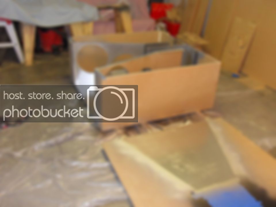

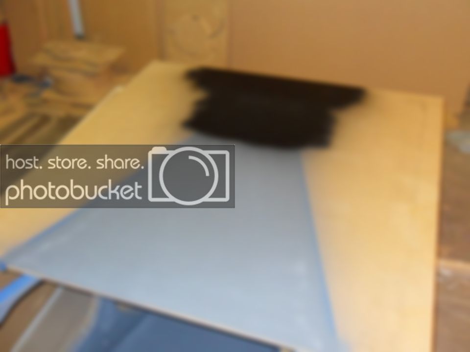

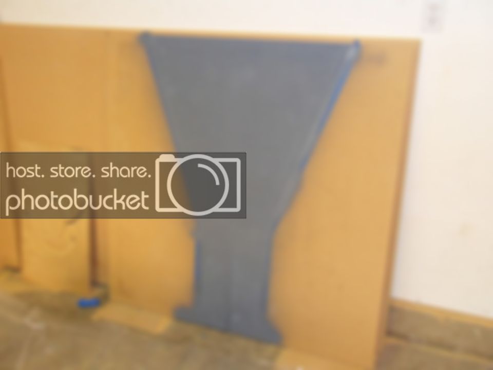

For paint, i went with a metallic silver for the box (which is turning out MUCH nicer than i thought it would) and the bottom/top/back of the port is going to be a standard black (the port sides will be silver)
I got the first few coats of silver on, and im about to go finish that up. Clear coat will go on tomorrow, then i can put the top of the box on.
After thats done i have to
-paint the outside of the box to seal it up from water
-mount up the subs
-put the box in and run wiring!
