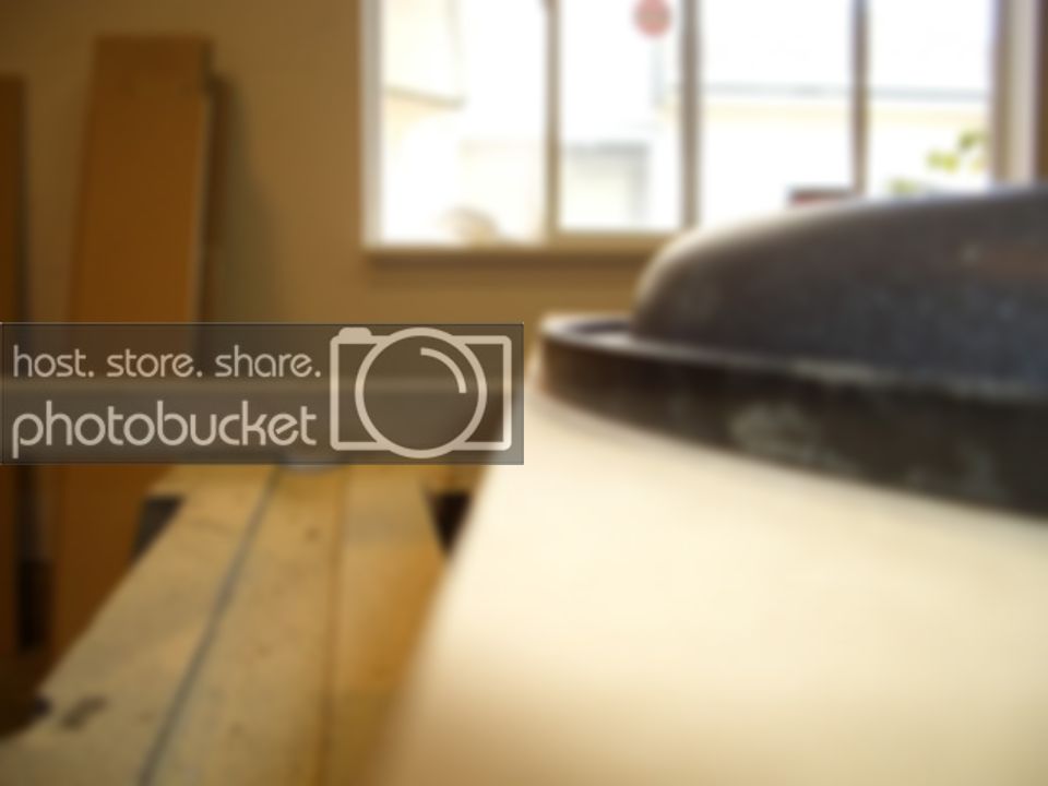

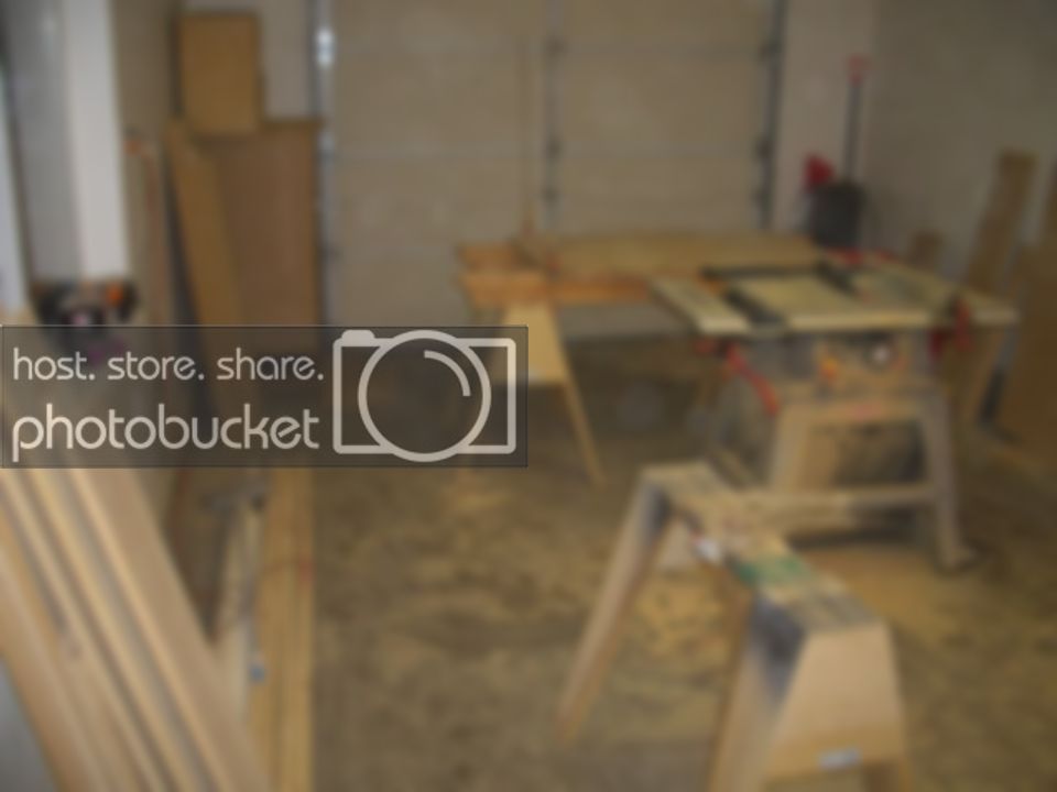

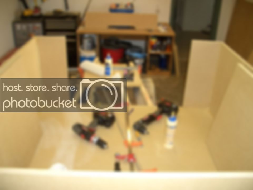

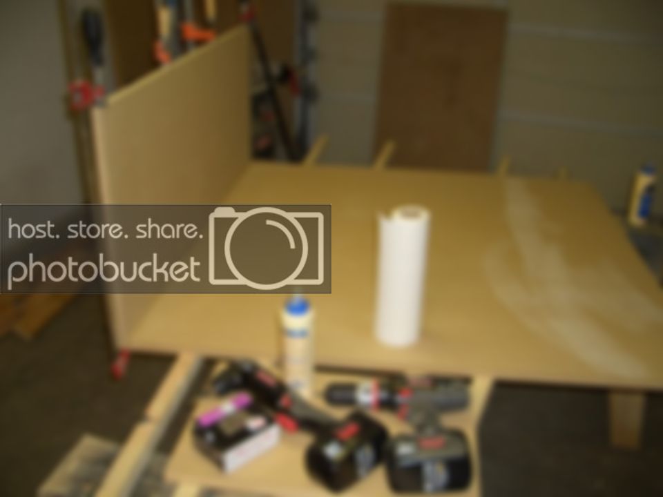

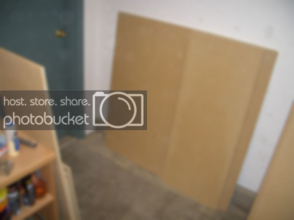

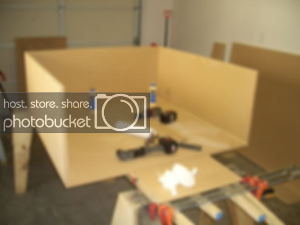

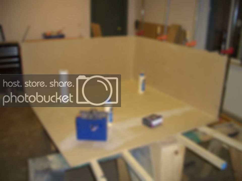

finally a bit of progress today. I got all the wood cut and started piecing the box together.
Nice and messy //content.invisioncic.com/y282845/emoticons/crap.gif.7f4dd41e3e9b23fbd170a1ee6f65cecc.gif
Table saws make angle cuts ssoo much easier

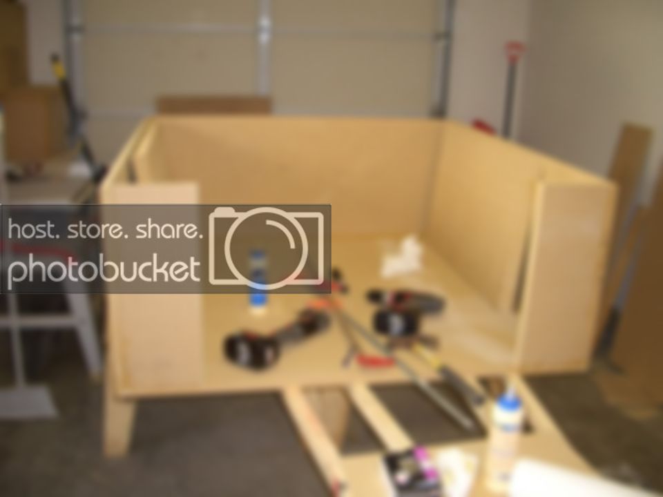

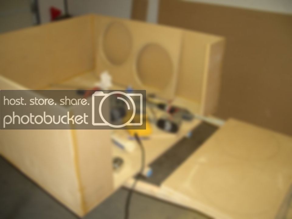

Got a little bit more done, but had to stop to study for a mid term i have tomorrow //content.invisioncic.com/y282845/emoticons/crap.gif.7f4dd41e3e9b23fbd170a1ee6f65cecc.gif

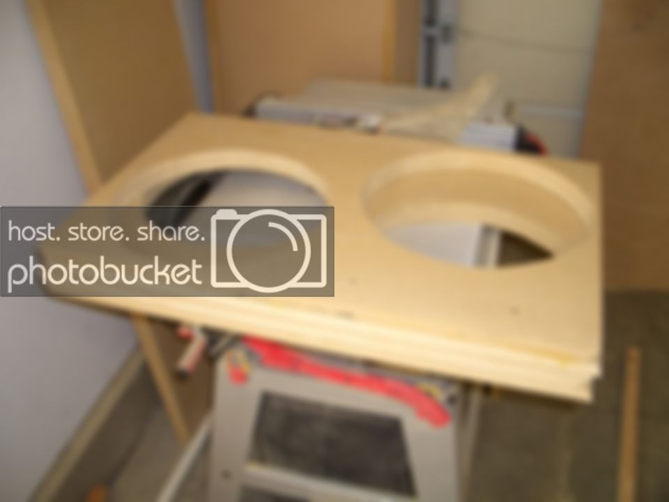

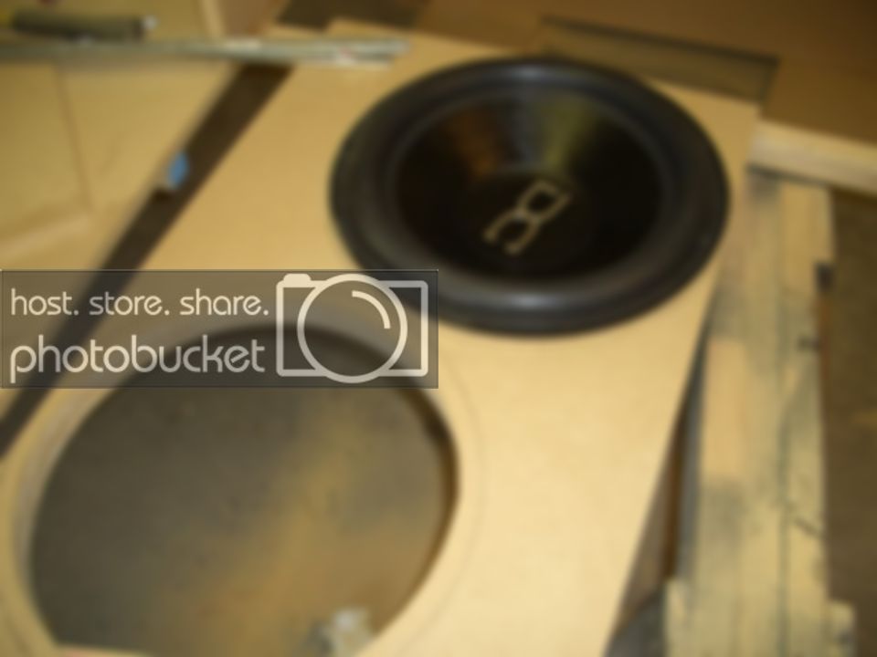

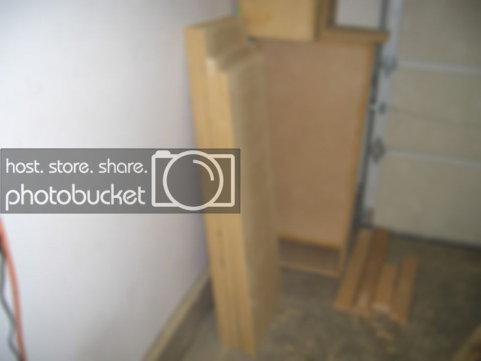

A little mock up. Very similar to the last box
looks like a tight squeeze on those subs
very.
If you look at the side of one of the sub cutouts, there is a gap. However, it wont be a gap because the port board slides right in there //content.invisioncic.com/y282845/emoticons/wink.gif.608e3ea05f1a9f98611af0861652f8fb.gif

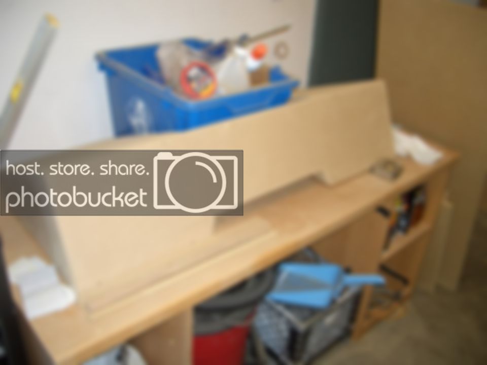

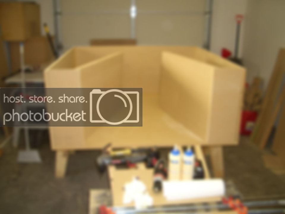

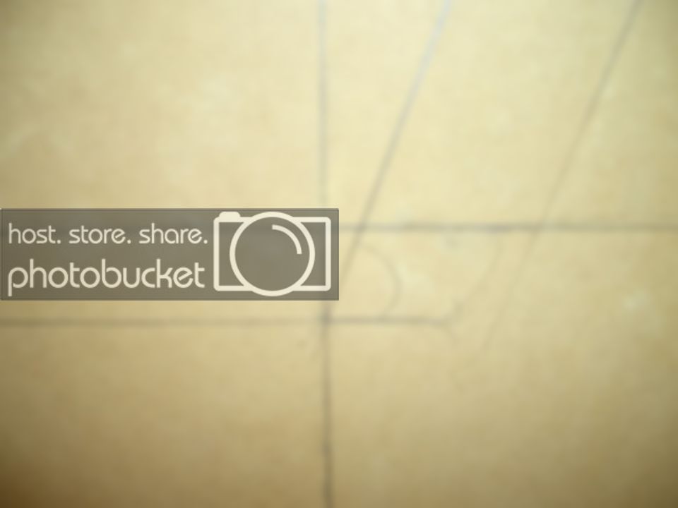

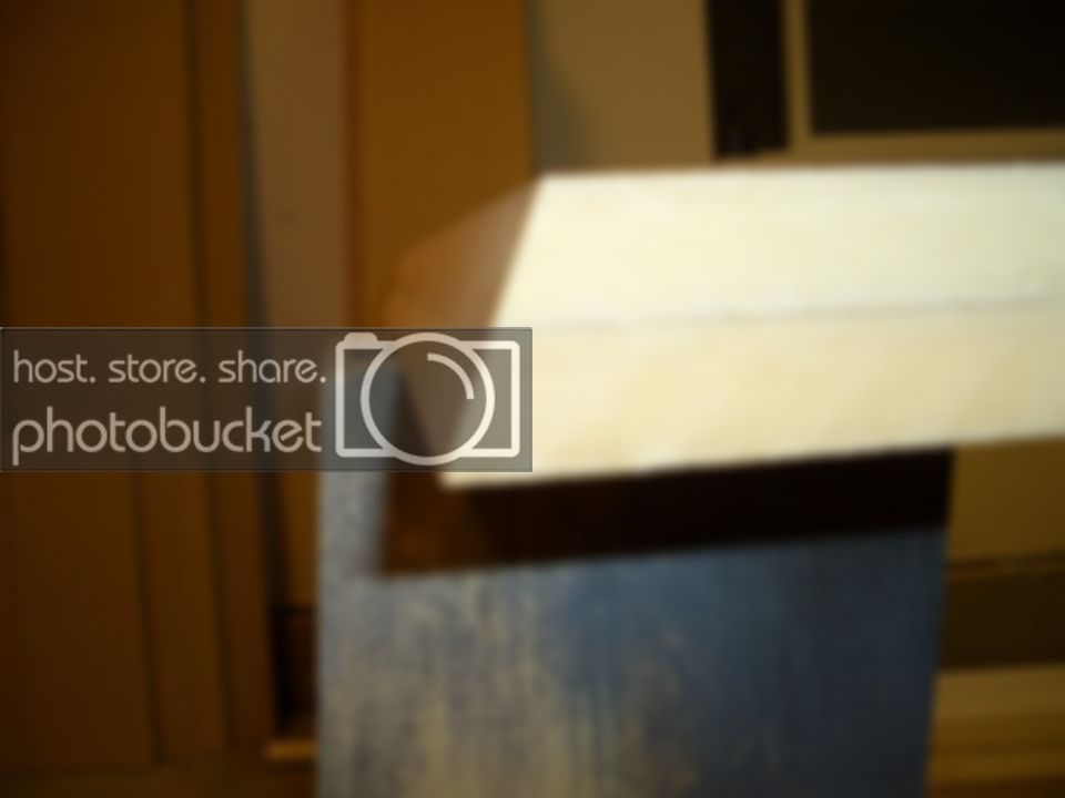

Well, it was going to happen sooner or later with this box. I ran into a little issue.
in order to get the subs to fit, i had to make the baffles about 3/4" longer. In turn, the port length sort of got reduced. Due to how the clamshell is in the back of the box, im not too worried about it and dont think it will effect too much.

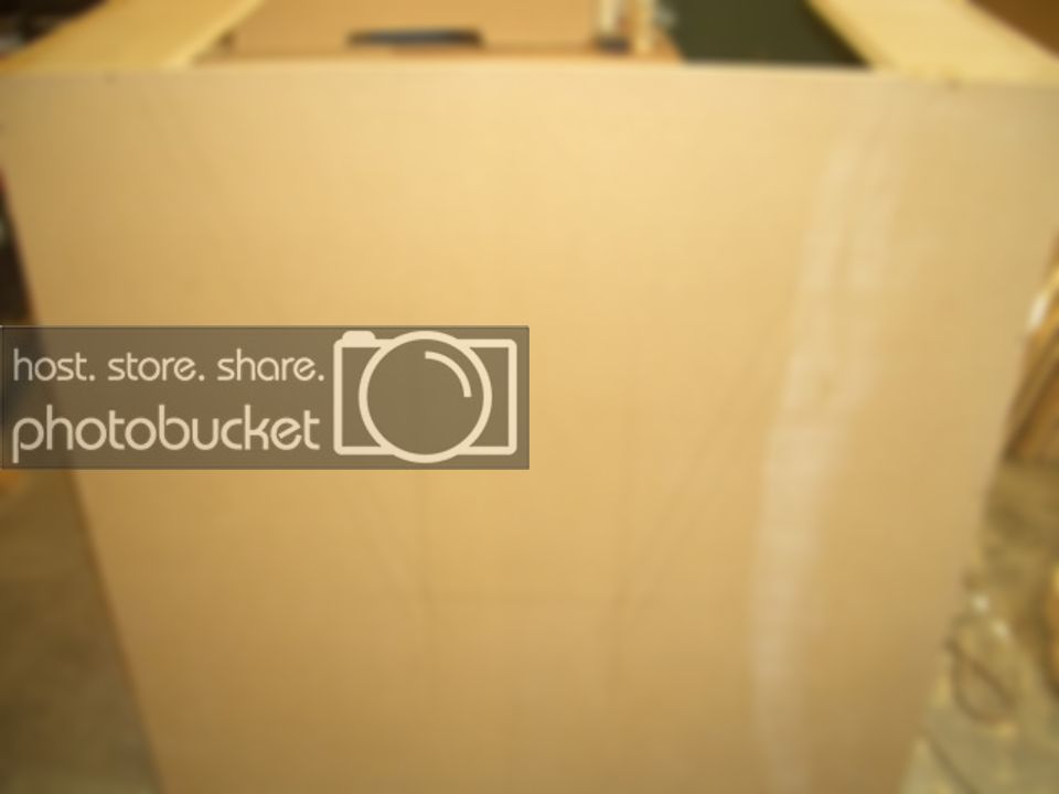

Here is what i mean. As you can see, the baffle extends beyond the first drawn line, where the port WAS going to begin, im making each port about 1/4" wider for the last 3/4" of the port due to the longer baffles. Im fairly certain tuning wont be effected really at all, due to the overall design, we'll see though i guess.

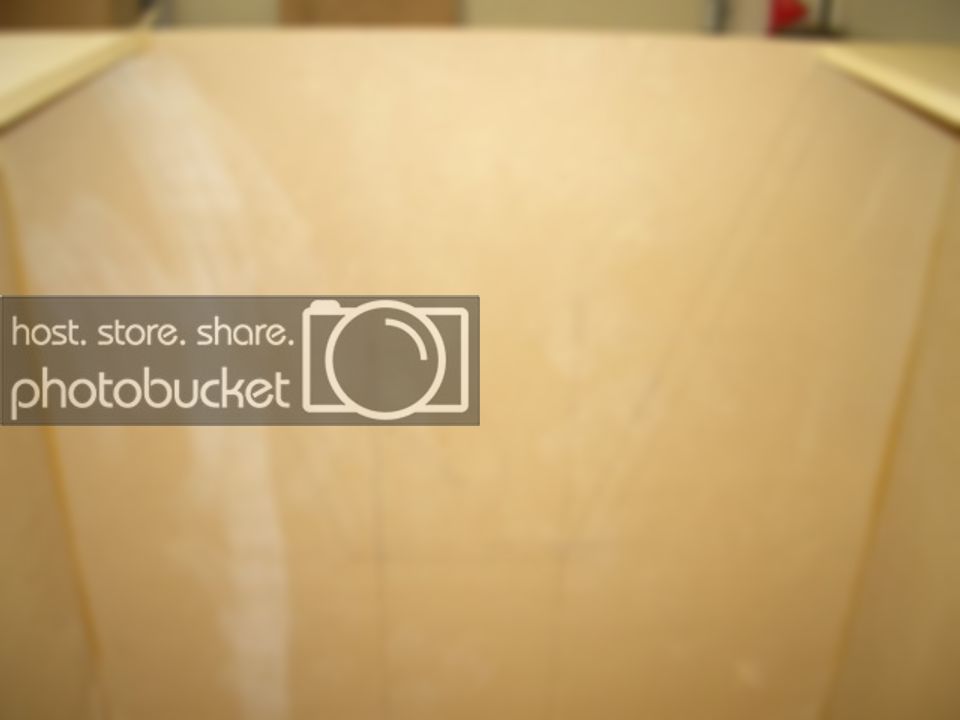

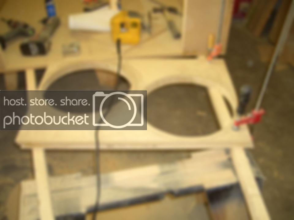

Here are the baffles cut out, ready to be mounted into the box
And lines drawn on the back side of the box to help me with screwing the baffles down

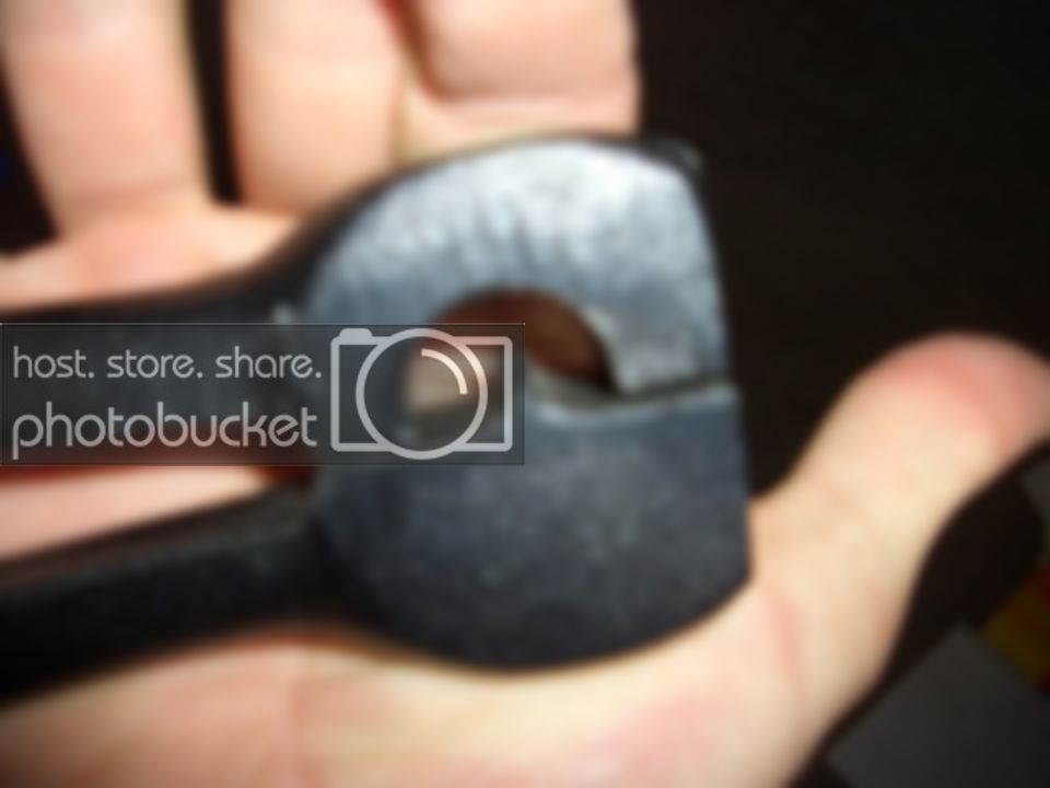

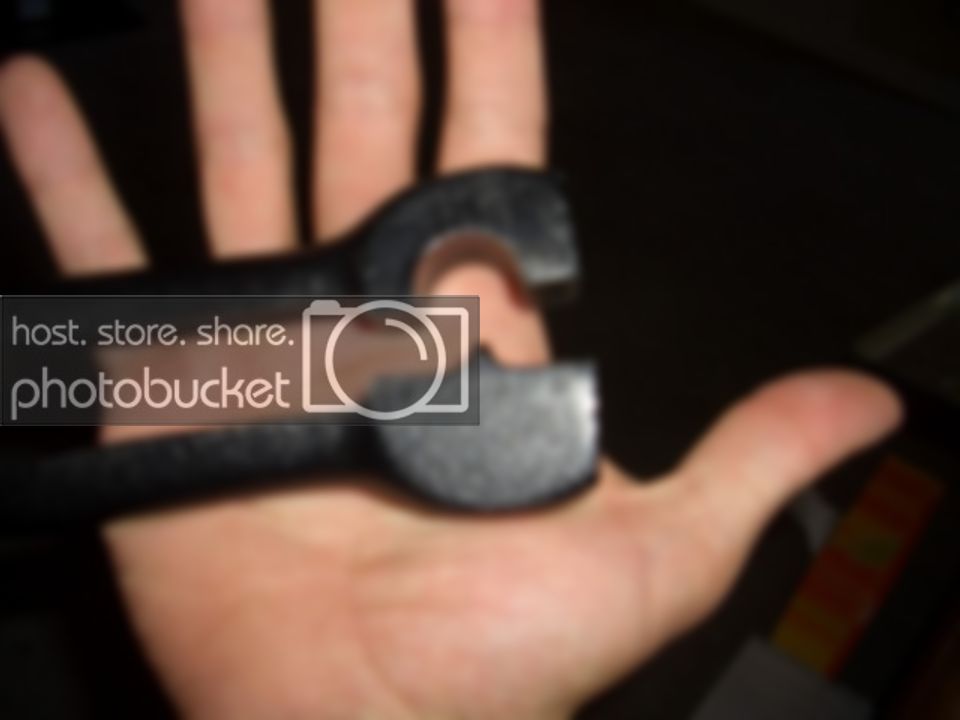

some more goodies in the mail today. A new camera since i put my other one through the wash, and a crimper
