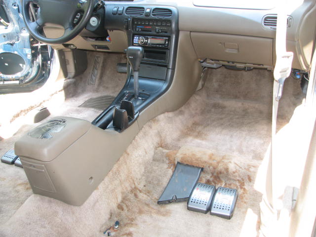

Also reinstalled all the interior except the door panels..

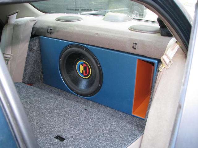

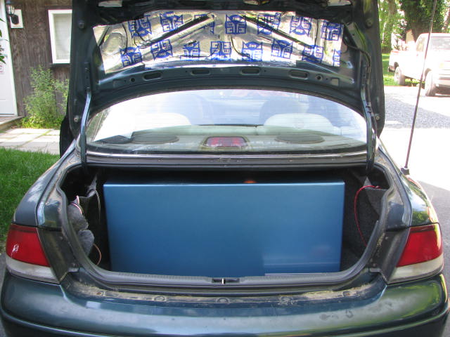

Then finaly got the box slid in the trunk. It barely squeezed in there and I buggered up the paint in a few places, oh well. It looks good though and now I just have to figure out where to install the amps. I may have to mount the MOJO on the back of the box because there is no room left. 4 cubes looks a lot bigger in the trunk than it did in the shop.

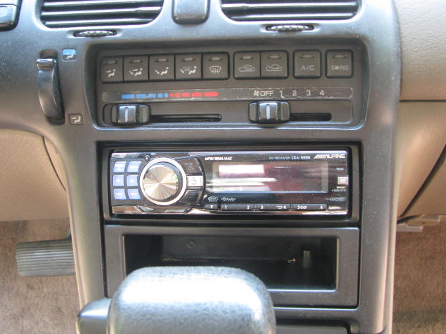

I think I can fit the Alpine on the left side. Need to do some more head scratching.

Man, that box and those front doors look fantastic!
