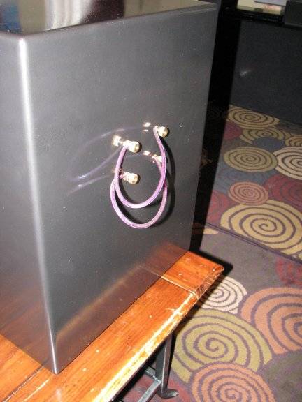

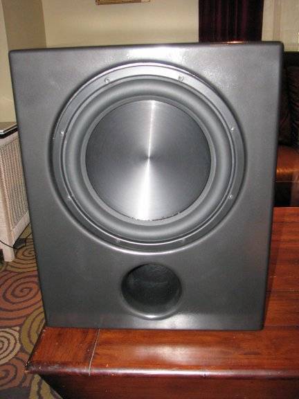

This is the sub I have pounding away all day in the shop. TC9 12", double walled 3/4" MDF and a 4" PVC port. Flared the inside and outside with a Corian roundover bit I use for easing the edges of sink bowls. A little hard to see in the pict. Its sprayed with the same hammer finishd paint I'm going to use on his box, just a different color.

Tc9 in the shop??? NICE

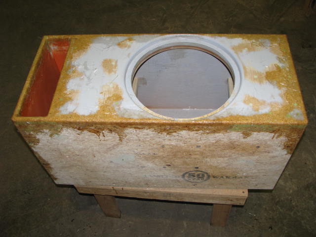

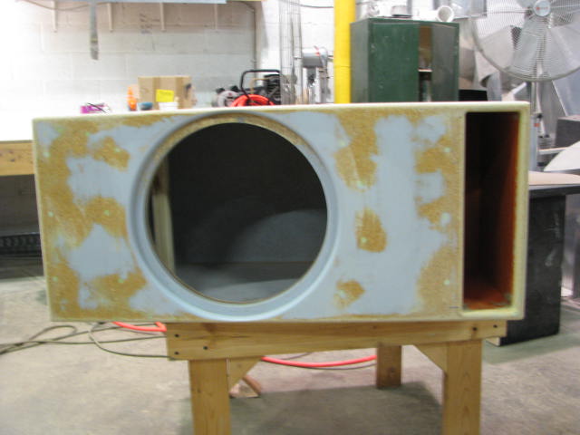

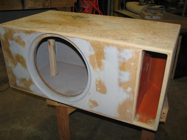

Had a good day today. Loooooong lunch and some decent progress.

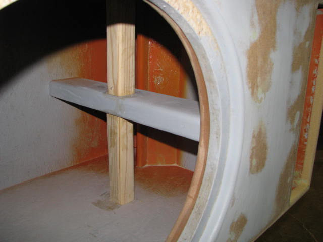

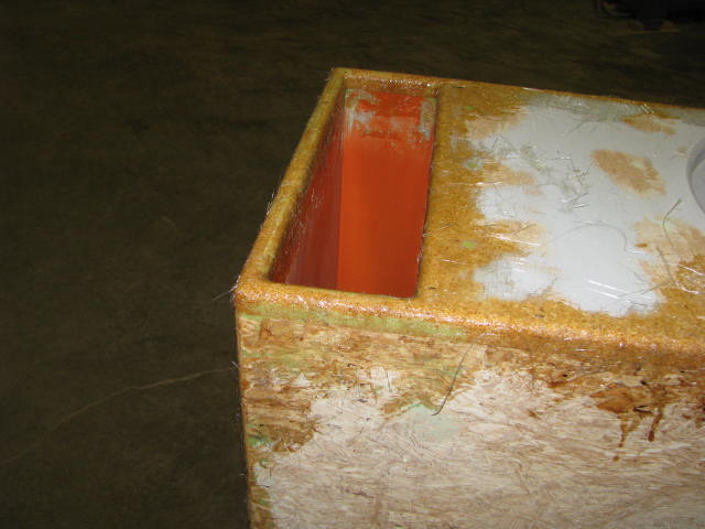

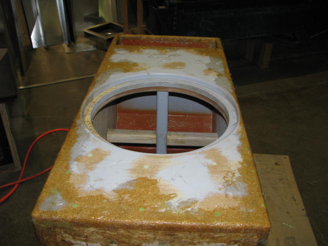

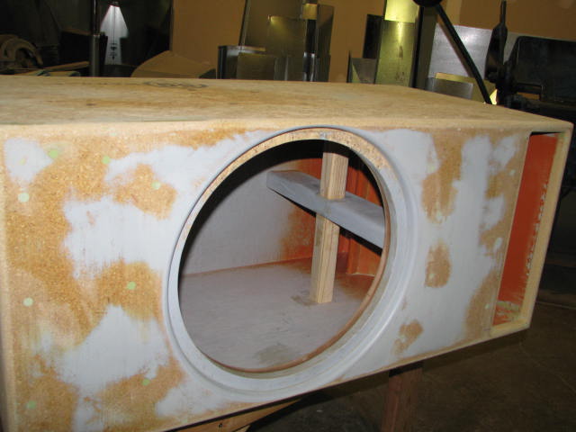

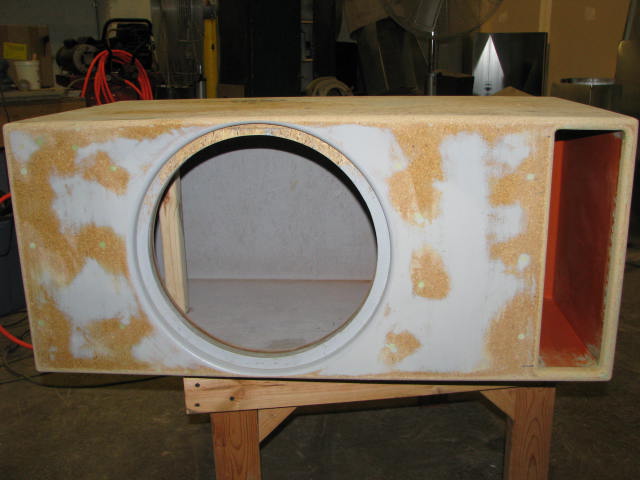

Glued, stapled and screwed the port in and also added the final bracing. Then glued, stapled and screwed the face on. Sanded the edged down even with the handy belt sander. Used a flush trim bit on the port opening and finally eased all the edges and the port opening with a 3/8" round over bit.

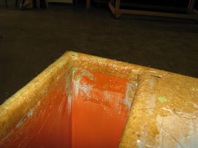

I also started glassing up the edges to seal up the endgrain of the plywood and particle board. Next is the body filler and sanding and more sanding. Hope to have it ready to prime by Thursday and maybe get the first coat of paint on it Friday or Saturday.

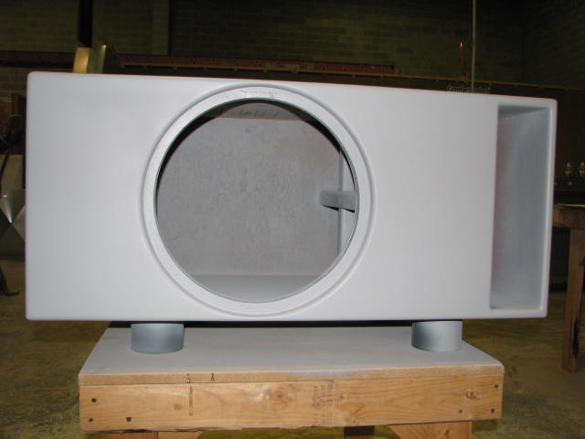

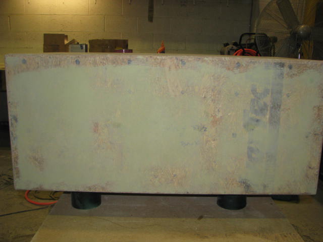

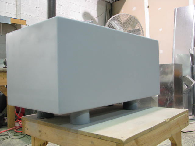

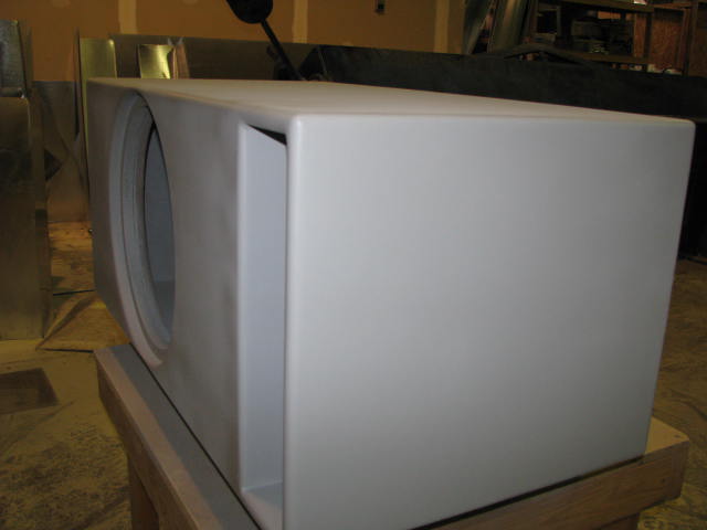

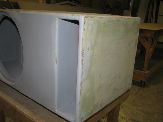

Getting closer. Have it all primed up and ready to sand. Need to hit a few spots with some spot filler before I paint it though. I wont be back in the shop until Tuesday to sand it and start on the finish paint. Touch the port up first, mask that off then paint the rest. Will probably wet sand that and finish it off with clear.
Here's pictures of it getting prepped and then finished priming.
Latex primer sucks BTW. I used automotive 2 part catalyzed primer on my last box and that stuff was excellent. Dried fast and hard and sanded easy. This primer will need the next 4 days to dry out and harden up. Will paint it with rattle cans but clear coat it with a 2 part system.
Primer on and drying.
