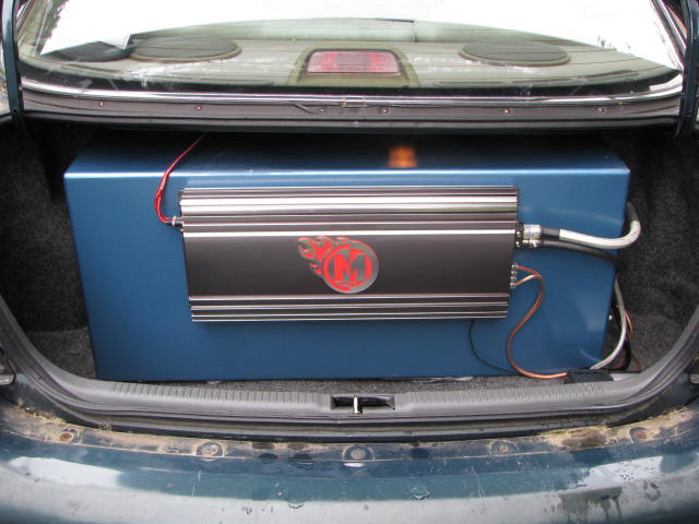

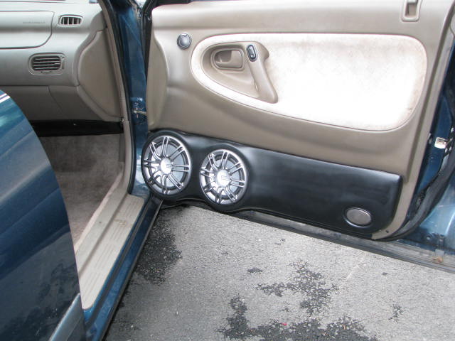

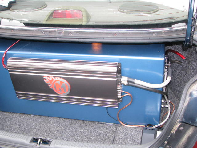

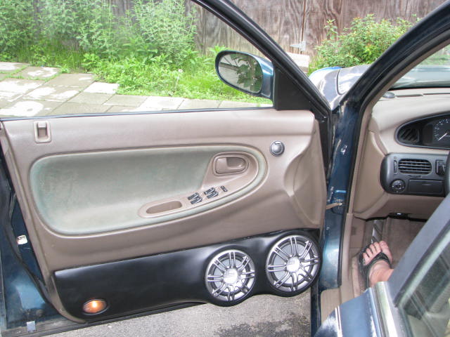

Heres picts of the finished doors and the trunk. Tried taking a video but the rechargeable batteries went dead //content.invisioncic.com/y282845/emoticons/rolleyes.gif.c1fef805e9d1464d377451cd5bc18bfb.gif Try again later.

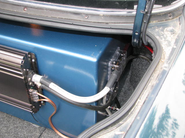

The trunk.

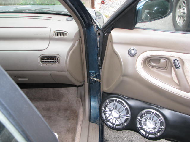

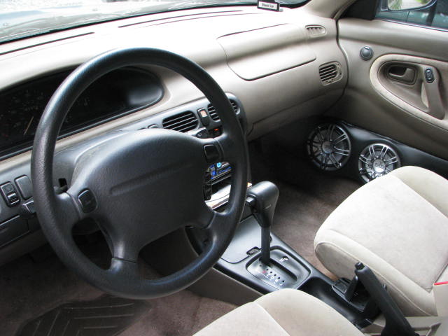

Heres the dash mounted tweeters and the doors. The drivers side door has the cloth taken off. Had a bunch of cigarette burns on it. We are recovering it later on.
The Mazda 626 has one of the the most bland looking interiors I've ever seen. The new head unit and those beautiful door pods really make the interior look as good as it sounds I'm sure. Almost makes me want to go try some pods for the 66' mustang. I can't put myself to try to make pods for a classic car though, especially not my first fiberglass try. I feel like I've watched it be done enough times, still haunts me though //content.invisioncic.com/y282845/emoticons/crap.gif.7f4dd41e3e9b23fbd170a1ee6f65cecc.gif I can't stand the single front mono speaker mounted in the dash though. That's right, MONO. Doesn't even have stereo sound output, just one ghey speaker. Oh well, should I decide to, that would make a cool build log, probably the first 60's muscle car on here to get glass kicks //content.invisioncic.com/y282845/emoticons/biggrin.gif.d71a5d36fcbab170f2364c9f2e3946cb.gif
Your right about the car, It drives well, actually very comfortable and has a smooth ride. It is a generic looking body and interior. The oscillating front a/c / heating vents crack me up. Next thing is a little body work and some paint. This Mazda has the problem with the f-ed up paint and clearcoat. Looks like someone poured paint remover all over it.

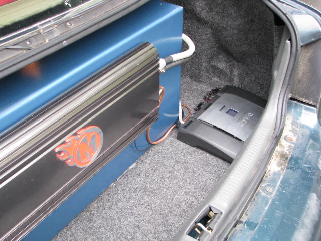

Im also going to mess around with an amp rack/mount for the alpine and tuck it away in the spot on the right side where its sitting. I just have it mounted there because it was easy and we were impatient.
Almost makes me want to go try some pods for the 66' mustang. I can't put myself to try to make pods for a classic car though, especially not my first fiberglass try. I feel like I've watched it be done enough times, still haunts me though I can't stand the single front mono speaker mounted in the dash though. That's right, MONO. Doesn't even have stereo sound output, just one ghey speaker. Oh well, should I decide to, that would make a cool build log, probably the first 60's muscle car on here to get glass kicks
Putting them in the kicks is probably the only place you could get away with pods in an old Mustang. Cutting into the doors just wouldnt be right in a classic like that. Kick pods can always be removed. Glassin is pretty simple but can be a bit pricey when you first start. Your probably looking at at least 100 dollars for the resin, matt, body filler, primer, spot putty and paint. If you try it just stay away from the fleece and get something like I used on these, I wrote about what I used somewhere in this build. Fleece takes a lot of resin to soak thru, 3-4 times as much as what I used. You could even do your buildup on the inside of the pods and make finishing the outside much easier. I had to glass the outside because of using the original siht holders that were on the doors. No way to glass inside the pods.
Great job! very impressive. I had a '93 mazda 626 in the same color and I put in an alpine deck, so those photos bring back a lot of memories. I had forgotten about the 'swing' feature on the a/c.
Looks good to me. I would consider relocating that amp though. If the box flexes, its going to cause the amp to flex with it and can cause the amp to break or rattle something loose.
