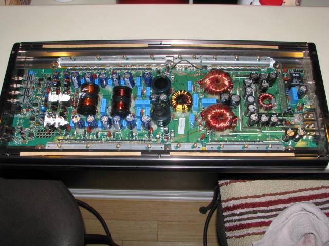

Were trying hard to do this and not **** his bank account dry. Im donating 2 sets of Polk DB components. One set of 6.75's and a set of 5.25's. Im also giving him my Alpine MRV-F345 to power the comps.

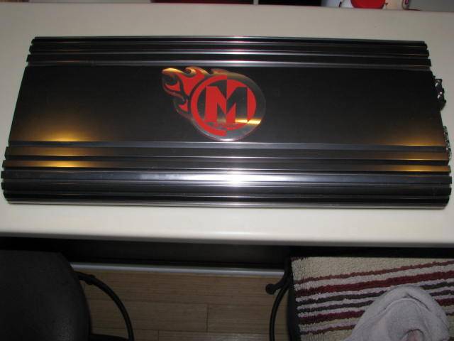

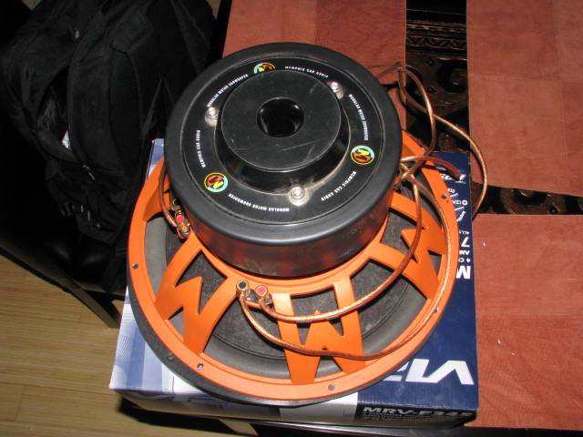

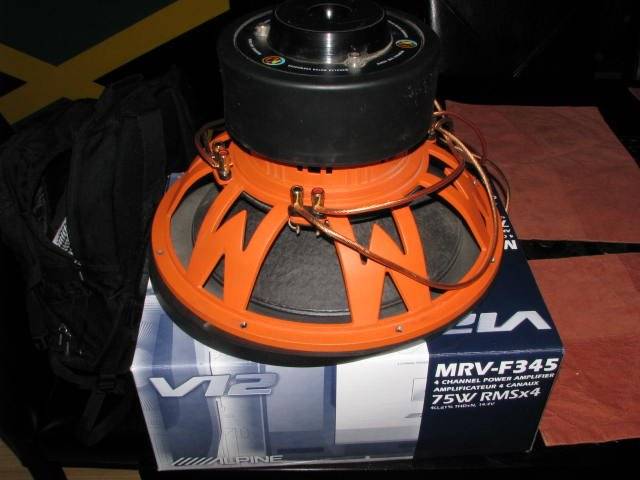

He traded his Wii some games and some other stuff for his Sub channel. The subs a Memphis 15" MOJO quad 1ohm coils. The amp is a Memphis Mojo 16-MC2000D. I wish it was 1ohm stable but he will have to due running it at 4ohm 1200 watts.

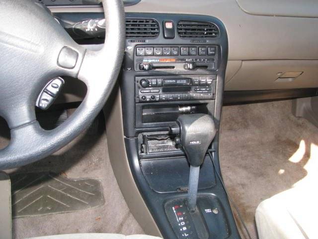

Were still looking at head units, no decision on what he wants yet. He's still trying to barter stuff for a good unit from a few of his friends. I might post an add to trade a bunch of my stuff to fund the unit and some install accessories he still needs.

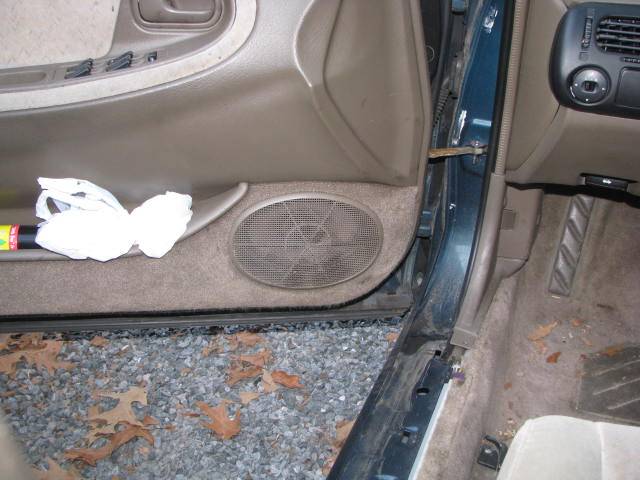

What I have to work with.
Interior

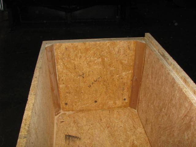

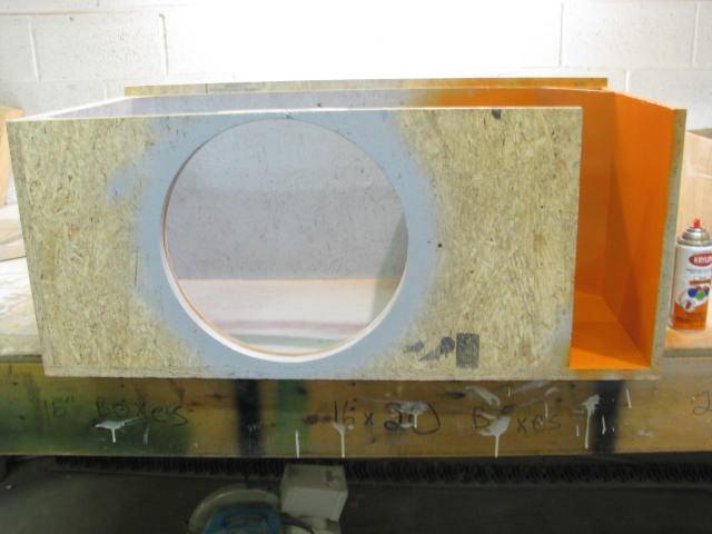

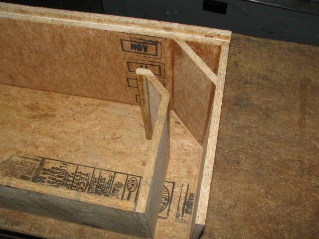

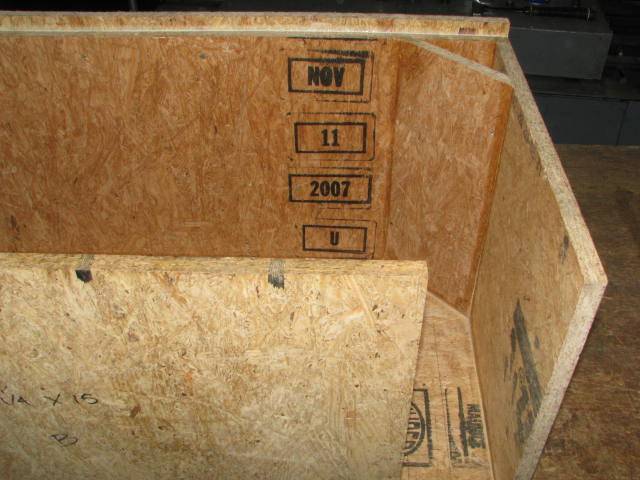

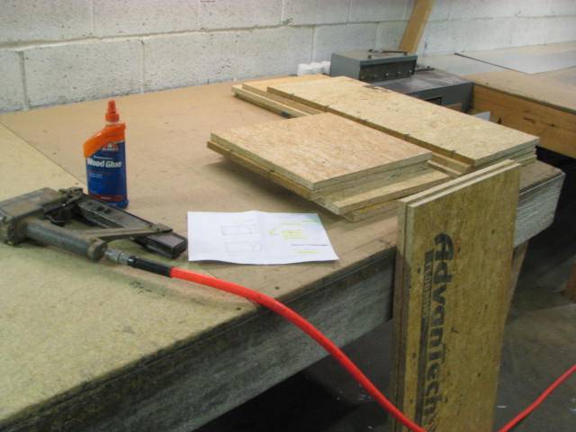

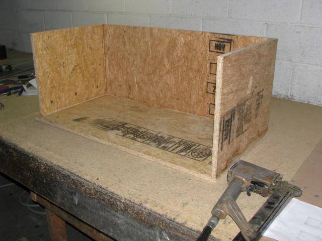

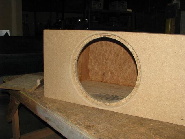

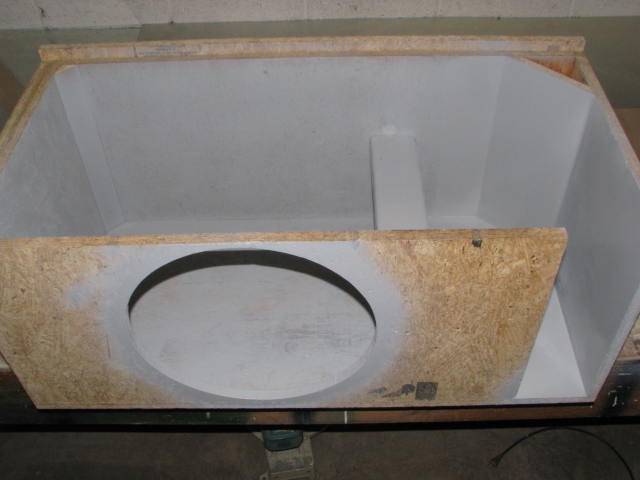

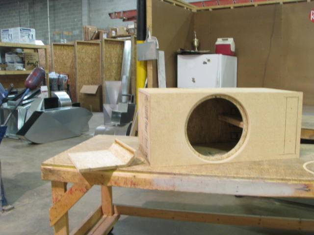

I have the sub enclosure on its way to being finished. 4 cubes, slot ported, tuned to 38hz. Memphis suggested tuning to 40-45hz but I went a little lower. Tomorrow im going to prime and paint the port pumpkin orange to match the subs color. Then finish gluing stapling and screwing the box together. Hopefully I will have it completed some time next week.

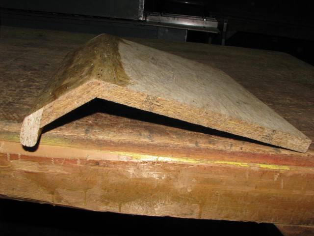

And yea, no MDF in this build. I had a bunch of Advantech OSB I scavenged from a job site, it was free, and thats what im using. Its actually hard as a rock and should work great.
Particle board for the face. Wanted something smoother to paint over and get a better finish.

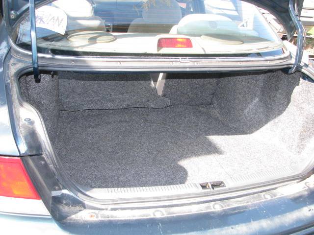

Now for the questions. Were going to start the Big 3 this weekend, that much I understand. I know im going to need to put a battery in the trunk to help keep this setup moving and thats new to me.
So far I have enough 1/0 power wire to make the run from the front to the back. Am I also supposed to put a fuse block close to the front battery, like im used to, as well as one before connecting the positive cable to the rear battery? Then also putting fuse blocks in the power runs from the rear battery to each amp. I was also wondering about the ground. Is it really worth the extra money to run a ground from the rear battery to the front battery instead of grounding somewhere in the rear to the frame? Im guessing that I should run the grounds from the amps to the negative terminal on the rear battery as well.

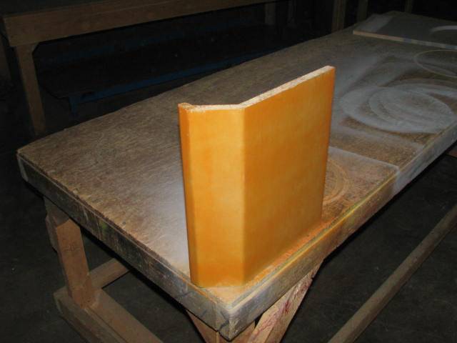

Just a little more progress. I got the port primed and painted. Will be ready to assemble on Monday when I get back to work. Then just need to attach the face and do some filling and smoothing before paint. It takes a little extra work laying body filler on the OSB to level the surface before painting. The rest of the box will be blue with a hammered finish and clear coated.

For your questions, your power wire is atleast 4 gauge correct? You only need a fuse on the main power wire preferably within 18" of the front battery, run it through grommets. As for the AMP ground, a clean bare spot on the body of the car is fine, no need at all to run it back to the front battery ground.
As for adding a second battery, thats hobwash, if you want to upgrade to more power down the road, then MAYBE. I wouldnt waste the money on buying another battery and the cables to run it. Ive run 2000rms off a factory battery alone, it can take it just fine. If you wanna be safe, pick up a Optima yellow top for underhood if his oem battery is old. You can even find them used for under $100
I honestly see no need at all for a rear battery for this setup though. ANy more specific questions feel free to pm me, im not much for coming back to the same threads lol
