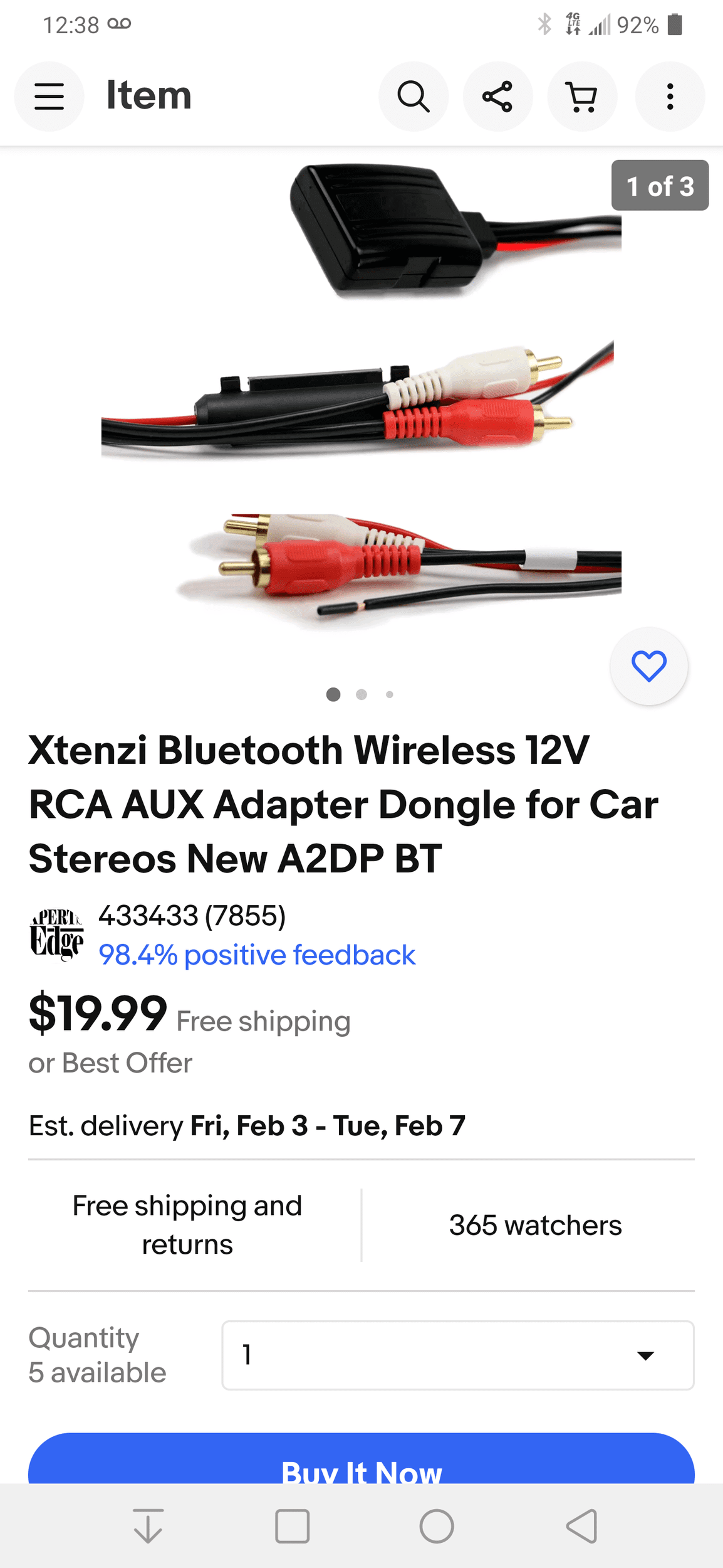

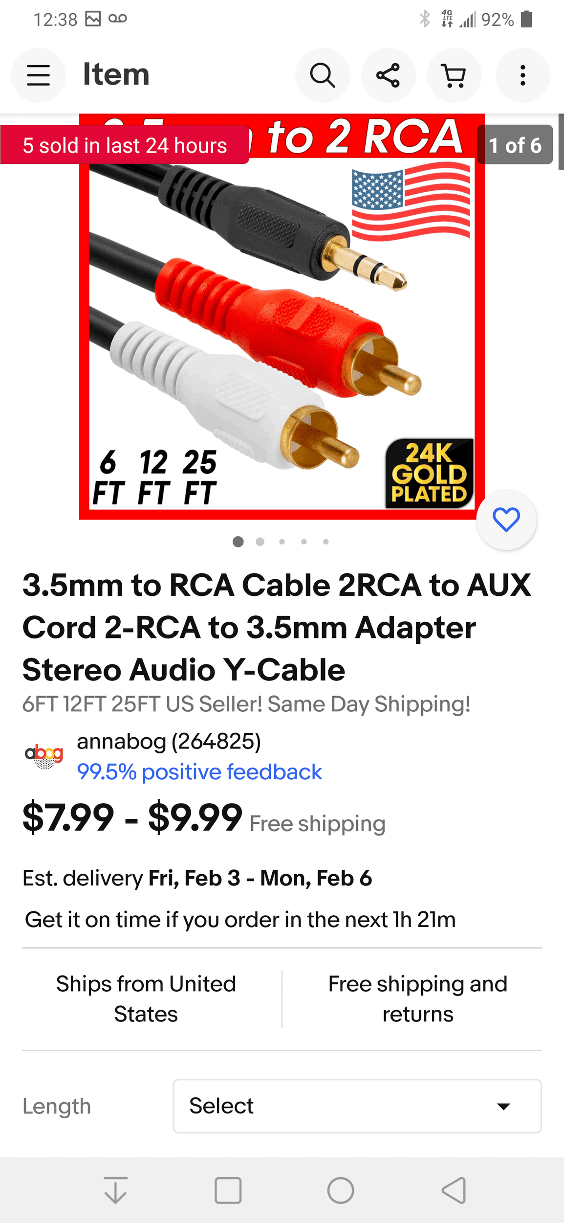

You could use a 3.5mm to RCA patch cable direct to the amps from your phone. If your phone lacks a headphone jack, you could also use a BT receiver/dongle.
