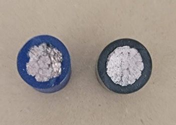

I got this 2/0 on amazon. It's excellent wire, tinned OFC, marine rated.
Red
Black
2/0 to 1/0 reducers

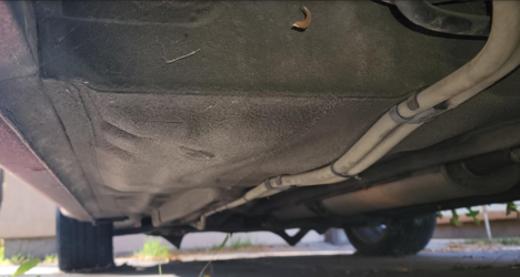

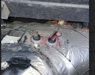

I use them strictly for the runs from the front AGM to the lithium bank in the rear. To the distro blocks, I'm using 1/0 gauge KnuKonceptz wire. I run them under the car from front to bac then out the spare tire well. Her are pics from the last build (after it was totaled and I clipped the sires out) stuffs to spendy to give to the salvage yard!
New build is a 4500 watt setup.
