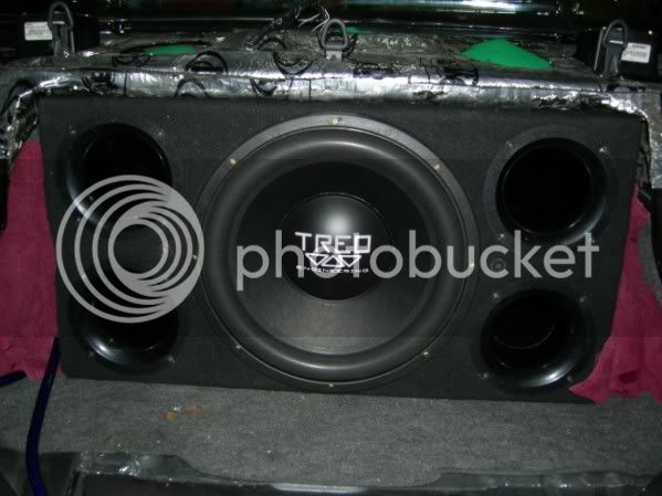

They sound ok if used above 40hz, then they don't have to be that loud but they take up a lot of space. The box above was just a trial and error box notice the towels and blankets used to seal off the trunk lOl. I have found the loudest to be port to driver side. Polo..
