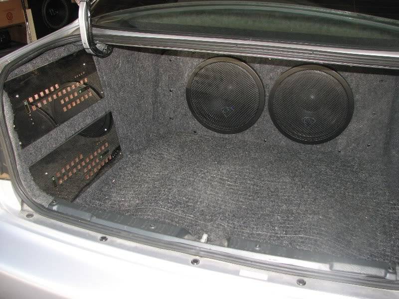

ported box sealed from trunk

sealed off prevents phase interference from sound bouncing around in the trunk and arriving later. the extra output some trunks get is from constructive interference at a few frequencies (usually in the 40-60Hz range). but that means you also have cancellation at other frequencies. it is somewhat vehicle dependent since it relates to geometry. and it depends on the enclosure as well. sound off the rear of the sub will reflect off the rear box wall and come back out the cone. this plagues all speaker systems. controlling it is hard. it's why i gain output by opening my trunk. i eliminate the destructive reflections that come back through my woofer cones.
i have a few questions.
1.) how does forward firing sealed from the trunk help with sq? cleaner sound less rattle from other crap. smoother
2.) what is usually the best tuning for a smooth roll off? or is this pure car dependant? if so im going to decide this for myself.
3.) what do you guys use to seal the box from the trunk? great stuff in a black can
4.) is there anyway i can seal off the box from the trunk and still be able to use my back seats? no
