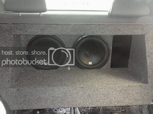

Depends on the car I guess......This is my forward facing setup........It does a 147.5 @ 37 hz with my back seat in and sound only coming through center armrest....Mine is tuned to 36 and it plays music very well.....two AA Havoc 12s and a DC 3.5k wired @ 1/2 ohms nominal....//content.invisioncic.com/y282845/emoticons/smile.gif.1ebc41e1811405b213edfc4622c41e27.gif.........Oh and my car has ZERO RATTLES......
Wow man that looks beautiful. Great work
