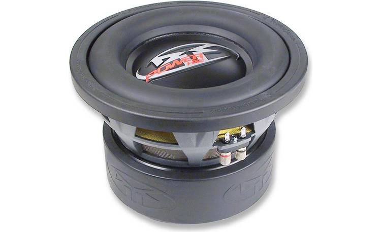

Nothing is lacking as of yet. Getting ready to install and wanted to make sure I had everything lined out for a smooth install. Was just wanting to hear from those more experienced than myself if I had made a small or big mistake. The sub is an American Bass 10" sub, cant remember the model number, it's nothing special. I have a RF 3110 waiting for repair, that's the main sub I want to use. The build is going in a 2 door wrangler with a hardtop, I figured a 10 should hit pretty good in that small of a chamber. But like all things I will want more eventually lol, just like last time back in 1999. Then I started with one 12 and ended up with 4 after everything was said and done lol. Appreciate the reply.

What sub are we talking about after all? Some NEED more airspace and power so it may need rethinking.
I have one of these left as well, but I need to get a new coil installed in it. Was going to use PSI but they are not taking new stuff right now.

I for got to ad that the box is tuned to 38hz, I want to get low but not windmill low. I still want to keep decent hit in my songs. And sorry for not answering you eelier on what I'm going for. I just want a good full musical experience, but also want to be able to shake the mirror a bit some days. I'm 42 and used to mess around with small town comps. Had 4 12's and finished back in 2002 with 4 RF 3310's pushed by 2 PP1000's. Had all MB Quartz mids and highs. It did sound really good. But I'm just looking to stay low key for now.
