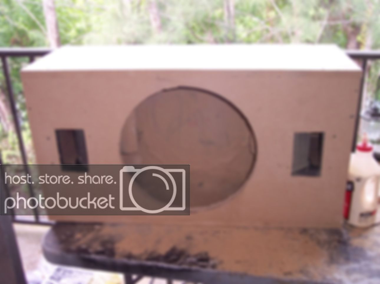

well guys, i'm sad to say, but all good things must come to an end, here are the final build pictures.
i'mleaving the box ***** for the end client to paint/carpet/have *** with until his hearts content.
here are the final shots of what is now the best box ever.....
made by me.
*** shot

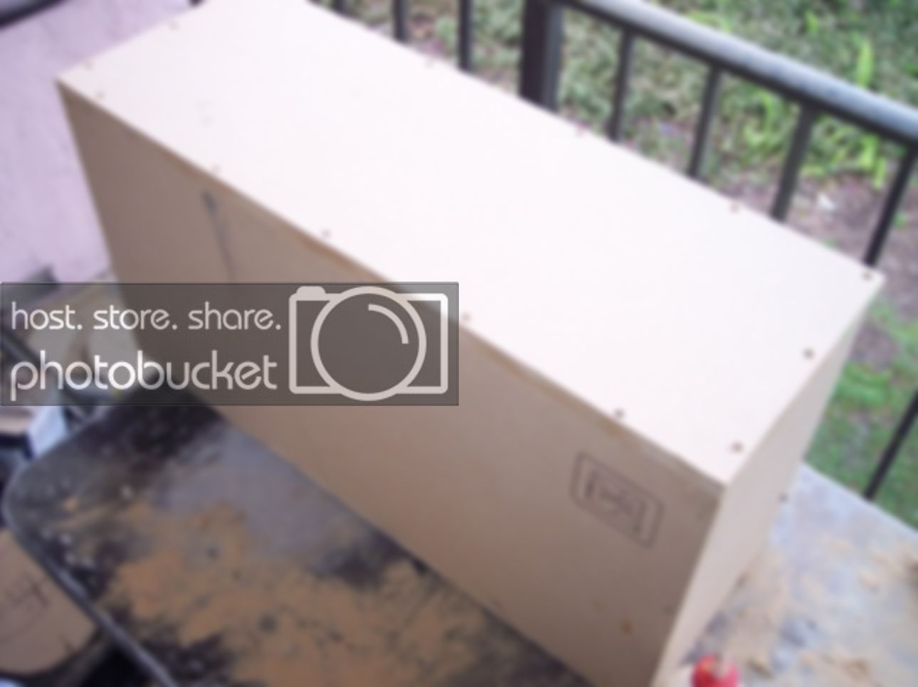

180 to the front side.
going to vaccum the saw dust out, but that's it.

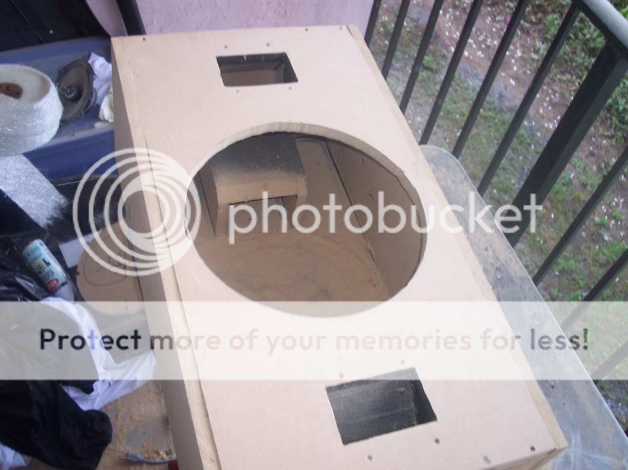

and an almost-inside shot to show how the ports turned out, in the end.

and to the top.

i didn't notice it until i took the pic.. it's just the way the marker looks on the wood with the pic, it's actually a pretty clean cut, nice and round.
sawdust keeps the box good, didn't you know?
i gotta wait until tommarow to get the shop vac, i dont own one, i mean you saw the pics of the floor of my 'shop' gonna buy it tommarow i think
ever thought of cleaning up the circle? looks like ***

about cleaning the box
i gotta wait until tommarow to get the shop vac, i dont own one, i mean you saw the pics of the floor of my 'shop' if i drop a drill bit now i just get another one, i cant find shit theres soo much saw dust, i've built 6 boxes and haven't cleaned yet. gonna buy it tommarow i think

anyway, i like the box, but the lines need to be cleaned up. they are screaming: "ORBITAL SANDER!!! SAVE US!!!"
otherwise, invest in a router cause the circle isn't ideal. the other reason why is because if the circle isn't cut on an axis (jasper jig, circle jigs etc) you don't know whether or not the driver will fit into the hole. chances are good that it will, but you never know unless you have it. also, i don't like the port configuration, it would have been just as good if not better (less chance for turbulence from those ridiculous edges) with just a regular slot or circular port. but not bad overall and this is just my opinion //content.invisioncic.com/y282845/emoticons/smile.gif.1ebc41e1811405b213edfc4622c41e27.gif
it tested well, no port noise, i was kind of worried about it, the woofer will fit, i measured it all around it's .034 inches over the woofer size, so it'll be snug like it should the pictures dont show how nice the circles are.. on one port it's a bit jagged, but i've block sanded it since then. i have a roto-zip.. i dont think i need a router the roto-zip is a beast, i bought a jasper jig but it doesn't work properly, i'm going to make one when i get some time for each size woofer.
