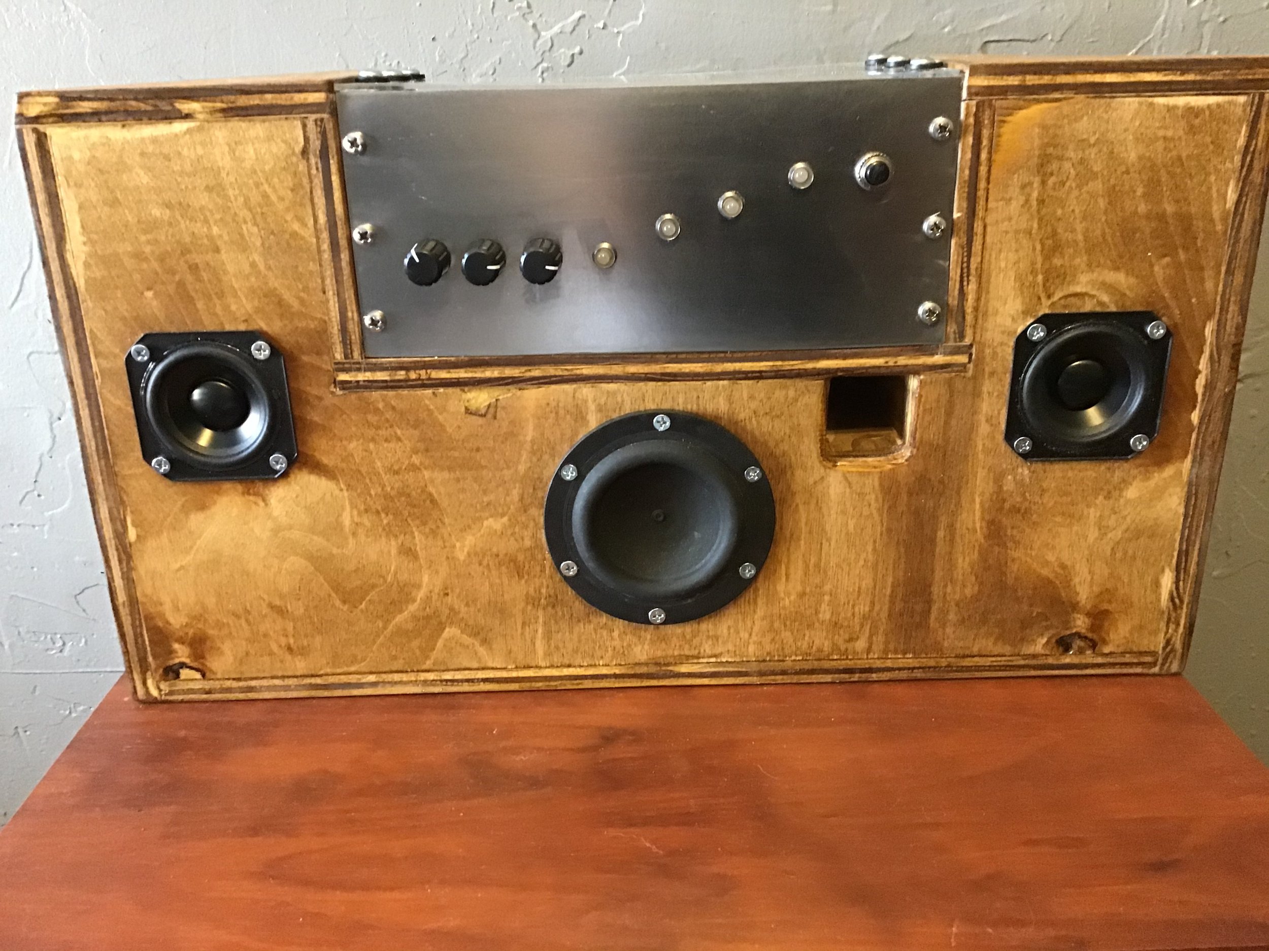

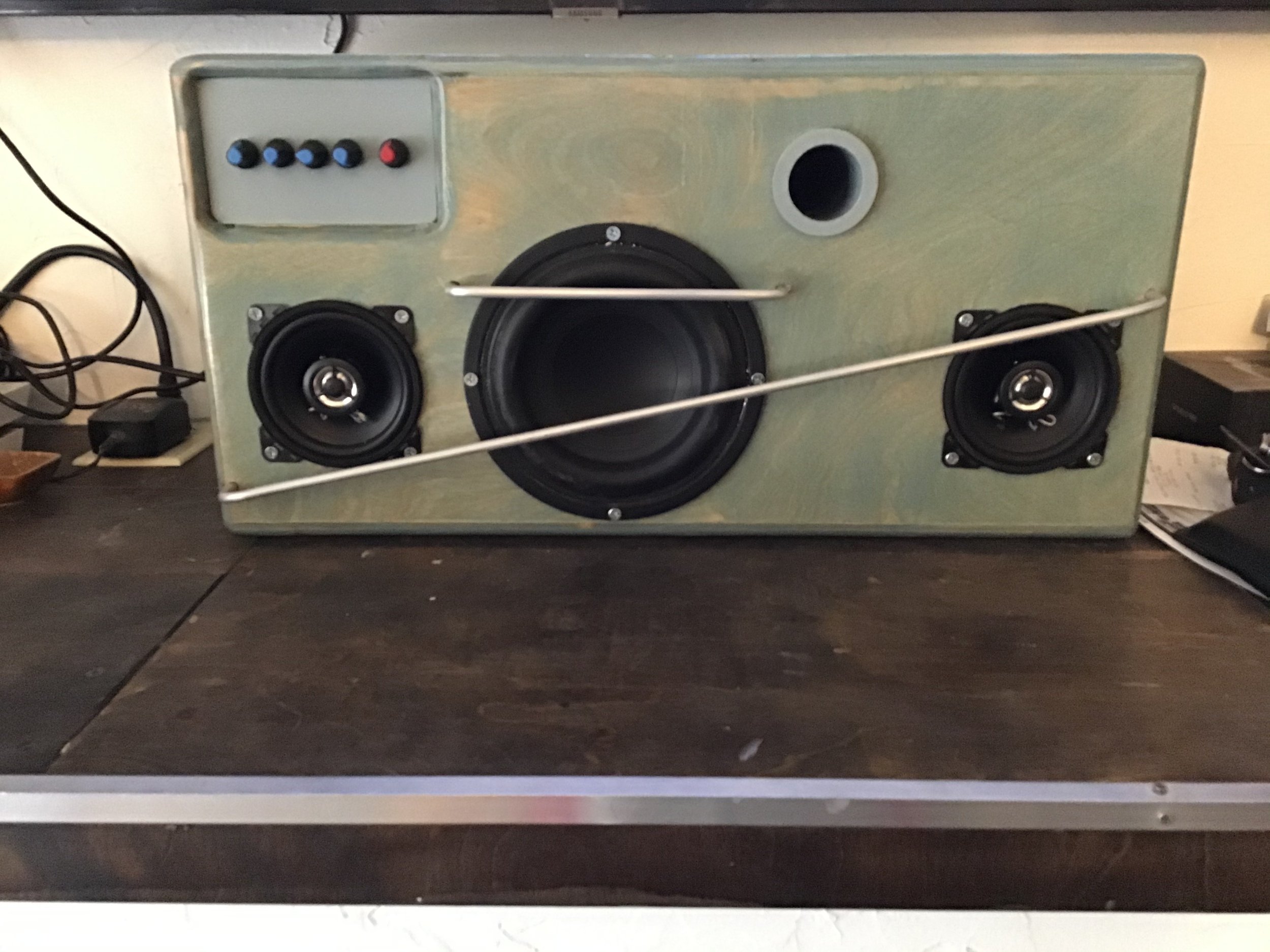

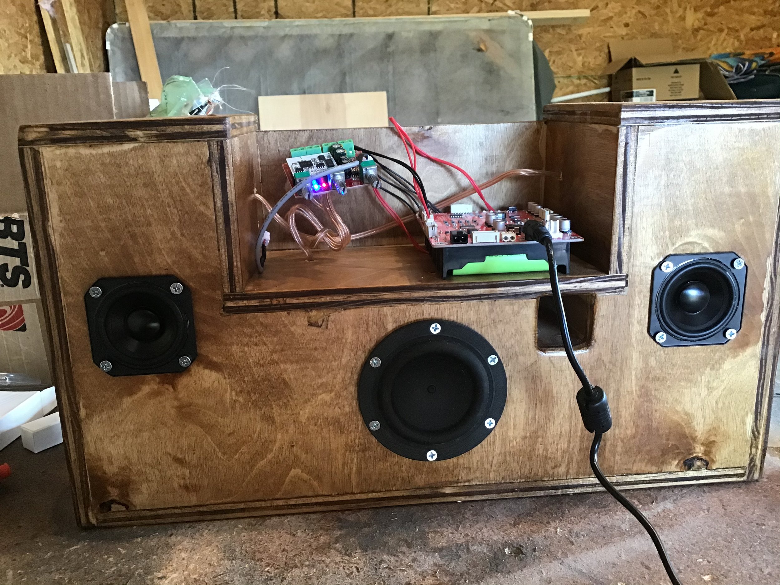

I make my own Bluetooth speakers. Sold a few to family and friends, but making it portable only works up to a certain power level and still be considered portable. Largest power ive done on batteries is 100 watts rms, which has around an 8 hour run time. I used five 18650 lithium batteries at 21 volts to run the amplifier module. I’m working on doing one closer to 200 watts rms now, but I haven’t ordered all the parts yet. Built in charging without removing the batteries is one of the biggest challenges. I could simply hook 10 18650 lithium’s to do it, but I don’t want to need an external charger and remove the batteries all the time. Power is always the challenge with audio of all types.
This one is my portable shop radio. 100 rms. 50 watts to the sub and 25 watts to each satellite speaker.
This one is only 60 watts rms total.

I can turn it on in my shop and hear it around my whole yard while I work outside. It’s pretty damn loud. Probably can’t hear it football fields away, but it’s audible from a few hundred feet away. It would get a lot louder if I went with all 100 watts into just the speakers without the subwoofer, but it would not have a full sound. Speakers with a high sensitivity rating will get louder on lower power, so look for sensitivity ratings in the 90+ dB range for sure. Car speakers work very well for this. If you want it super loud without much bass, you could do just speakers without a subwoofer. Running a subwoofer is power hungry.

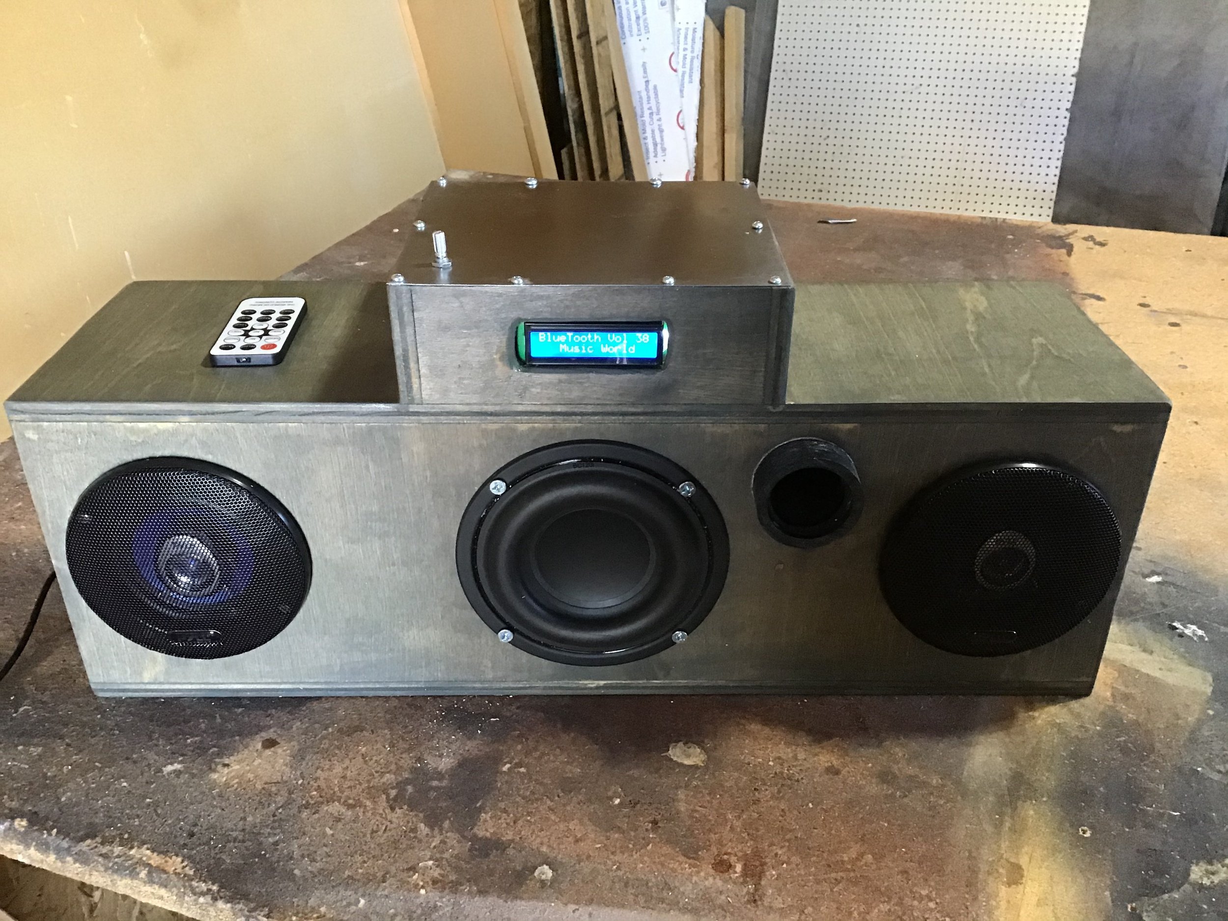

The first one I posted has some cheap Pyle 4 inch speakers that have a high sensitivity and actually get very loud. Too loud for the sub actually, so I have them turned down to match the subwoofers output. This bigger one that I have isn’t portable because it just sits in my workout room so I didn’t put in batteries, but it has a pair of visaton speakers with a lower sensitivity. They sound much better, but aren’t quite as loud. All of these are pretty damn loud. I’ve never actually turned them up to their max volume.
