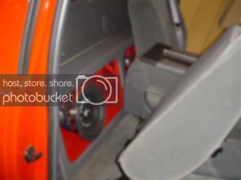

fords tend to have more room behind the seats than chevy's. I currently have a 13H x 42W x 8D and the box moves forwards and backwards because there is room between the seat and back of truck. Im 5'11" so not short.
Back on topic. I have done subs forward port forward and subs up port forward. I did cram a box behind the seat for a few days that had port and subs up. Personally I liked the subs up and port forward. Ive had the port in the middle and off the side. Cant really give an opinion on differences because one was made for sq and the other for spl. the spl one had the port on the side.
wow thats a sexy box
