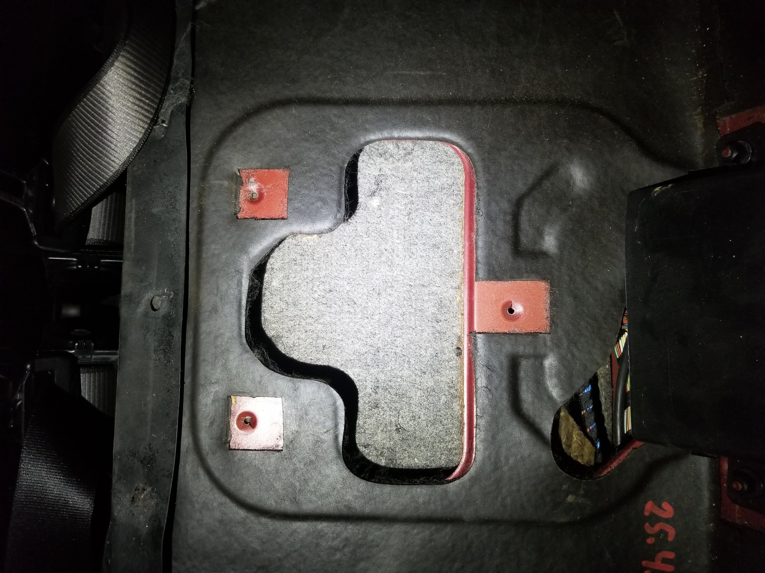

The issue I have with mounting the sub is that my car doesn't have a large pass through between the rear seats where'd I'd want to put the sub (picture attached). Could I mount the sub on one side, and the box on the other, as long as both sides are sealed at the hole? Is having a divider like that in the middle of the box going to cause issues? On the sub side, there'd be just enough of the box to get a good seal, and mount the sub, and the remaining volume would be on the other side of the divide in the trunk. I've read a small bit about "free air" sub setups, but I'd like an enclosure if possible.
