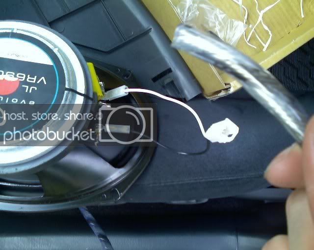

Just hooked up my new speakers in the back, tested them, work great (on headunit power that is)
Before I put the rear deck seat assembly back on, I have a question..
Because I have RCA cables...does that mean I don't have to run wire to the speakers themselves?

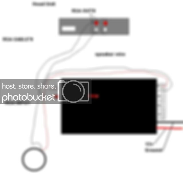

no bro the rca's send the signal from the head unit to the amp. the amp then sends through the terminals in the form of watt's to each speaker through speaker wire. put it this way look at the speaker. can you hook a rca to it? didnt think so

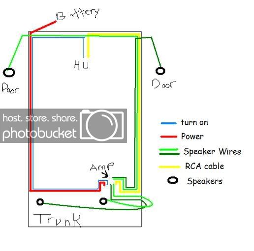

Right now the speakers are connected to the wire in the car, do I disconnect that and connect it to the amp instead of the car? Or do I connect it to both the car and the amp?
ok bro here here ima do a quick picture for you of what and how to hook it all up k. h.o. a sec.
ok bro check this out. i drew up a little sketch. Shows you what you need to do.
you will c i was lazy and only put one speaker. just wire the remaining three speakers the same way. positive to positive negative to negative.
So far I have the fuse holder set up, power wire going from the battery to the trunk, along with the remote turn on wire, RCA cables going from the trunk to the headunit (running on opposite side of power wire), and a speaker wire going from the trunk to the front left door (not in the door yet)

am i doing everything right so far?
Is this setup correct?
Looks good so far. Some people would run the speaker wires up the middle of the car to reduce the amount of wire you would have to run. They are usually the smallest wires to, so they are easy to hide under the carpet.

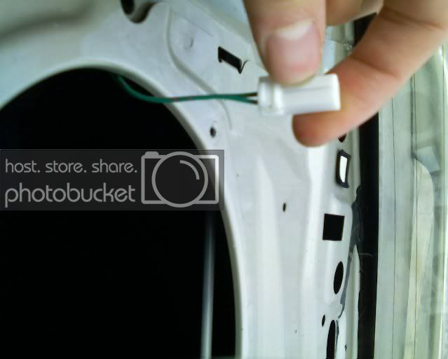

This is the speaker hole, with the stock speaker wire there

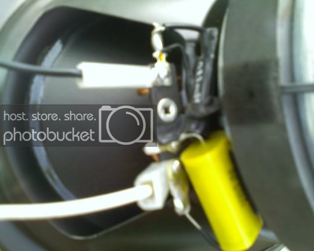

This is the speaker
Speaker + new speaker wire ??
Do I take the harness off (that connects the speaker to the stock speaker wires), and cut off the jacket to the new speaker wire and connect it to the speaker?
, then the speakers wont be able to connect to the stock speaker wire, but thats correct right?
