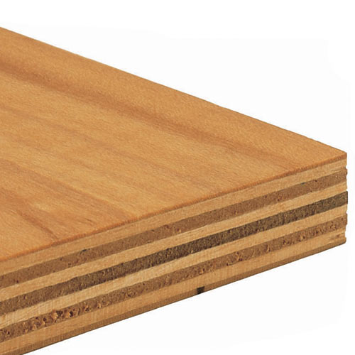

where did you get it as no mdf ive ever worked with has ever crumbled while i was doing anything to it... if you dont mind spending $60+ a sheet baltic birch ply is the sexiness
baltic birch ply ^
Well, trying to jigsaw the stuff, it just crumbles apart at the edges, and I'm a freak about clean edges. Plus, drilling through it, when the bit or screw comes out the other side, it bulges then breaks chunks away...and it is HD stuff.
I vaguely remembering seeing a thick 5 ply sheet of plywood for roughly 25$ Atleast i think it was 5 ply, either way, the stuff was insanely ridgid. I guess I need to figure out density though.

3/4 mdf. It is the best balance of weight, price, structural integrity, and acoustics. There is really no need for anything else in a car.
You can use 5/8 in a pinch.
unless you are running a stupid pair of 15"s or something, then 1" for the front baffle.
