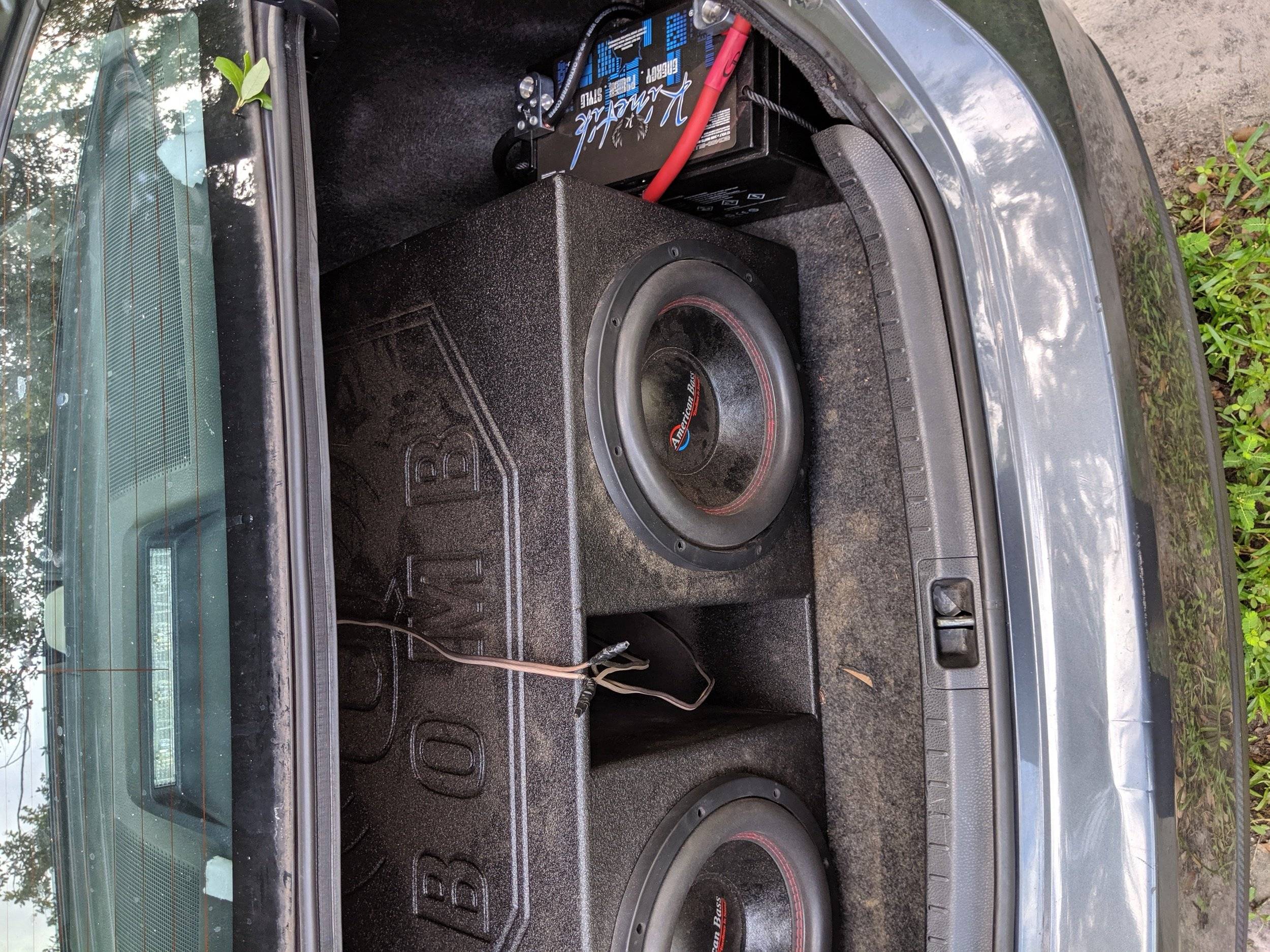

I have the taramps bass 5k on a 100amp alternator and a Northstar agm under the hood with a kinetik Blu 2400 in the trunk (that's the same size as those xs batteries)
18518
One extra battery not 4

I finished 5k rms build and I have a 100amp alternator with only one extra battery
