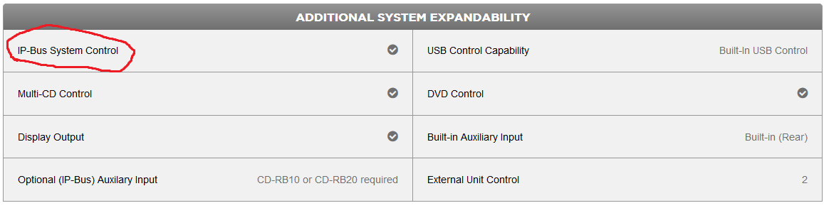

This is what you're looking for in the specs.
Thanks for the reply and info. Friend who is a professional retailer/installer, brought up the same discussion. The older UB unit also had the IP-Bus Control where as the BHS does not. My old wired remote had a lcd display and his thoughts were that the newer head units can not work with the display remotes, but should with the non-display remotes. I found a good buy on a ME300 remote last night and ordered it. Once I get it and test it out I will post my results. If this is not a working combination, I will have a new/used head unit, and a couple remotes for sale. I will replace all with a different system that has a wired remote. I have a 2" hole in my side dash that needs to be filled. LOL.

All good, for what it's worth digging through what those letters mean and what differentiates their models is a exercise in futility, especially because UB is a car-oriented designation in lower numbers and as you say it used to work with that. My old car had a 4000 something UB and definitely didn't have an IP-Bus control. Pioneer really needs to consider using product model numbers that are descriptive. Good luck on compatibility, very limited information out there for that remote too.
