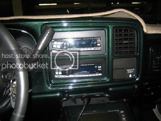

I keep having people try to buy the face of my H700 from me. I am currently controlling mine through my touch screen, but I'm thinking about running the wire for the control face so it's a bit easier to tune with. The H700 and H701 are the same except for the color of the display. I think you also have to buy the H701 and control face seperately. I could be mistaken though.

yea on the h701 th controller is separate.

1) When using the 9860/9861/or higher you only need 1 din opening (unless you intentionally purchase the double-din W200) since those units fully control the H700/H701
2) The DEQ-P9 can only be used with the P9 headunit. The H701/H700 can be used with any headunit and therefore implimented into any system. This is the only time you would need to use the C701 controller and take up 2 din slots (but, ofcourse, the C701 is only really needed for tuning and volume control when running digital...so if you are running analog you do not need to permanently mount the C701 once you have the H701 set to your liking)
