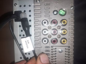

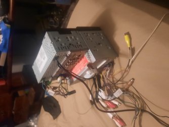

So i won both of these head units in a raffle for very cheap. Im running a cheaper single din kenwood with 2.5 v preouts right now. I decided im switching to a double din mainly for the back up camera (Bpillar Wall) and the ability to get a more in debth EQ . Both just have 2v per outs. The pioneer is a little more expensive but has the usb in the back so i would have to pull my headunit to change it. The kenwoods sub output is wierd and only has one rca output(how do i even hook my amps rcas to this?). Anyone have any experience sith these headunits? Im leaning torwards the pioneer...

Sub output is summed on the Kenwood so if you use it you can split it at the off the HU to you L/R out to the sub if you already have a L/R rca going to it. This is a decent one that is twisted pair and shielded.

USB on the back is a little cleaner, just get a cord and route where you want it. Could be up in the console, or glove box to hide it, could get a mount and route it to a automatic phone cradle/charger/holder to where it's visible.

The USB input is easy enough to run an extension cable to, and a y splitter for the subwoofer RCA output like shown above. So I don't see an issue there for either, at least to me.
I would definitely go with the Pioneer. More features, more add on options, and 6-preouts. 2v can be bumped up with a line-driver. As mentioned, a USB extension can be purchased pretty cheap. I believe they come with one.
