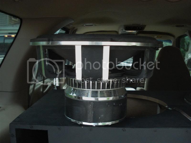

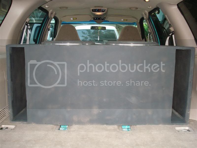

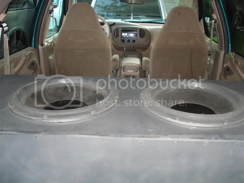

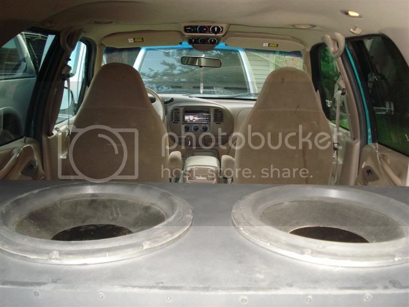

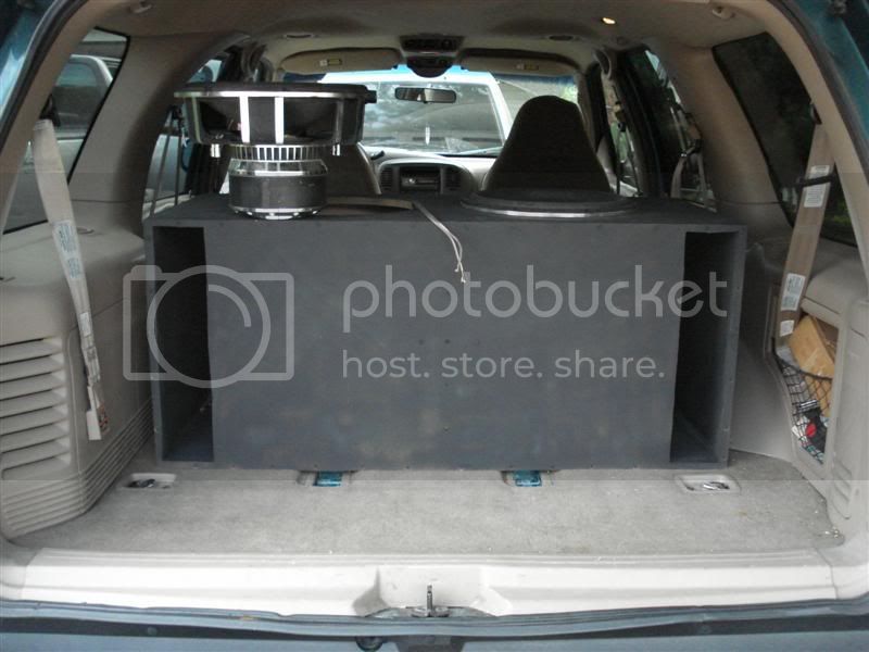

Alright guys.. got pics for you all..
Looks good enough for me, is ridiculously loud and in about 2 hours ill be down running it to see what is hitting.. Ill let you guys know..
